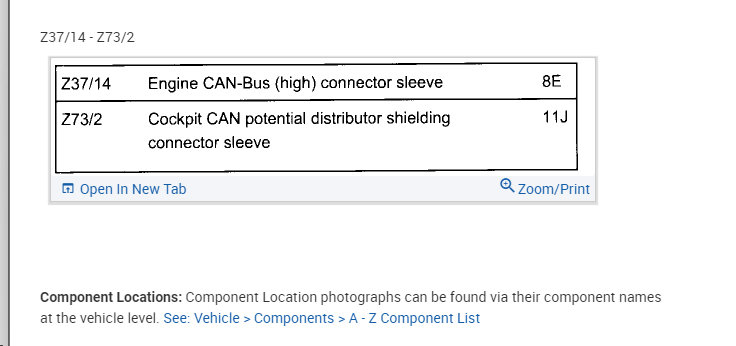

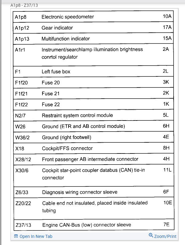

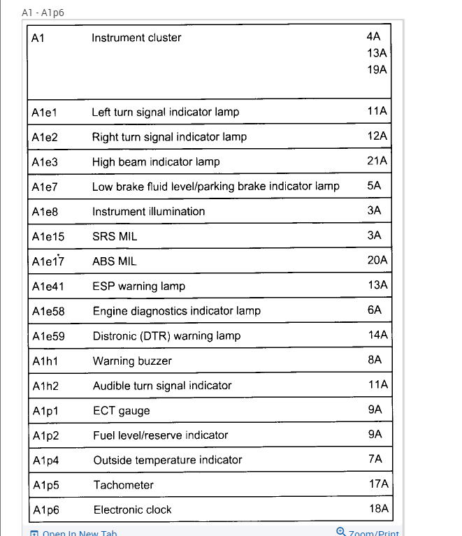

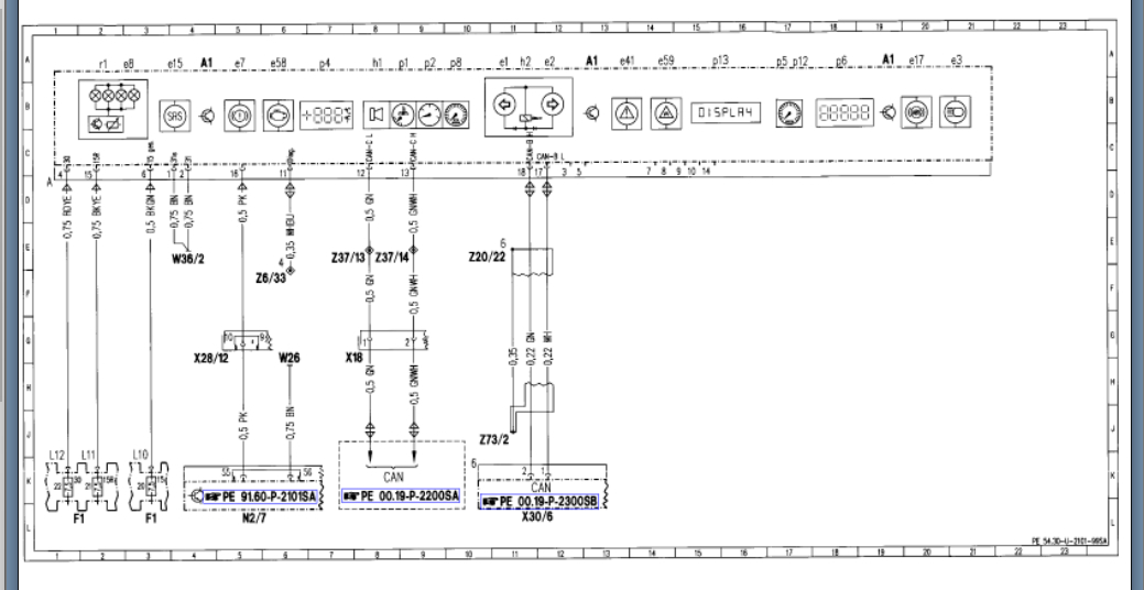

I am attaching the wiring diagrams below which will help with this.

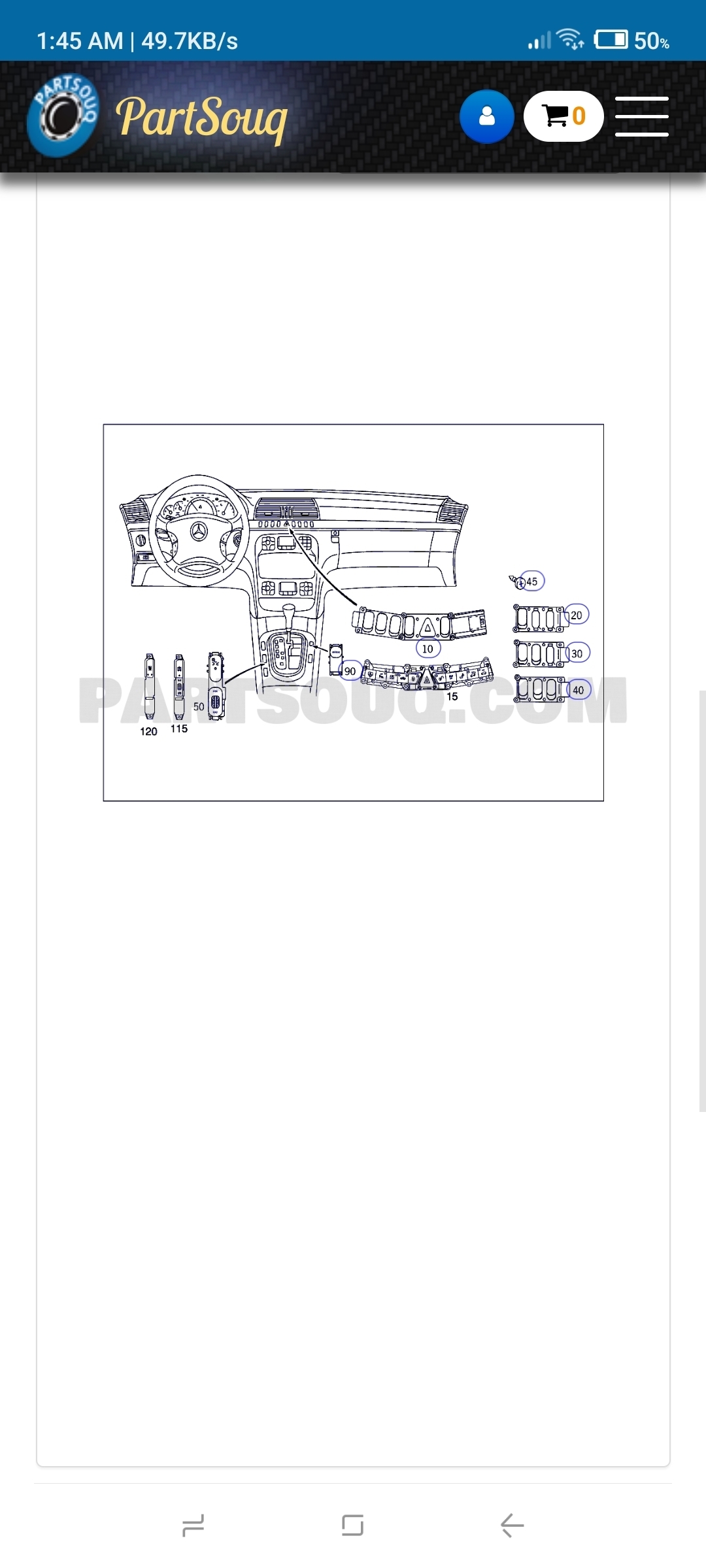

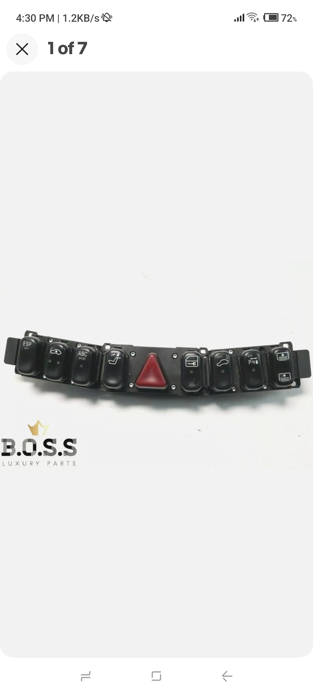

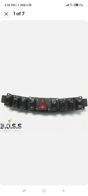

Thanks for the reply, actually there are no codes at all, I checked with star scanner for Mercedes but no result, everything is working fine the only issue is with the switches not working, please see the picture attached, also for information all fuses been checked nothing wrong and also i have changed the three SAMs still the issue is same.
Today i will replace the switches and see what happens.

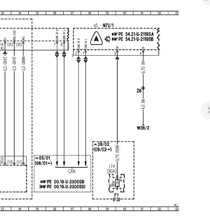

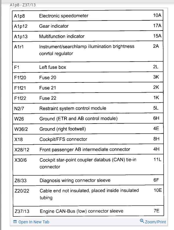

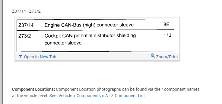

I am attaching a diagram on just the hazard switch as they do not have a diagram for the entire switch bank. However, we need to pull it out and check for power at in 3 and ground at pin 4.
If you have both of these then we need to turn the ignition on and check the power on both pins 1 and 2.
Let's start with this and see what we have, and we can go from there.

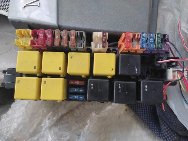

Today afternoon I managed to replace the relays in left driver fuse box so I started with the black ones, I replaced the four of them as you can see in the picture and switched on the ignition but not the engine and checked the switches found all works as it should be, now everything is fine and works perfectly and I am happy now with this big dog.

May 29, 2022 at 9:48 AM
That is great news. Thank you for updating us. I am sure we would have gotten to that by checking the power but the fact that you were able to jump to it and solve this really saved some time.
Thanks for letting us know this. That will really help others in the future.
