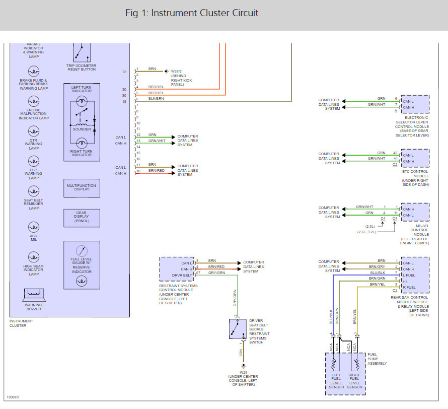

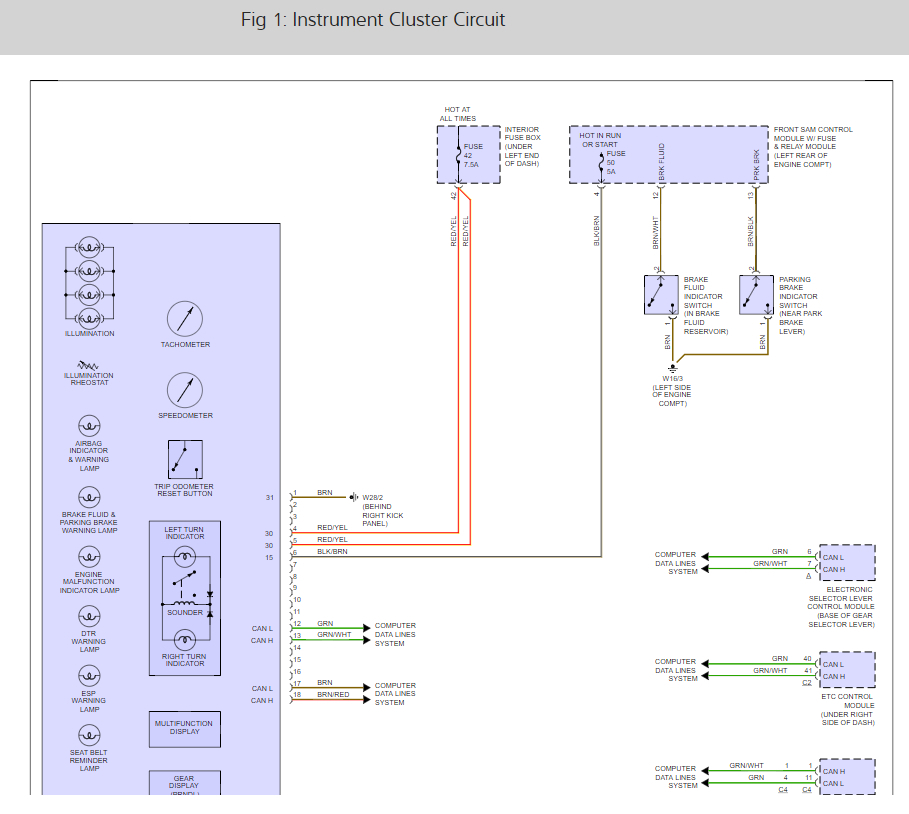

It sounds like you have a fuse out. here is a guide to show you how to check the fuses and a wiring diagrams to help you see how the system works. Check fuse #42
Check out the diagrams (below).

Thanks for the reply fortunately the problem has resolved itself but I was interested to to find if removing fuse 42 would give me the same symptoms and it did.
The fuse was not blown, so am now thinking the problem may return and it maybe a wiring issue. any ideas on the color or where it may run?

If the problem does return check the power and grounds for the cluster and if they work the cluster is bad and needs to be replaced.
