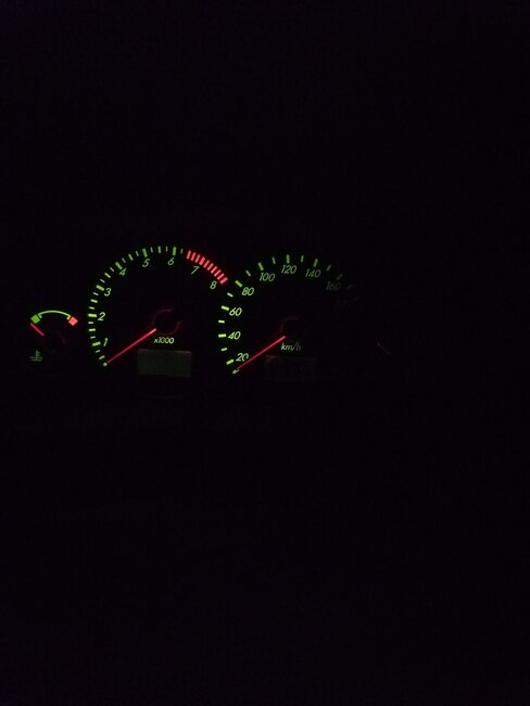

Dears, last night one (or maybe more) of the back lighting bulbs of my instrument panel probably blew up and now the fuel gauge is totally dark. Not a problem that you can't live with but also not something that is for normal usage.

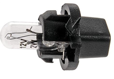

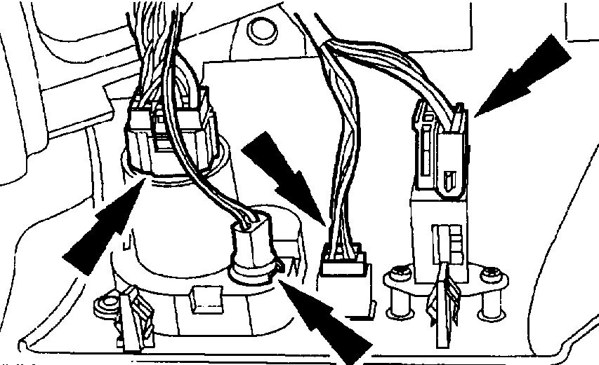

This goes with the attached images as the process. The bulbs used are a socketed type that twist in. Ford number F8RZ13B765BA and it uses 5.

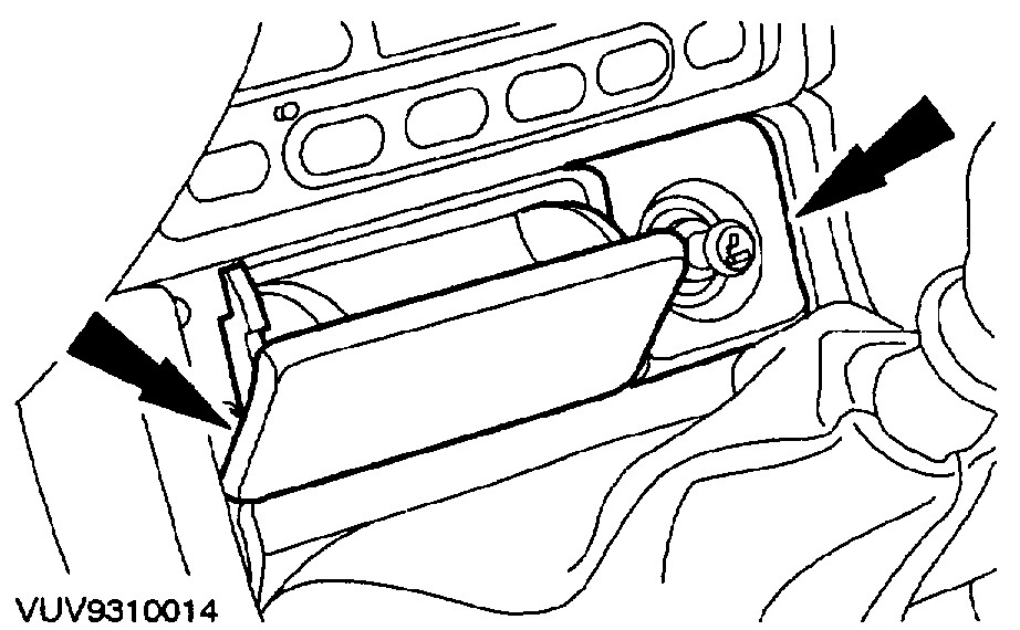

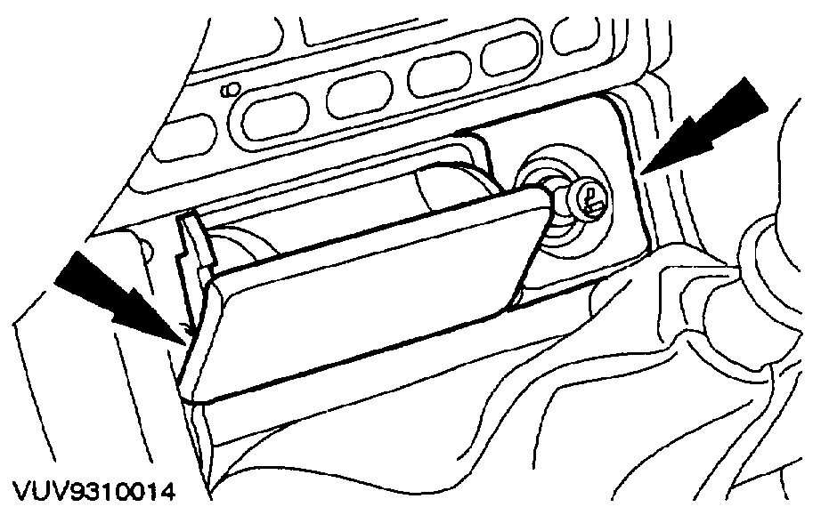

1. Remove the ashtray and cigar lighter bezel.

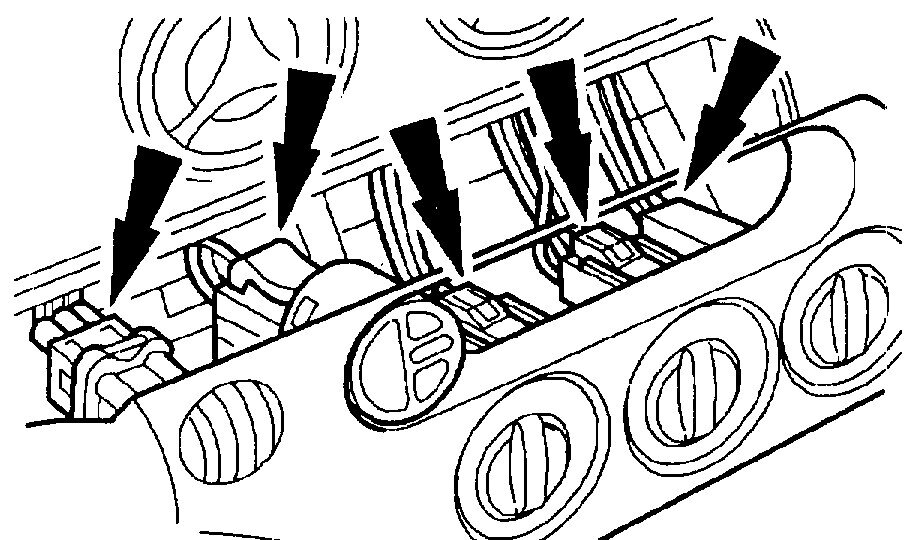

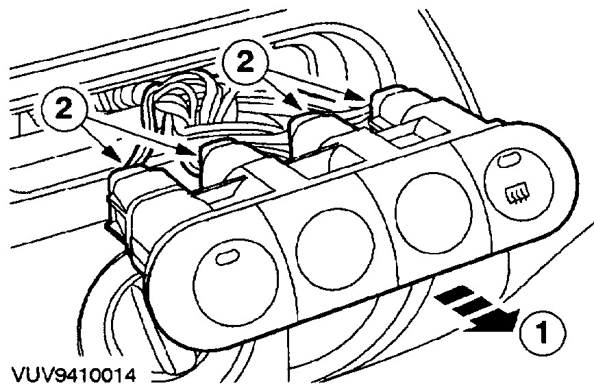

3. Remove the switch assembly.
1 Detach the switch assembly.
2 Disconnect the electrical connectors.

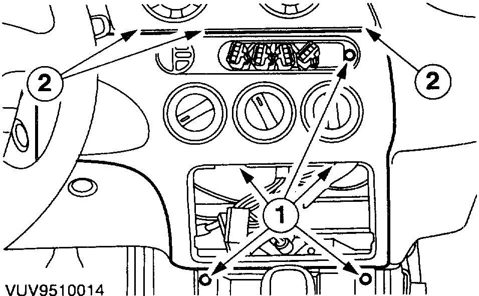

4. Detach the heater control panel/audio unit bezel.
1 Remove the screws
2 Detach the bezel from the clips.
5. Remove the heater control/audio unit bezel.
Disconnect the vacuum line.

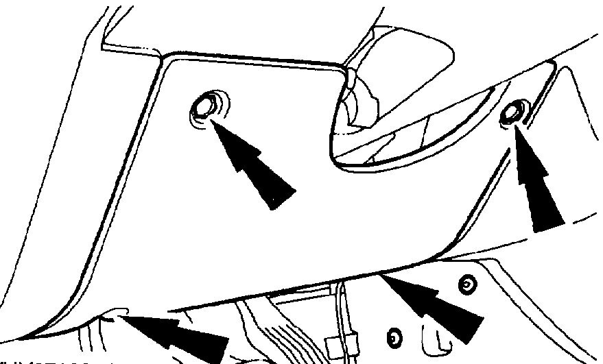

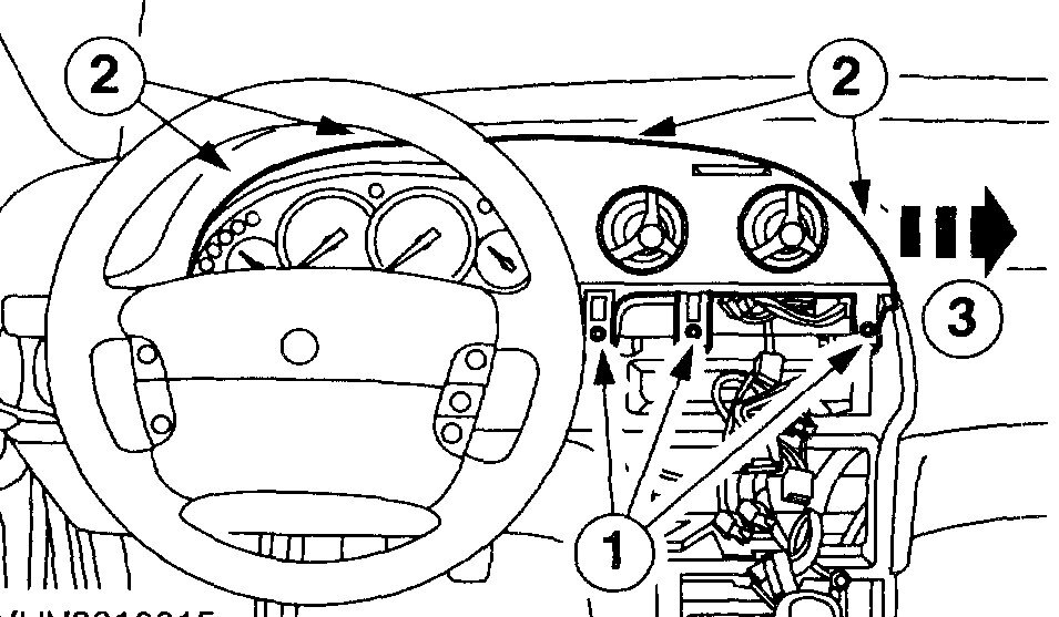

6. Remove the instrument panel lower trim panel.

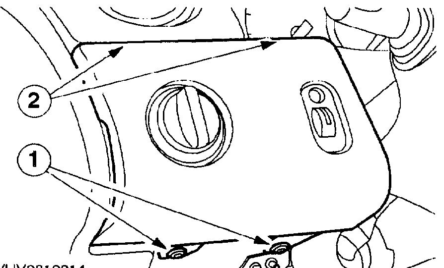

7. Detach the lamp switch panel.
1 Remove the screws.
2 Detach the panel from the clips.
8. Disconnect the electrical connectors.

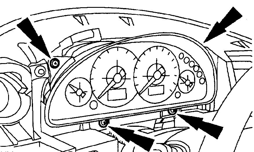

9. Remove the instrument cluster bezel.
2 Release the clips.
3 Remove the bezel.
10. Detach the instrument cluster.
11. Remove the instrument cluster.
