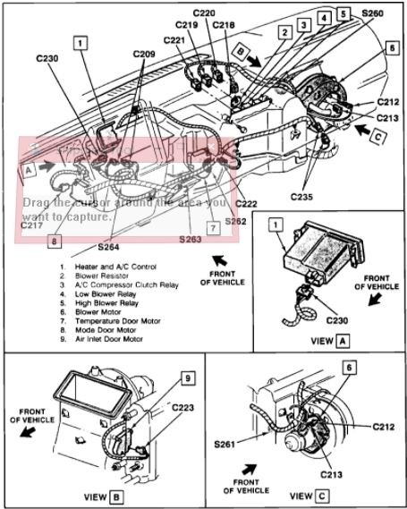

That looks like the part we replaced. We haven’t tried the reset with the battery cables yet. We should have time this weekend to work on the truck. We were going to pull the module back out and inspect the wiring and plug and try the reset.

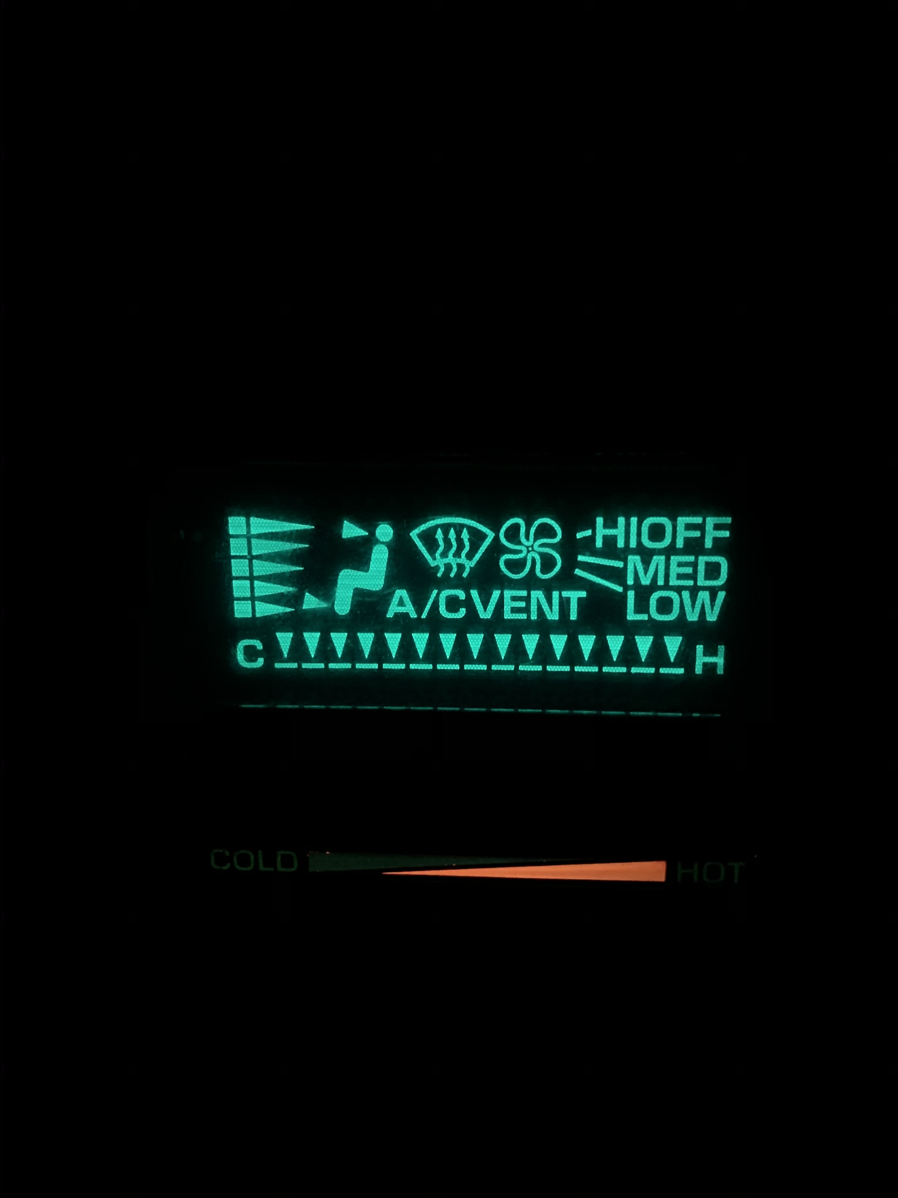

The fan does turn on. And you can change where the air exists the vents- floor, dash, defrost. It appears to blow hot air all of the time but our weather has been nearing the 100 deg range, so it’s hard to tell if it is the outside air temperature or actually producing heat. The A/C wasn’t working when I bought the truck and hadn’t been working for several years. Right after I bought it and before we replaced this module, I had our mechanic diagnose some problems for me. He determined we need a new compressor kit and condenser. We were going to order we these parts this weekend.
A couple times this week, the display has gone dark. So it went from everything lit up to nothing at all. I will check it later and see if it lights back up when i start it. It was unlit all day yesterday, I probably turned the vehicle on and off a half dozen times over the course of the day. Thanks for your help!
