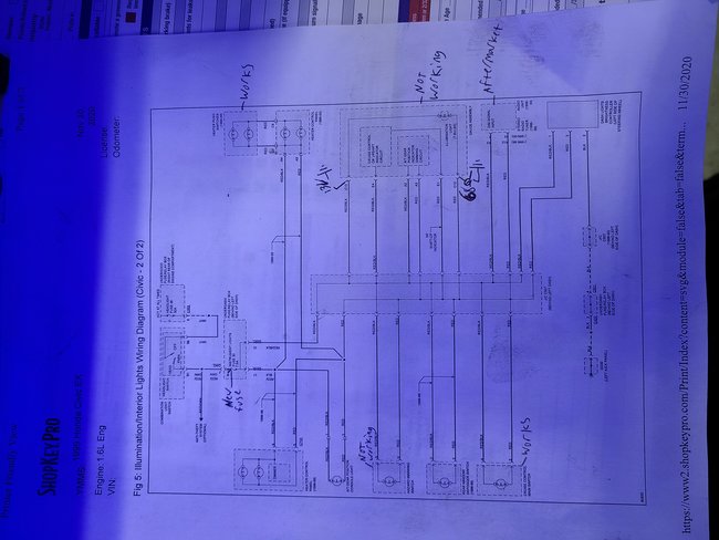

I have the car listed above EX model and had to rebuild the motor. I replaced the aftermarket radio with another after market radio . Now the instrument panel lights are not working. I made sure fuse 30 was good. And tested for voltage at c13 at the instrument panel and have 13v test for ground at c12 at the instrument panel and have 68 ohms, thinking it was high resistance I ran an overlay to jump the dimmer switch and it popped the fuse, so could it be that the dimming sensor in the OEM radio could be causing it to now work or should i look at the 68 ohms of resistance of the ground side?
