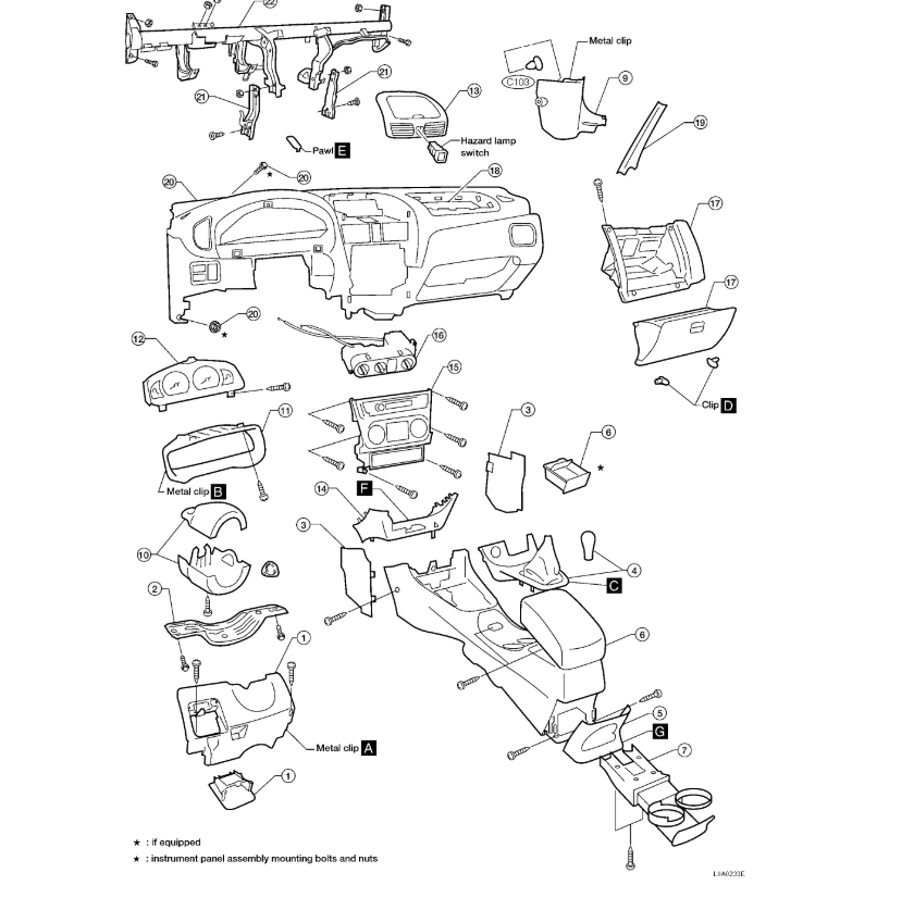

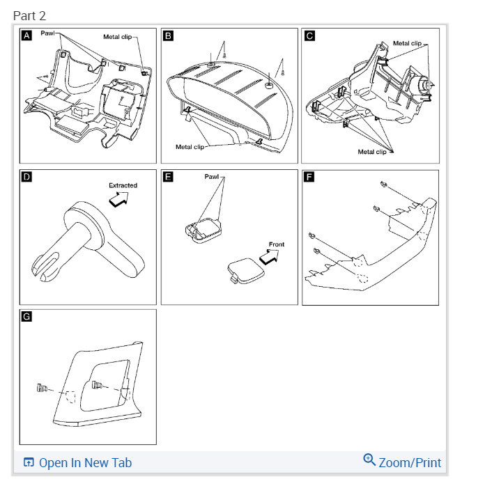

This is common when the cluster goes out. I would get a used/rebuilt unit. here is a video of the job being done on a similar car with instructions in the diagrams below. If you get a rebuilt unit you will need the VIN and mileage from your car so it can be programmed in.
https://youtu.be/_HEC44xENxw
