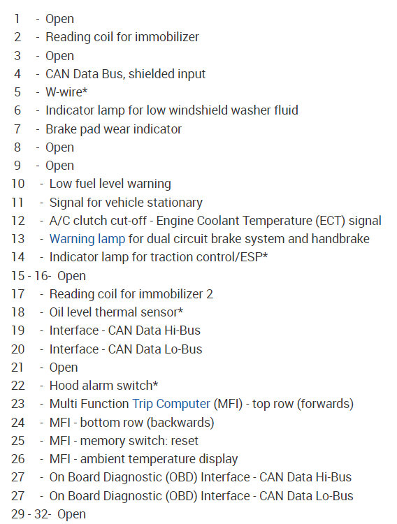

Greetings. Does anyone have the pin out of the instrument cluster on the vehicle listed above 9n? Thank you.
Apr 5, 2024 at 6:03 PM

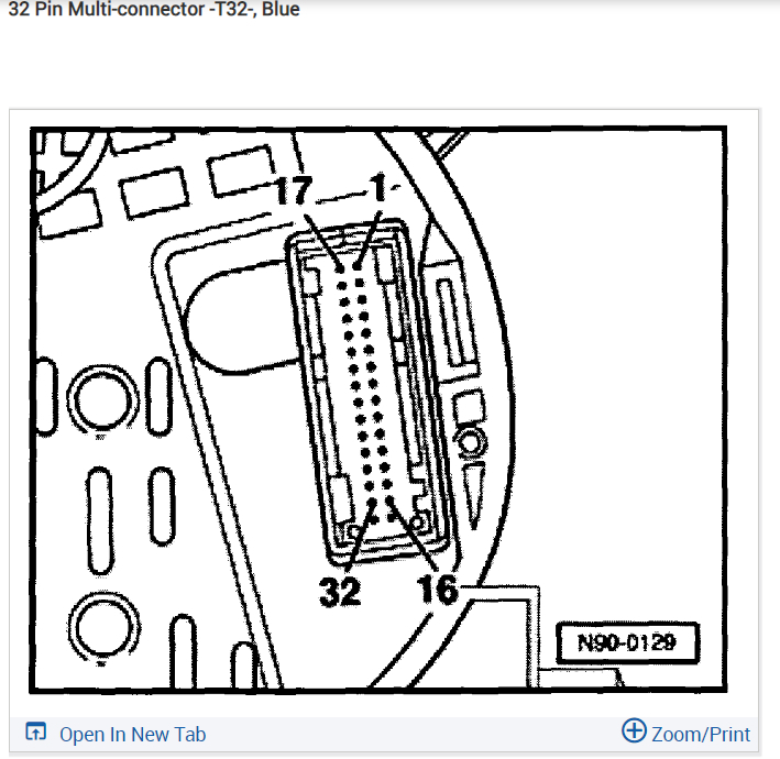

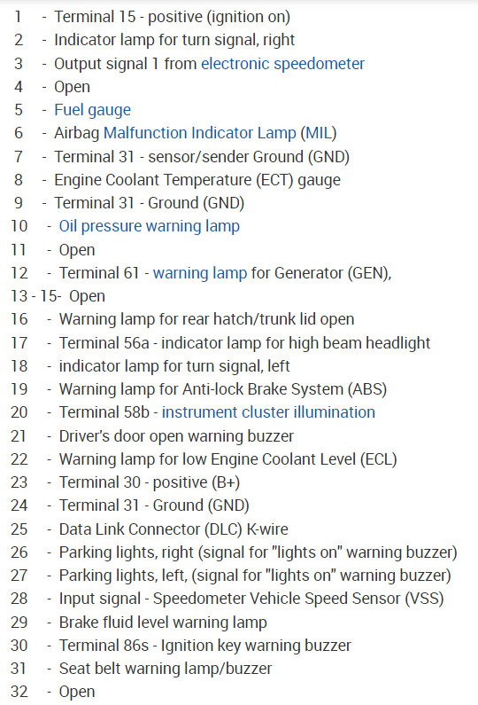

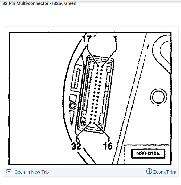

It looks like there can be two different connector views which I have included both. Check out the images (below). Let us know if you need anything else.
Apr 6, 2024 at 11:32 AM

Mine has the green and black connector. The pin outs are different.
