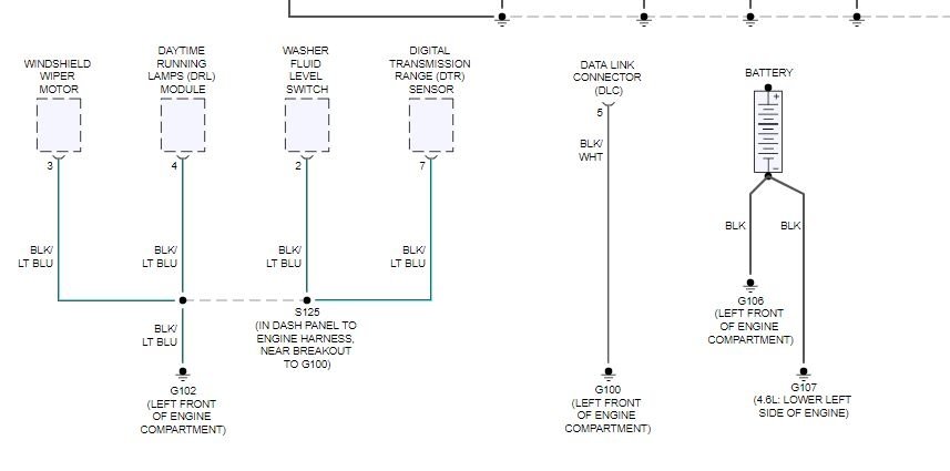

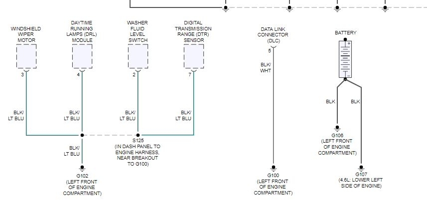

First thing that comes to mind is a ground issue, I would make sure the ground strap that goes from the engine to the body is intact and both ends are tight. This a common issue that creates a great deal of issues especially with Ford products (I'm a Ford man myself). If you can check that and make sure the ground from the battery to the engine block and body are all in good shape. If they are in good shape we can move on to more complicated diagnosis procedures.
I have attached a diagram showing where the grounds from the battery are located.
If you can check those and let us know your results we will be glad to guide you further if need be. Please keep us up to date on your progress and thank you for using 2CarPros!

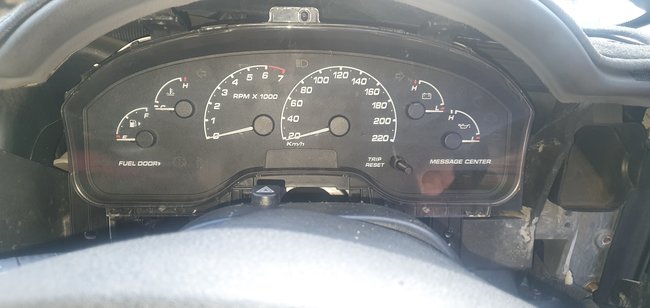

QLD TRUCKER
Gauges not working and message center, but the car still runs. I have checked all the fuses.
Dec 10, 2020 at 7:56 AM (Merged)

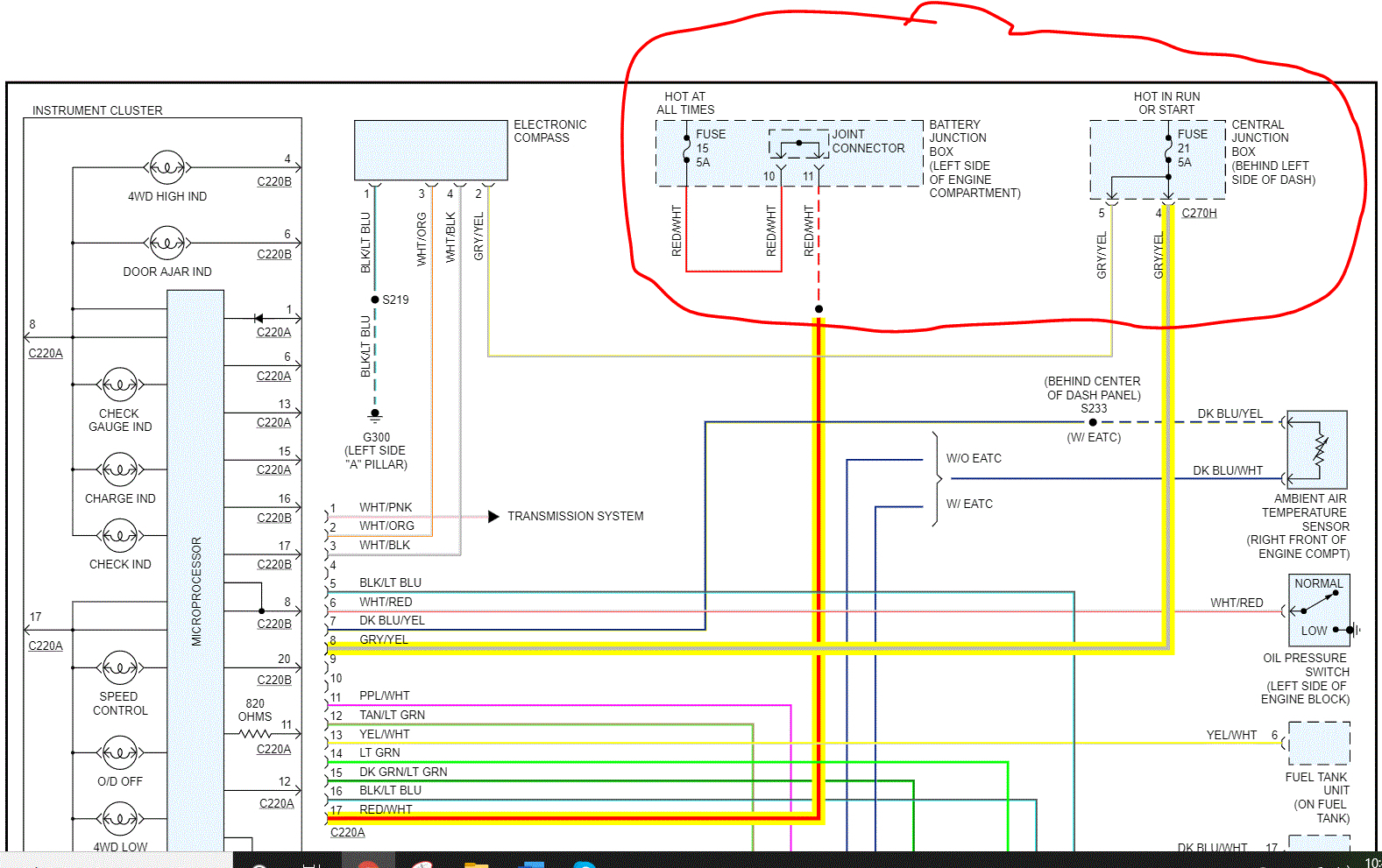

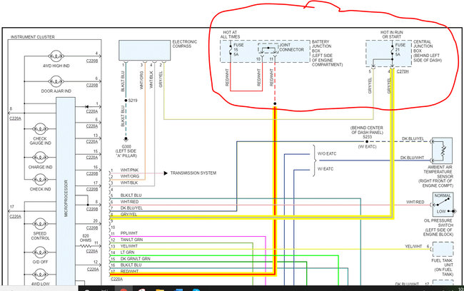

Did this happen all at once? Does the speedometer anything work? I attached a pic below of two fuses I want you to check. In addition to just checking the fuse, confirm there is power to it and out from it.
If there is power, you will next need to confirm the power is getting to the cluster. On the pic, you can see the wire colors and pin locations. Also, make sure the connector is tight and not damaged.
Here is a link you may find helpful when checking the fuses and for power to them:
Let me know what you find.
