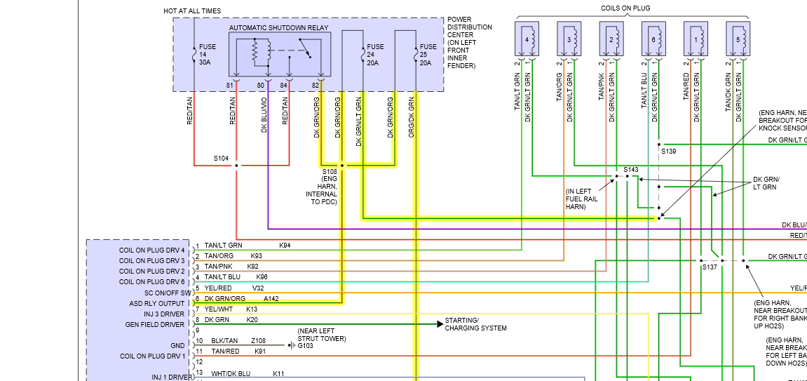

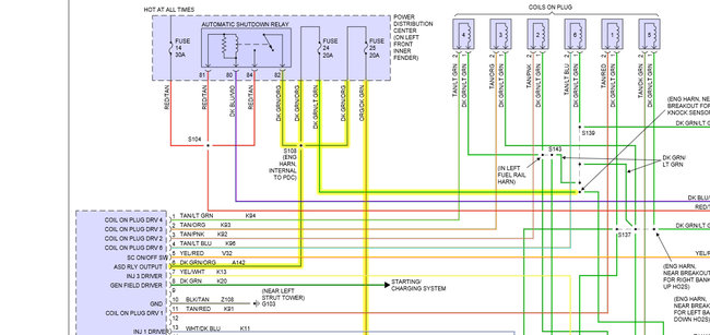

And here is the Auto Shut Down Relay diagram. you can check this for power as well. The ECM grounds this Relay on the dark blue/violet wire causing power on all the circuits highlighted in yellow. This will transfer power to Fuse # 24 and 25 in the fuse panel (left front inner fender well). You may have to dig a little to find this panel. As you can see in the diagram fuse #14 is hot at all times. So all those red/tan wires should be hot at that panel all the time. Let us know what you find.

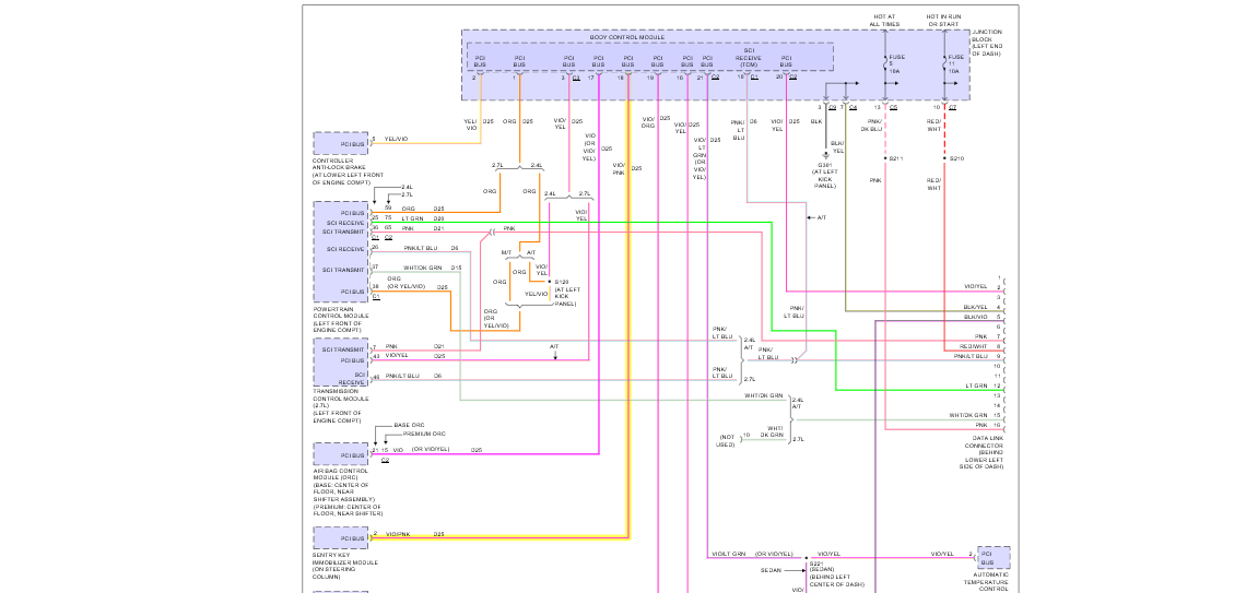

here is the data wiring diagram of the Immobilizer, Its actually on the steering column. Are there any lose wires or anything funky with the ignition switch itself that you notice. Because the Data feed for the Immobilizer goes straight to the Body Control Module which I'm sure is powered up by the ECM. That could be the reason for no light condition.

well you might want to check this auto shut down relay, it looks easy to test, it is in that fuse panel on the left inner fender. It should just feed power to Fuse # 24 and 25 with the key ON. they are both 20amp fuses. You could put a test light on them and at least know if the relay is being powered up or not.

I checked #24 and #25 with ignition on and off, no light. I swapped with another relay to double check. I believe I found the ECM Bus and checked pink to drk blue no light. I was unable to find Security connector on the column and have ran out of daylight. I expected it to connect to the SKIM but there was no pink wire there. I now remember why I quit being a locksmith.

well power to those two fuses is a problem, can check to see if you have power at fuse number fourteen near that inner fender, its a thirty amp. swapping another relay probably wont do anything at this point. The ECM grounds the shut off relay and that powers up a bunch of other circuits, so we need to see why the ECM is not powering up. The ECM also provides the ground for the Starter Relay. that is why you're not get any crank either. And when you check these fuses, make sure you either take them out and really check them or put a multi-meter across them and check for continuity.

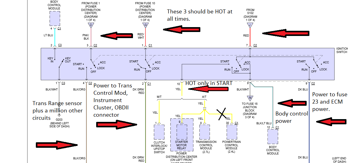

Okay, we are just going to have to jump back and forth a bit. Fuse number twenty three should be Hot with Key in RUN or START. This power from the ignition switch to the ECM, Fuel pump relay and one other circuit. We may have to go by the VIN number tomorrow, so I can see exactly which model I am looking at here. It seems they changed some of the ECM harness with this production change.

I did a little more research here, I am thinking you may want to have a look behind these fuse panels, both, the one under the driver side dash and the one under the hood if you are up to it. They can get corroded underneath and we need to find why that fuse blew. Check for loose harness plugs under the dash as well, this can be a problem on this vehicle.
we also need to make sure the ignition switch is sending power to the ECM in RUN an START position. So to start with I am sending some diagrams of the ignition switch and what wires to check for power at certain key positions. This should not be too difficult, I am labeling everything for you.

Well we have discovered the answer but the mystery deepens. There was no fuse in number twenty three. I put a new fuse in and everything works perfectly. I was meticulous in my removal and installation of the fuses. I have no idea how or why that fuse would be missing. how would someone be so that savvy to remove it? How did the other one blow? This is insane. All I can say is thank you for your help.
