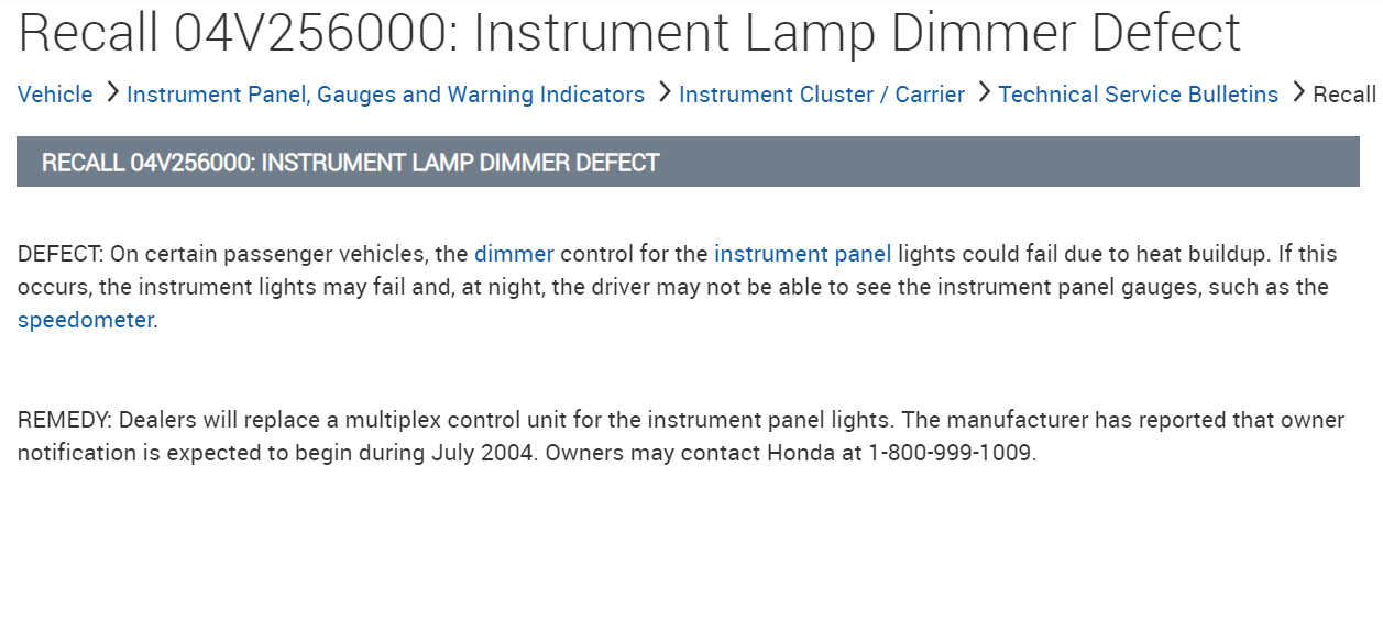

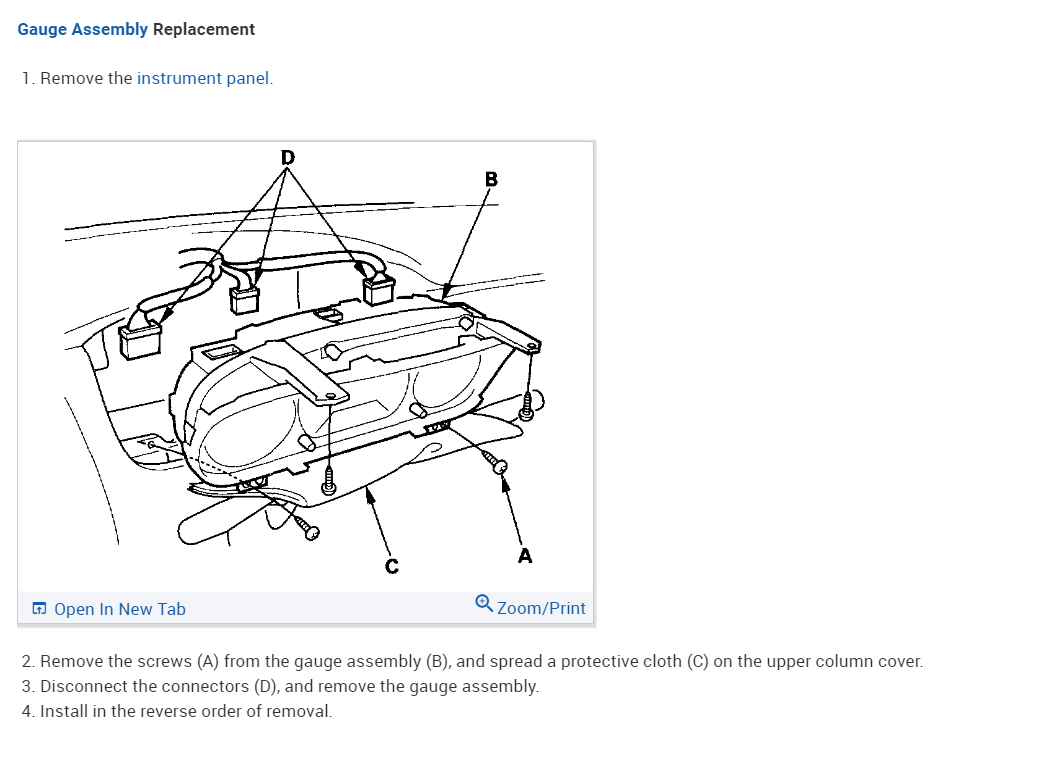

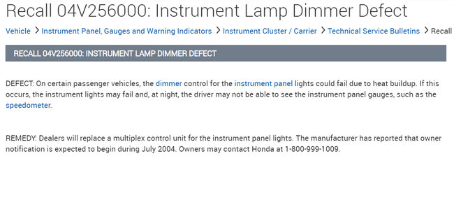

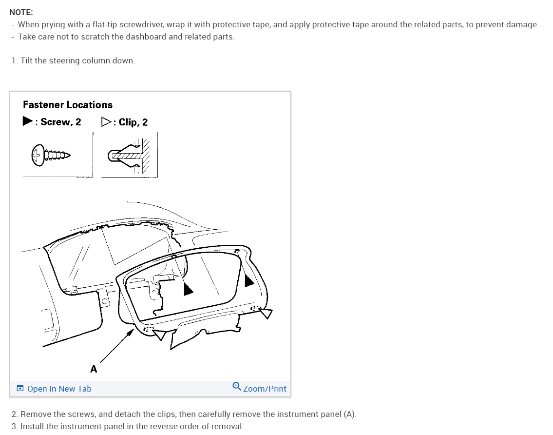

Hello, there was actually a Recall due to this issue. There is a problem with heat buildup in the Instrument Cluster and causes the bulb for some gauges to fail. I will post the recall information. I don't think the dealership will honor a recall so old, but I will include the instructions for pulling the cluster as well,

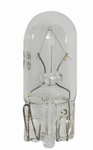

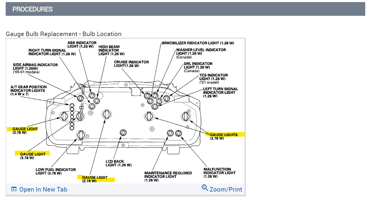

It looks like you can replace just the gauge bulbs, and it's pretty easy to do, but because of this recall. I would inspect the wiring harness plugs for the Instrument Cluster for any heat related discoloring or wiring that may have the insolation falling off. If there is a heat issue, the wires will be brittle and the connectors and or the connector pins can have discoloring. When you have the Cluster out, check the connector pins also that they are not spread apart. Heat will do that too, make sure the female pins on the connectors will fit snug on the Cluster male pins. You'll have to take one of the gauge bulbs out to see what kind they are. I do not see a part number listed, but if I can find one Ill update this post.
Okay, in the fifth picture, it looks like these are the instrument panel bulbs. But take one out just to be sure.

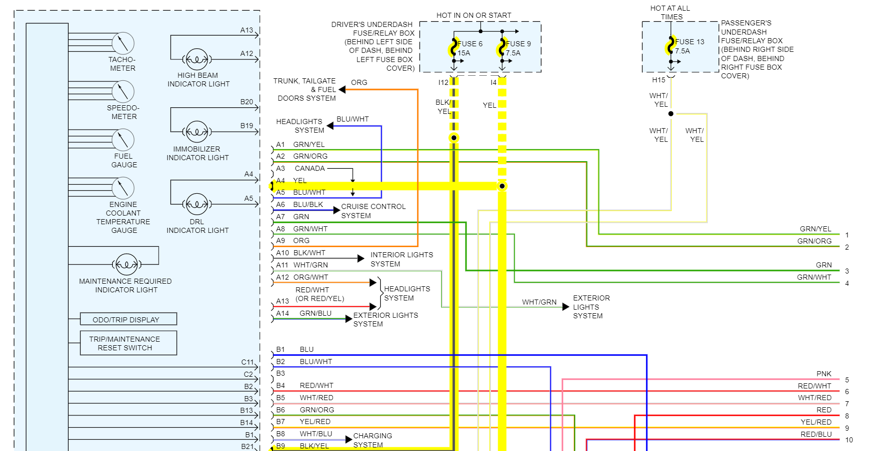

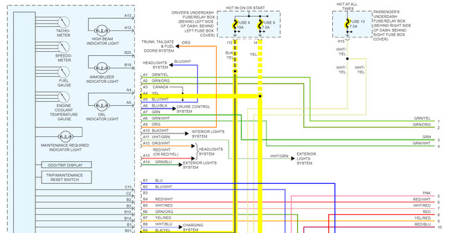

Okay, inspect the harness connectors if you already changed them and there was no effect. It looks like there are five for the gauges. Here's the wiring diagram with the fuses for the Cluster, just in case and this is supposed to be the bulb, so really take a good look for overheating issues, since you've already replaced some bulbs. Let us know what you find.
