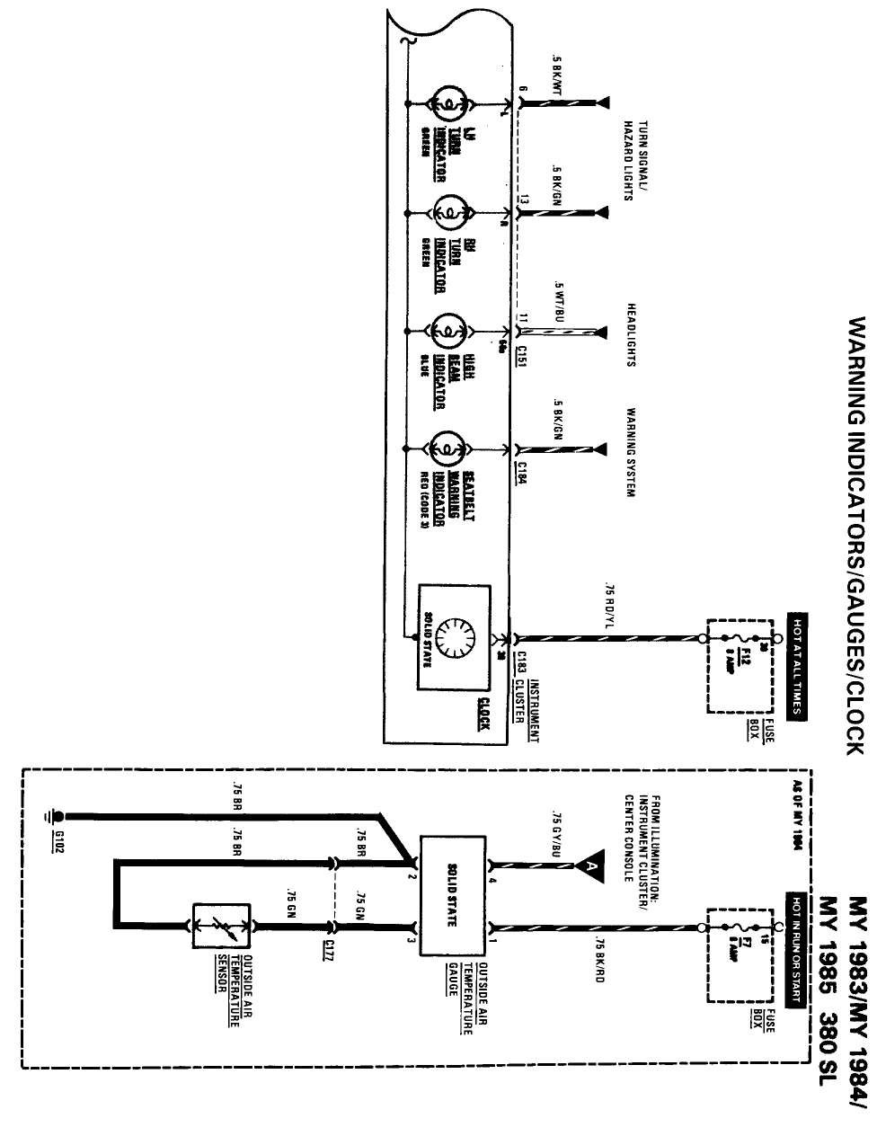

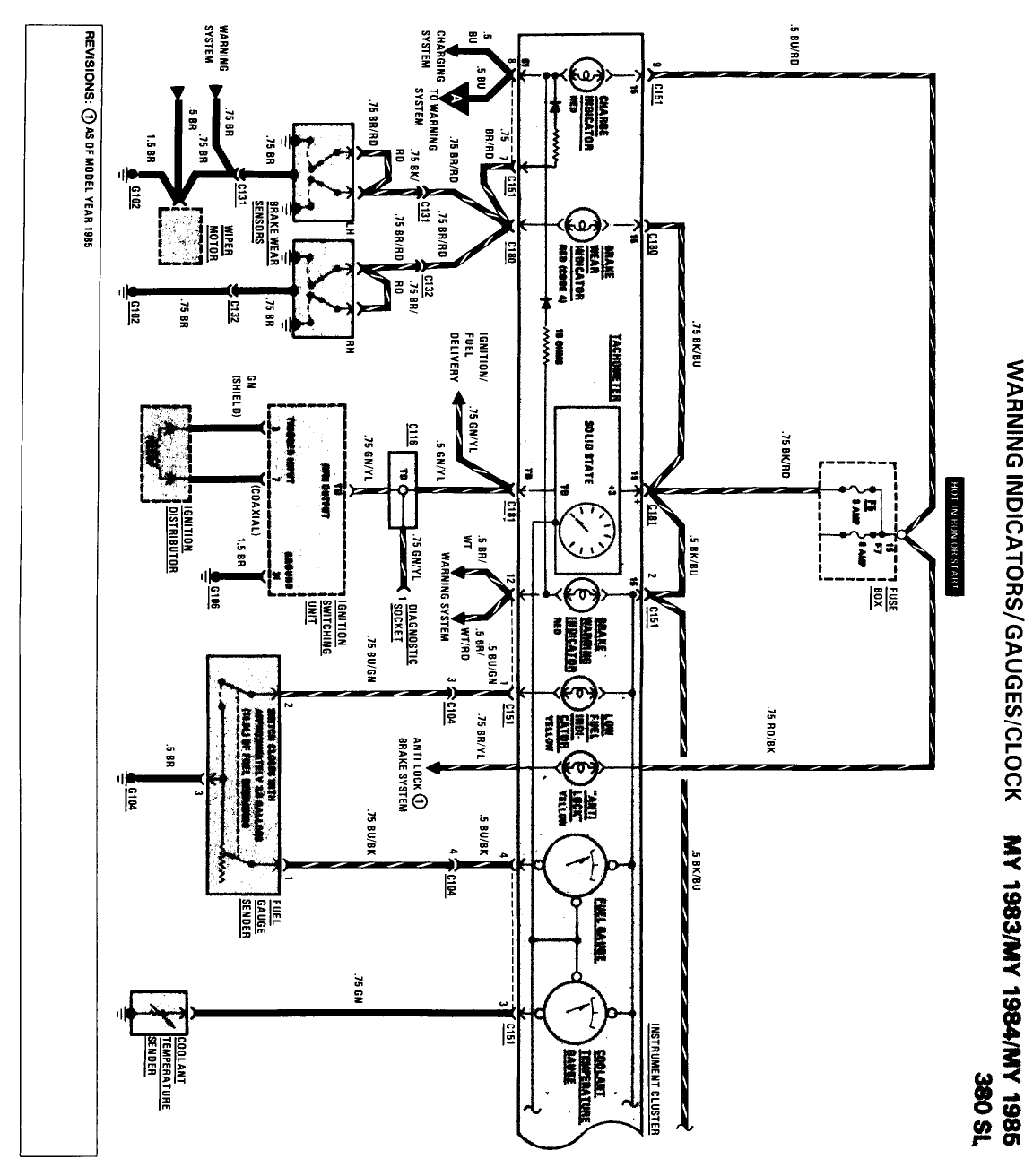

I need to know the correct pin assignment for for the round 15 pin plug/connector that connects to the rear of the instrument cluster. I need to know which wires connect to each port.
May 28, 2018 at 12:12 PM

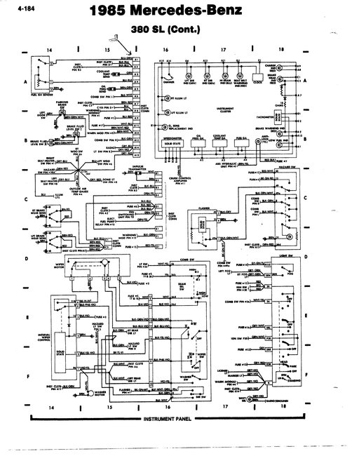

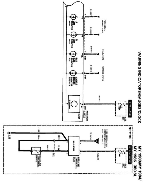

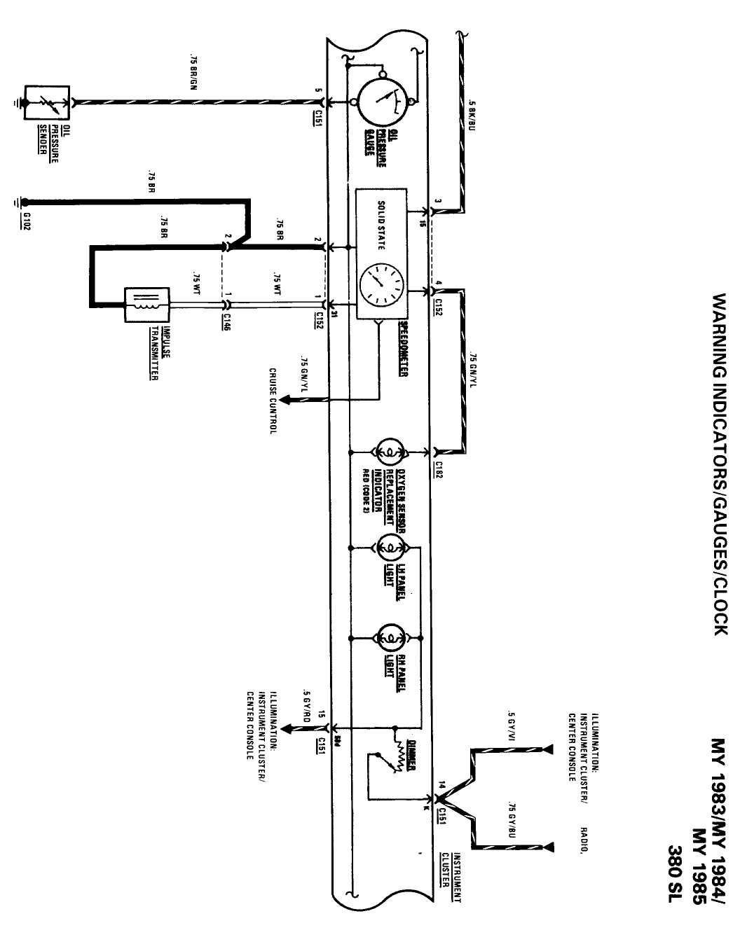

I have attached the wiring diagrams and the pin outs for both dash assemblies. Between them it should not be hard to determine which pin does what. Mercedes does not list a "pin one goes to the left turn indicator" style listing just the wiring and the colors.
Is there a particular system you are having an issue with in regards to the panel?

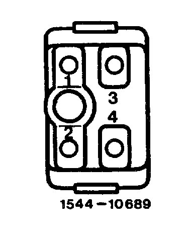

Connector 2
1 brown
2 white
3 black/blue
4 green/yellow

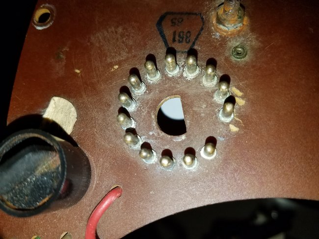

The 15 pin connector broke (fell apart in my hands) and now I do not know how to put them back. I have purchased a new one and I am just trying to put them back. Thanks.

I agree. On the back of the board, which pin is pin #1? Thanks. Do you have any illustrations?
May 30, 2018 at 6:10 PM
CHARLESTUCK
  • 61 POSTS
I figured out #1 location, but I do not have a brown/yellow wire.
May 30, 2018 at 6:26 PM
CHARLESTUCK
  • 61 POSTS
I only have 14 wires. 1985 380SL.
May 30, 2018 at 6:27 PM
There are two versions One for the mechanical tachometer has fourteen wires with pin 11 empty, the other is for electronic tachometers and uses fifteen wires. Brown and yellow are for the anti-lock brake option. If you do not have those you will not have that wire.
May 30, 2018 at 7:08 PM
CHARLESTUCK
  • 61 POSTS
Got it, there are only 14 pins. #10 is blank. Thanks a lot.
May 30, 2018 at 7:52 PM
CHARLESTUCK
  • 61 POSTS
I am attaching a copy of the 1985 380sl instrument cluster wiring diagram.
May 30, 2018 at 8:27 PM
I show pin 11 as empty on the diagram from the Mercedes information. With Mercedes things can be interesting depending on the exact build dates on the cars as they made running changes throughout the models and years. Sometimes those made it into the book, sometimes they did not.
