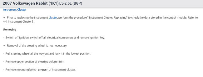

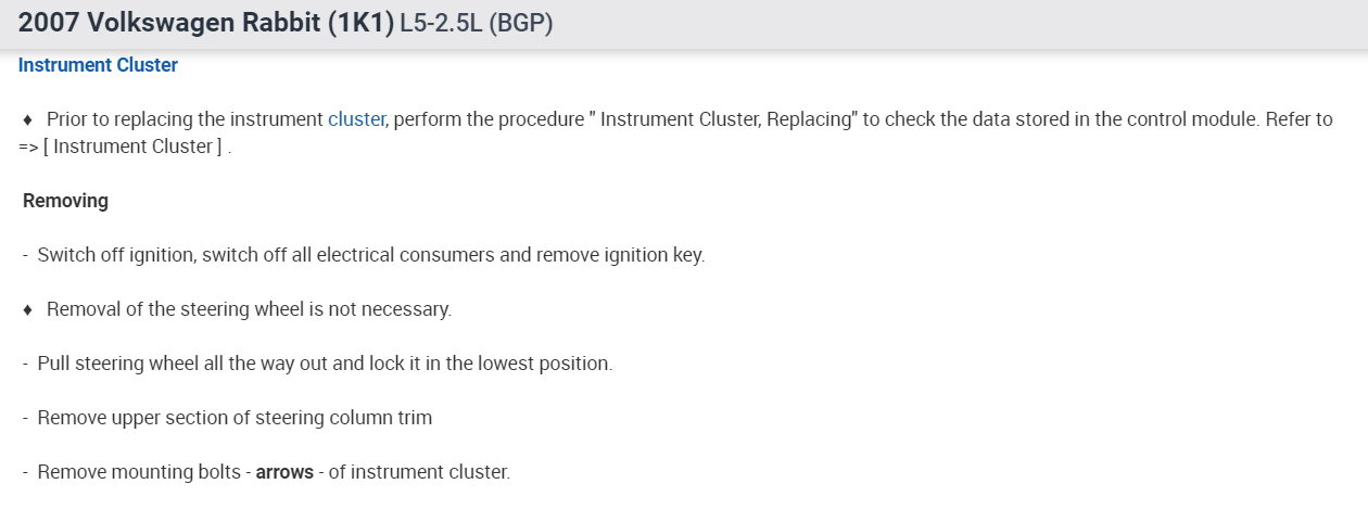

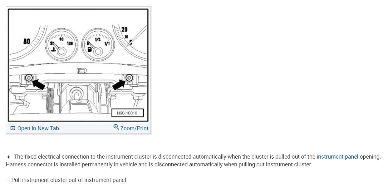

Please go over these guides and get back to us. Here is how to replace the cluster in case a code comes up for it. Check out the images (below). Let us know what happens and please upload pictures or videos of the problem so we can see what's going on.
