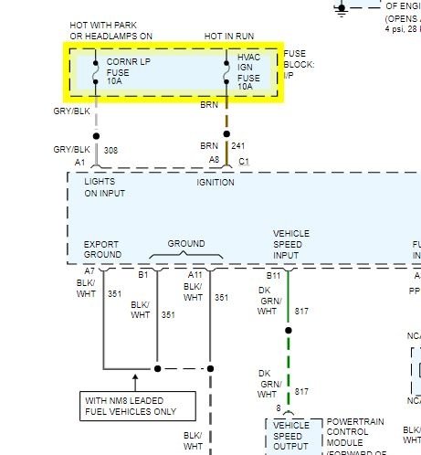

The headlights need to be on for the corner light fuse to get power.
Did you check both sides of the fuse for power to be sure th fuse is good?
If you did, then chances are the cluster is dead.

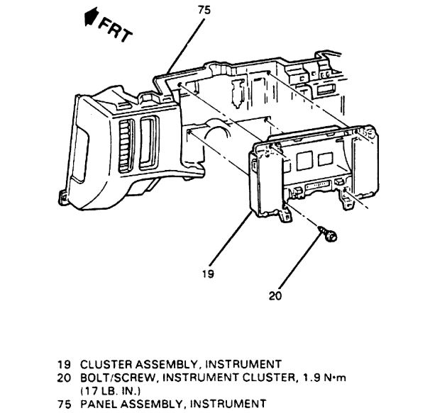

1. Remove instrument panel left sound insulator assembly.
2. Remove instrument panel driver knee bolster deflector.
3. Remove steering column tilt lever assembly.
4. Remove cluster trim plate.
5. Disconnect transmission shift indicator cable.
6. Remove instrument cluster attaching screws, Fig. 16 then remove cluster.
7. Reverse procedure to install.
