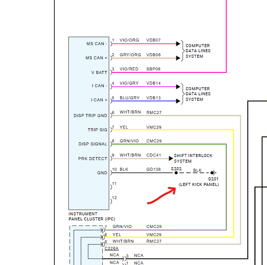

The instrument cluster doesn’t work. It doesn’t light up or do anything I checked the fuses and replaced them with new fuses and it still doesn’t work. I removed the cluster and cleaned the connectors with electrical cleaner and it still doesn’t nothing. There’s power to the connectors that connect to the cluster
