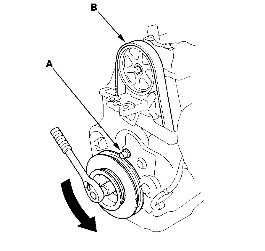

Special Tools Required
- Holder Handle 07JAB-001020A

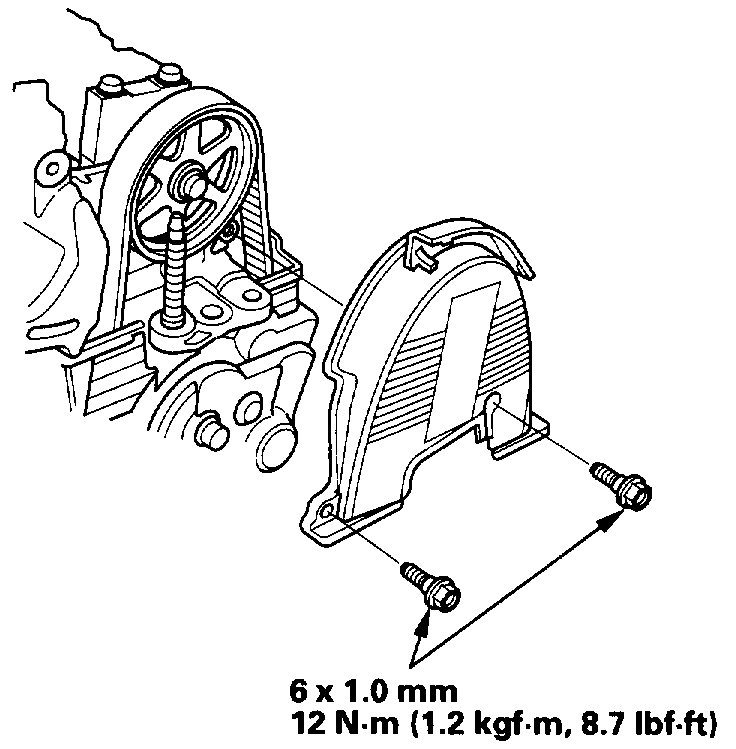

1. Make sure you have the anti-theft code for the radio, then write down the frequencies for the radio's preset buttons.
2. Disconnect the battery negative terminal first, then the positive terminal.
pic 1

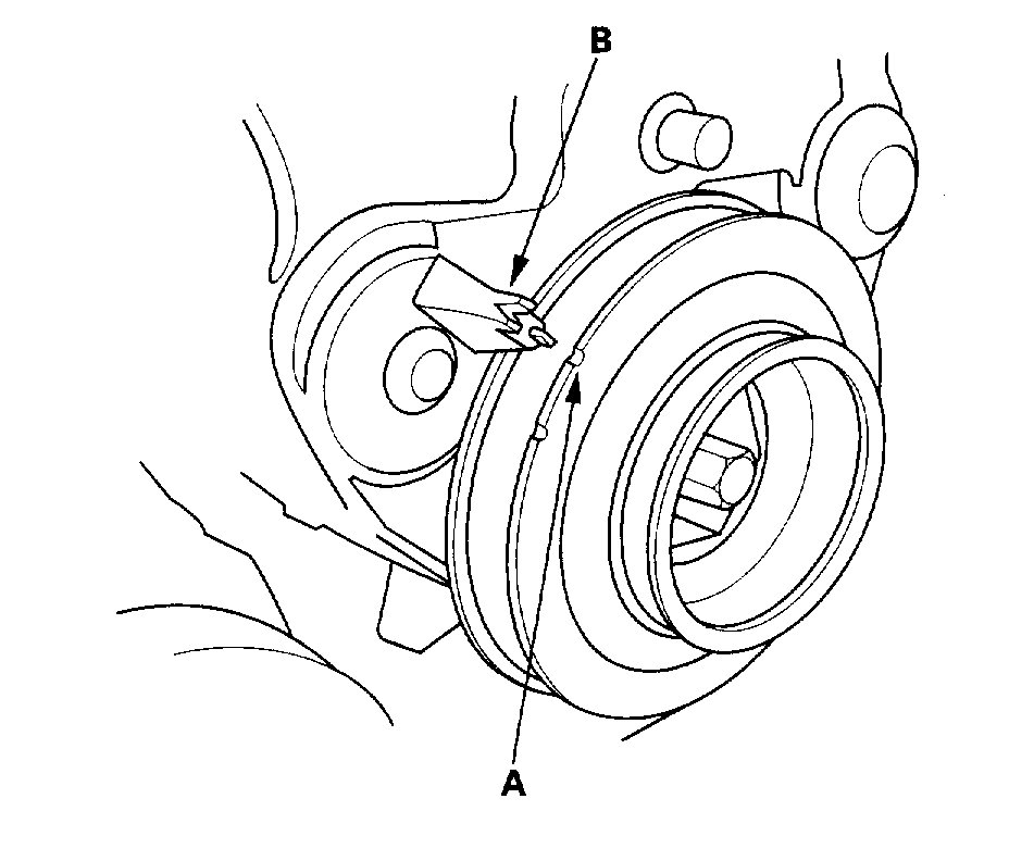

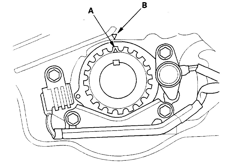

3. Turn the crankshaft pulley so its Top Dead Center (TDC) mark (A) lines up with the pointer (B).

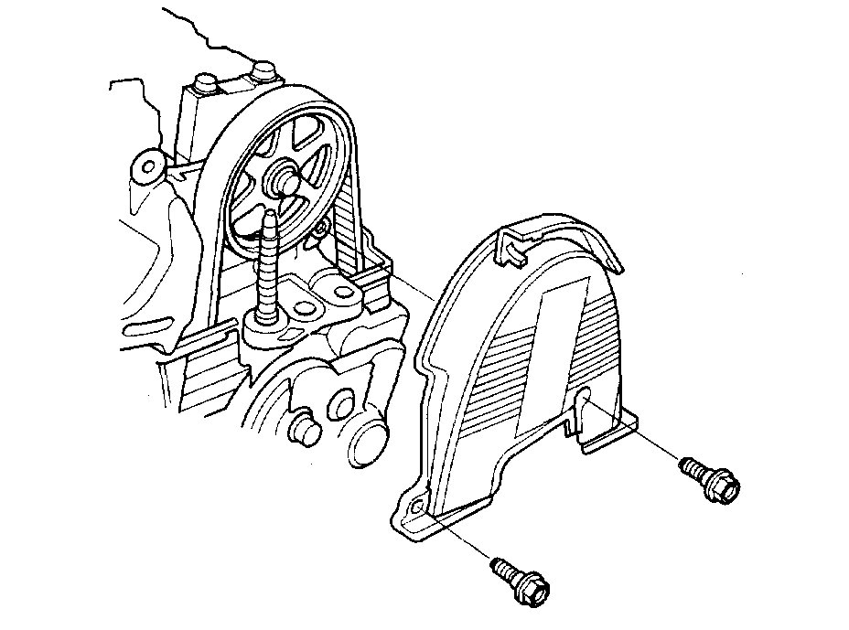

4. Remove the front tires/wheels.
pic 2

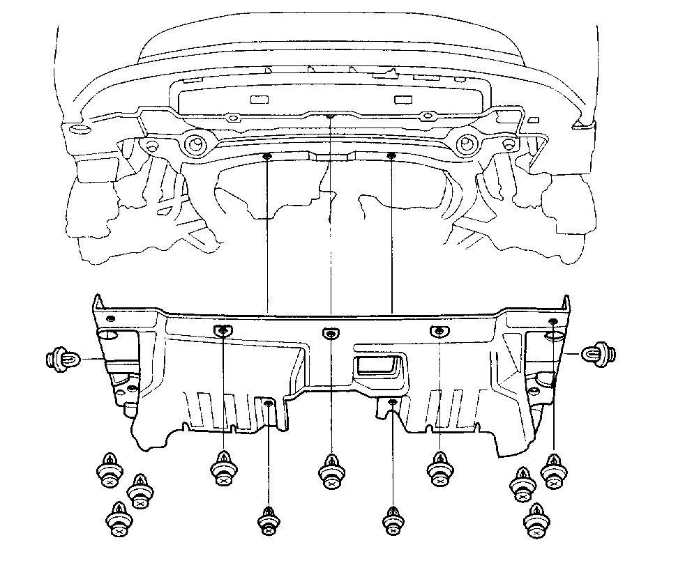

5. Remove the splash shield.

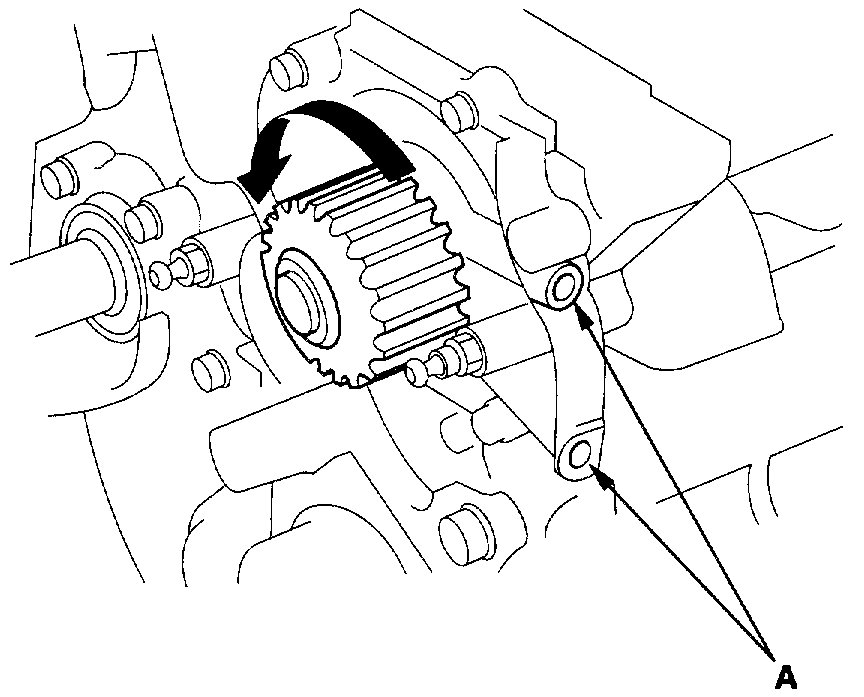

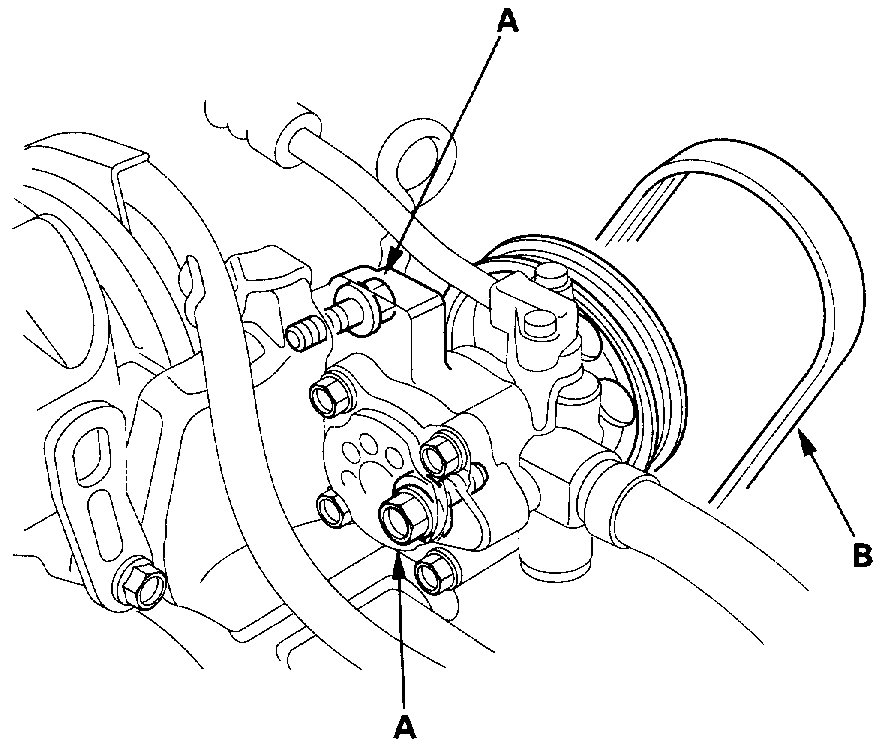

6. Loosen the mounting bolts (A), then remove the Power Steering (P/S) belt (B).
pic 4

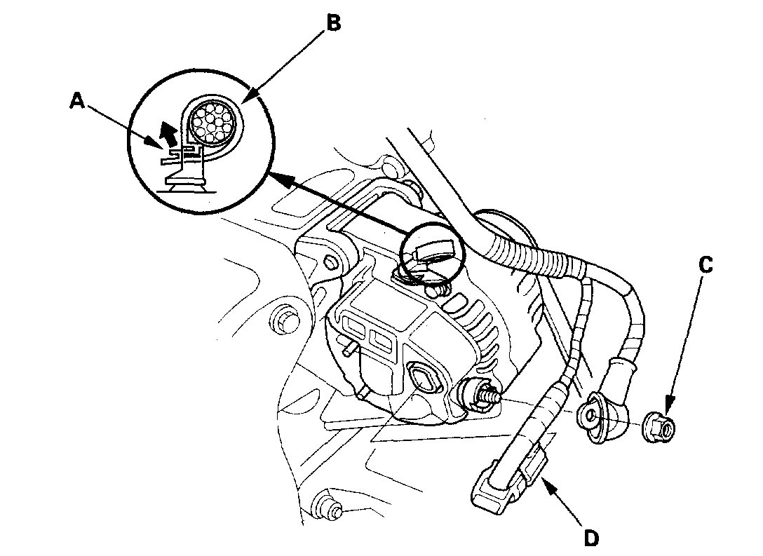

7. Disconnect the alternator wire harness.
-1 Pull up the lock (A), then release the wire harness tie (B).
-2 Pull back the boot and remove the 6 mm nut (C).
-3 Disconnect the connector (D) from the alternator.

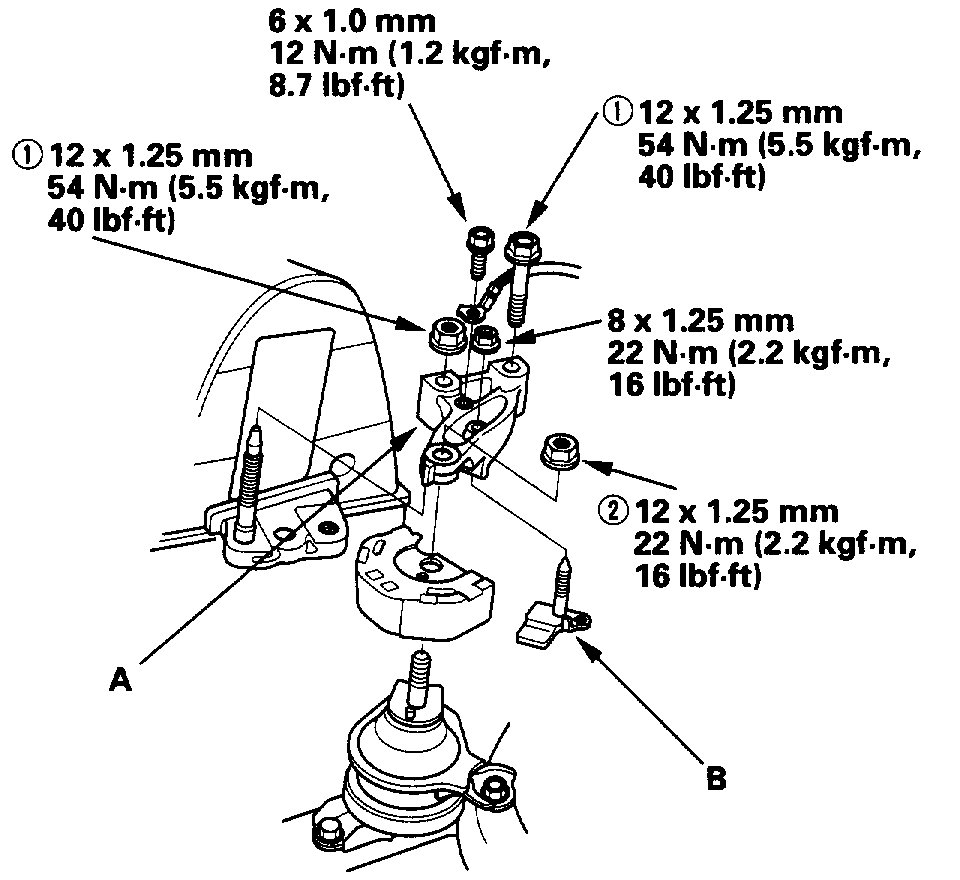

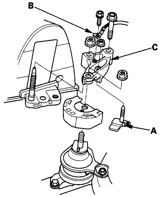

10. Support the engine with a jack and wood block under the oil pan.
pic 5

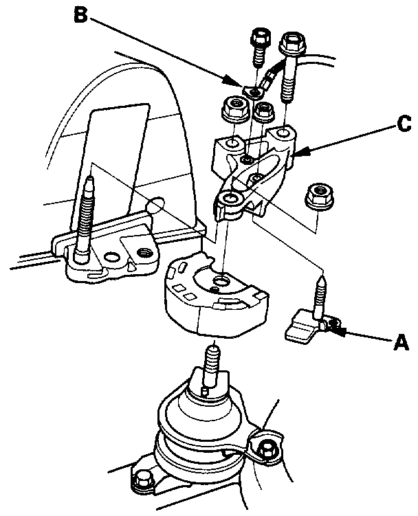

11. Remove the stop (A) and ground cable (B), then remove the upper bracket (C).

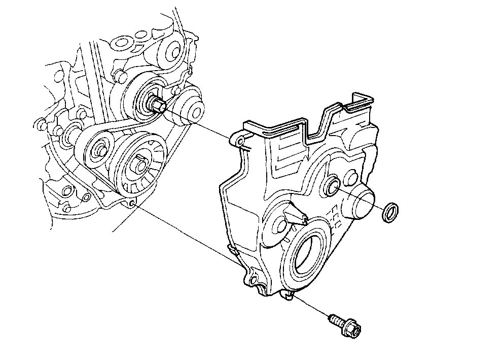

13. Remove the upper cover.
pic 7

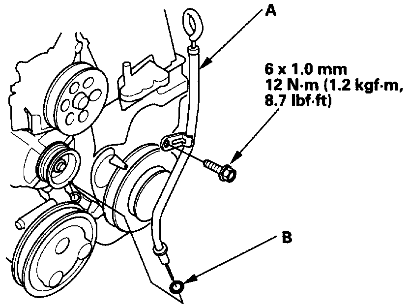

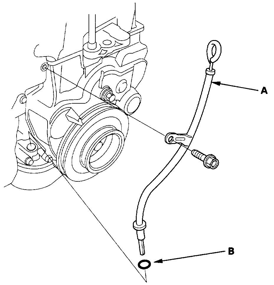

14. Remove the dipstick and tube (A). Discard the O-ring (B).
pic 8

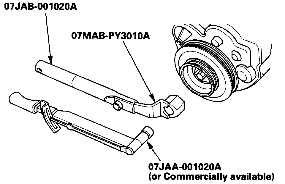

15. Hold the pulley with the special tools.
16. Remove the bolt with a heavy duty 19 mm socket (A) and breaker bar.

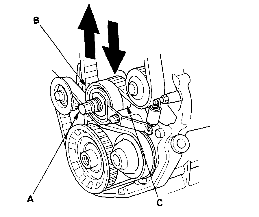

19. Release tension from the balancer belt:
-1 Install a 6 mm bolt (A)(from the timing cover) through the hole in the end of the timing belt adjuster arm to temporarily lock the arm in place.
-2 Loosen the adjusting nut (B) 2/3 - 1 turn.
-3 Push the tensioner (C) up to take tension off the balancer belt.
-4 Retighten the adjusting nut (B).
pic 11

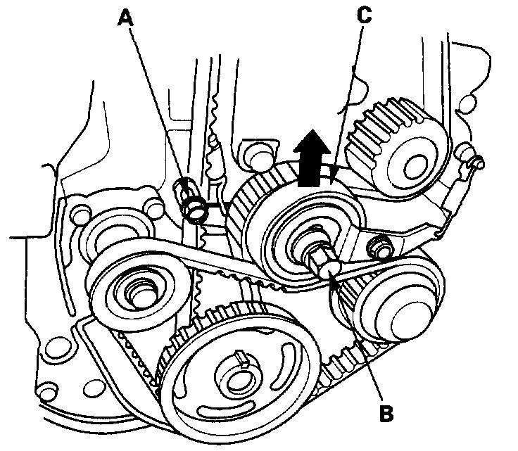

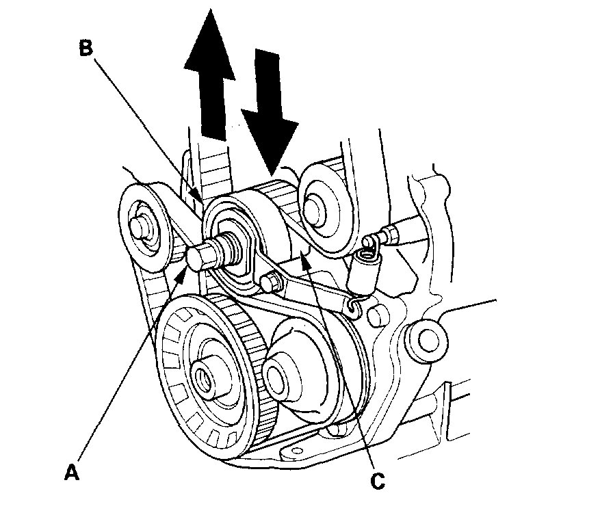

20. Release tension from the balancer belt and the timing belt:
-1 Loosen the adjusting nut (A) 2/3 - 1 turn.
-2 Push the balancer belt tensioner (B) up to take tension off the balancer belt.
-3 Push the timing belt tensioner (C) down to take tension off the timing belt.
-4 Retighten the adjusting nut (A).

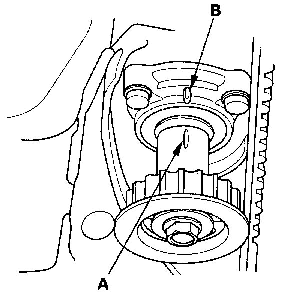

3. Set the crankshaft to Top Dead Center (TDC). Align the dimple (A) on the tooth of the timing belt drive pulley with the pointer (B) on the oil pump.

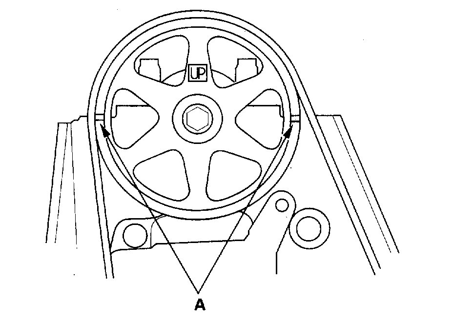

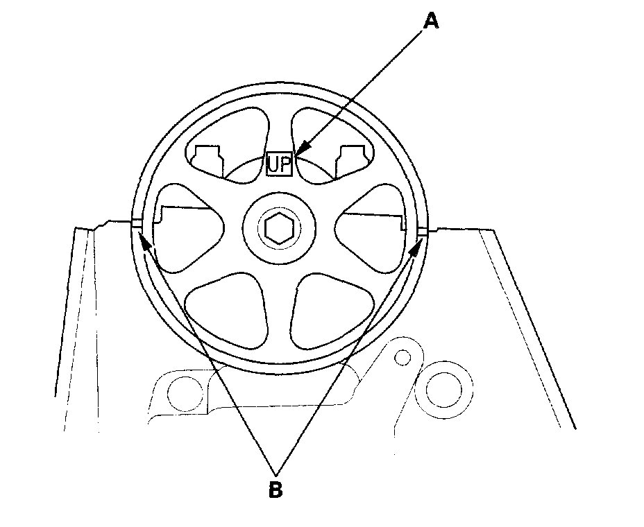

4. Clean the camshaft pulley and set it to TDC.
-1 The "UP" mark (A) on the camshaft pulley should be at the top.
-2 Align the TDC grooves (B) on the pulley with the top edge of the head.
pic 14

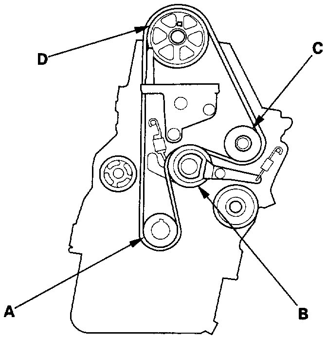

5. Install the timing belt in a counterclockwise sequence, starting with the drive pulley.
-1 Drive pulley (A).
-2 Tensioner pulley (B).
-3 Water pump pulley (C).
-4 Camshaft pulley (D).

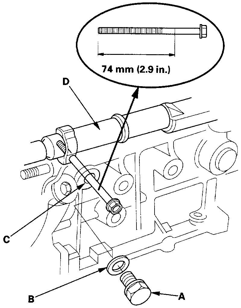

19. Align the rear balancer shaft pulley with a 6 x 100 mm bolt (or equivalent).
-1 Remove the bolt (A) and washer (B) from the maintenance hole (C).
-2 Scribe a line on a 6 x 100 mm bolt, 74 mm (2.9 in) from the end.
-3 Insert the bolt in the maintenance hole and into the hole in the balancer shaft (D) up to the line you scribed.

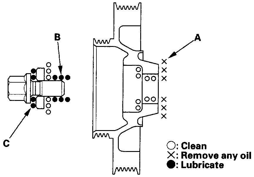

27. Install the rubber seal around the adjusting nut.
28. Clean the crankshaft pulley bolt and washer.
pic 20
29. Clean all oil off the inside face (A) of the crankshaft pulley, and apply lubricant to the pulley bolt (B) and washer (C).

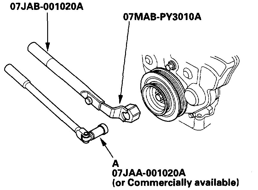

pic 21
30. Install the crankshaft pulley, and tighten the bolt to 245 Nm (250 kgf.m, 181 ft. lbs.) using the special tools.

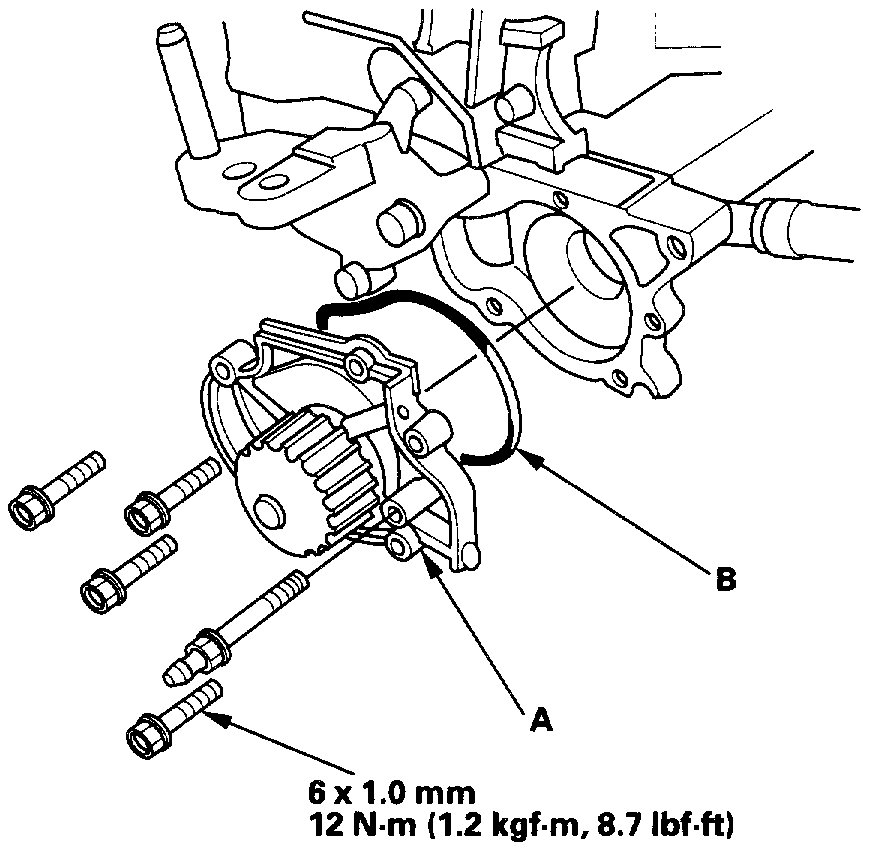

REPLACEMENT
1. Remove the timing belt.
2. Remove the camshaft pulley and the back cover.
3. Remove the water pump (A) by removing five bolts.
pic 26
4. Inspect, repair and clean the O-ring groove and the mating surface on the cylinder block.
5. Install the water pump, with a new O-ring (B), in the reverse order of removal.
