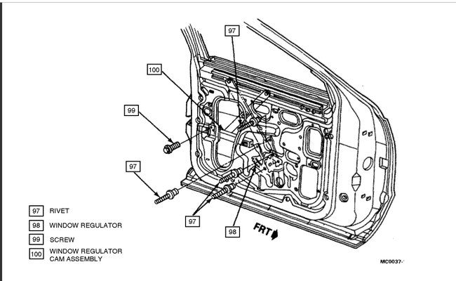

How do you install new rear door glass?
Aug 16, 2017 at 3:44 PM
CERTIFIED EXPERT
53,855 POSTS
You must remove the door panel first and then the window regulator. On yours the rivets must be drilled out and it will be spring loaded so watch yourself.
Here are a few guides and a diagram to help you (below):
https://www.2carpros.com/articles/door-panel-removal
and
https://www.2carpros.com/articles/how-to-check-and-replace-a-electric-power-window-motor
Image (Click to enlarge)
