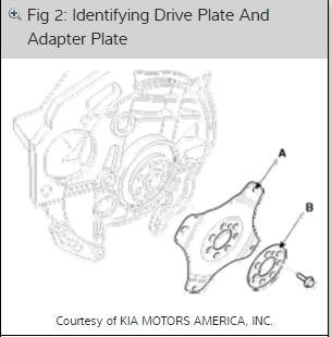

what way does a flex plate bolt on to the crankshaft? does the flare go toward the engine or toward the flywheel?

Diagram shows the installation position. Flared towards engine.
