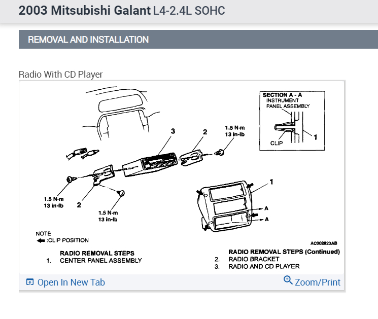

I do not know the RMS (Root means square). This video shows the installation of a new radio in a similar car with instructions for your car in the diagrams below:
https://youtu.be/1bIa3jdJWVQ
Check out the images (below). Please let us know if you need anything else to get the problem fixed.
