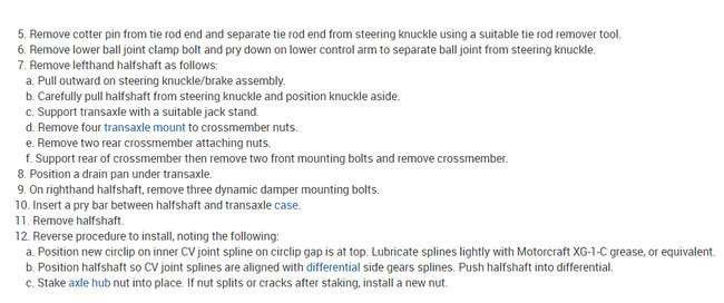

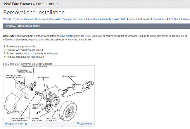

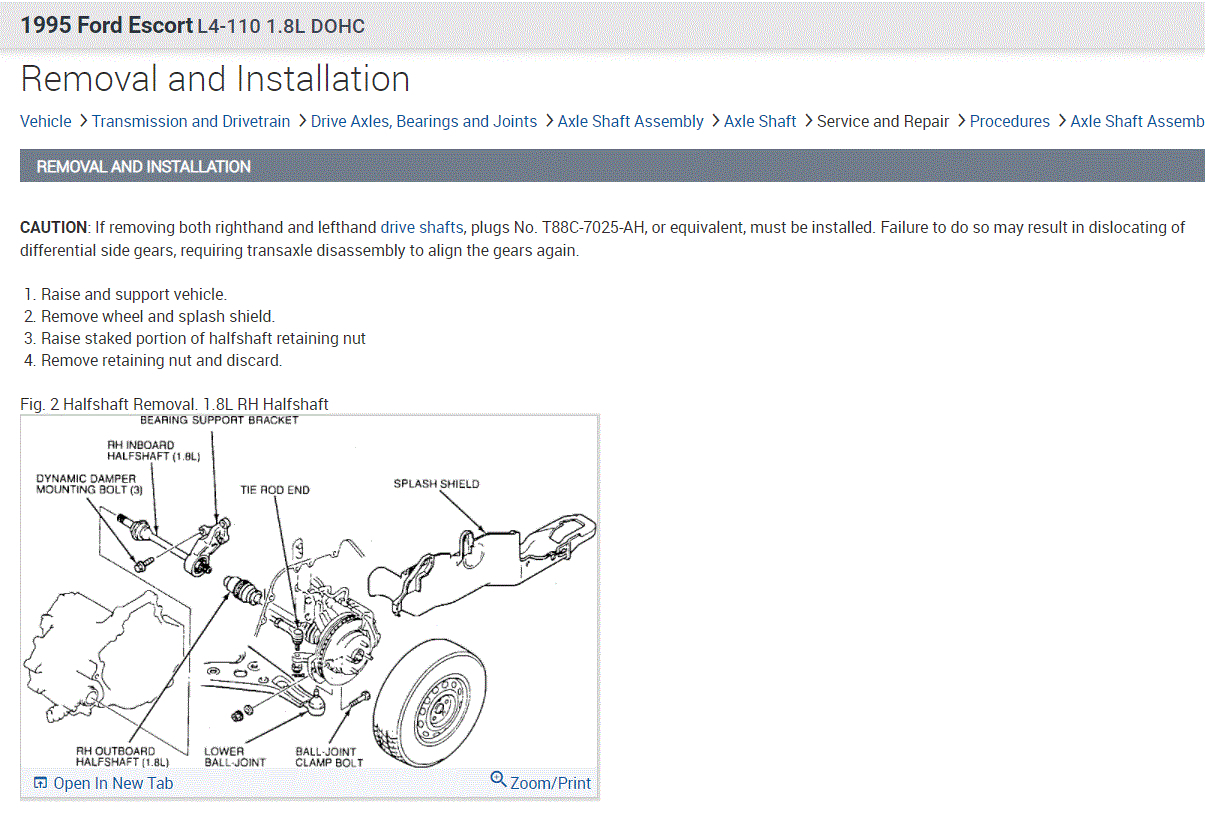

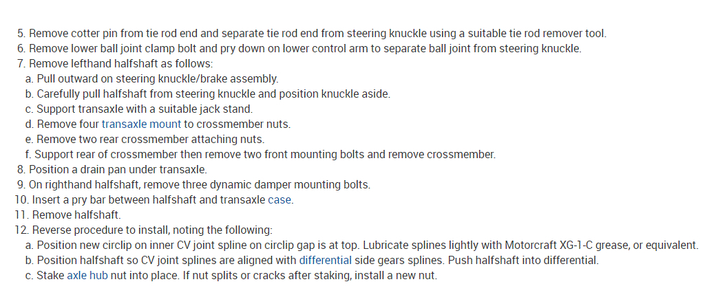

I attached the directions for removal and replacement specific to your vehicle below. Take a look through them and see if anything helps.
Let me know what you find.
