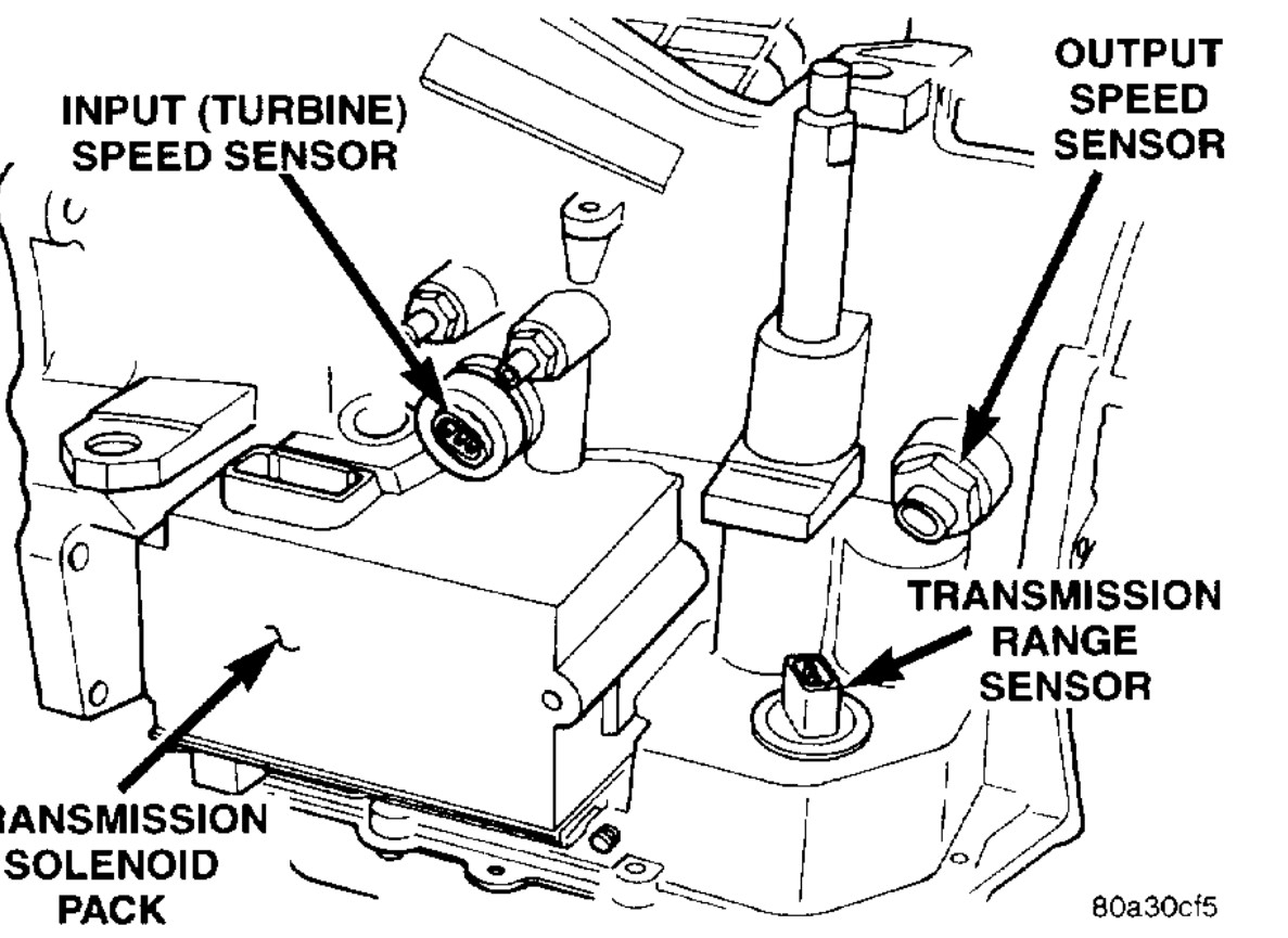

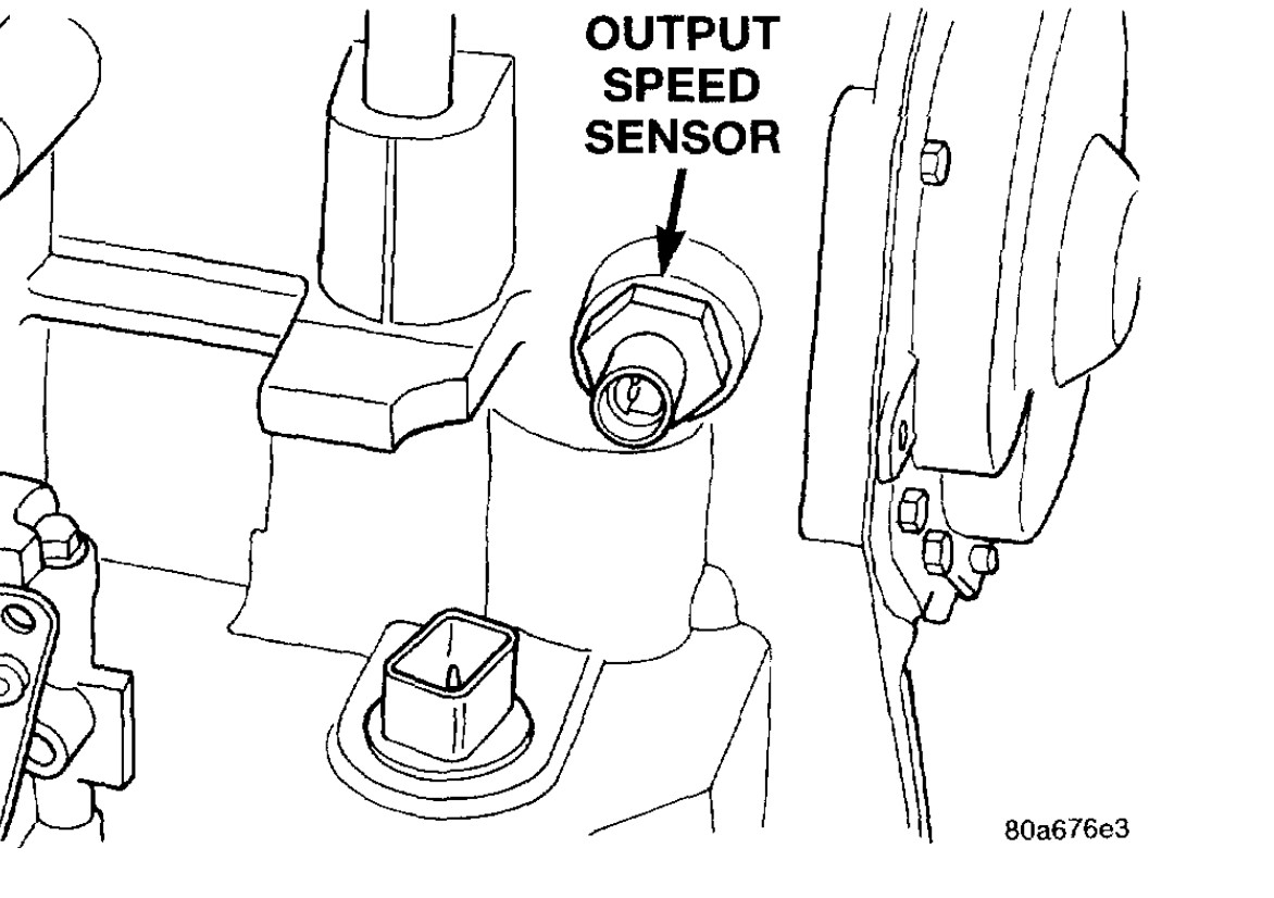

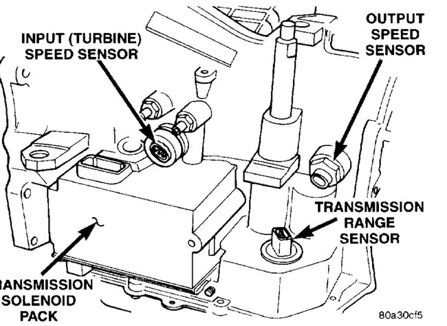

Where are the Input and output speed sensors located and how to replace them?
1999 CHRYSLER TOWN AND COUNTRY
190,000 MILES • 3.8L • V6 • 2WD • AUTOMATIC
VANESSA LYNN MOREHOUSE
Where they are located and how do you change them?
Oct 14, 2023 at 12:00 AM
STEVE W.
  • 15,113 POSTS
They are both on the exterior of the transmission near the manual shift shaft. Both screw into the housing. To change them you unplug the electrical connector (be sure the seal for the connector comes out when removed) Then you unscrew them and screw in the replacements. Tighten to 20 ft lb. Reconnect the wiring and you are done. What is the issue you are having?
