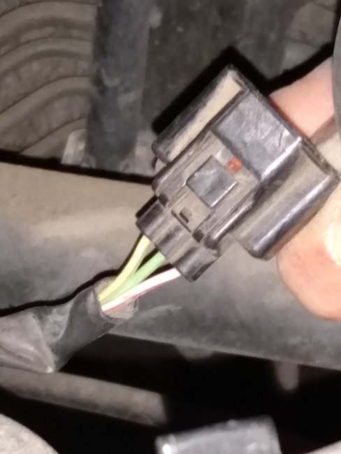

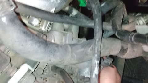

I think I found it but I doubt it's the input because shouldn't it be after the torque converter?

Here is evidence:

There seems to be 2 speed sensors on this model, one is inside the transmission and one outside. It should be a 2 wire sensor not 3.
