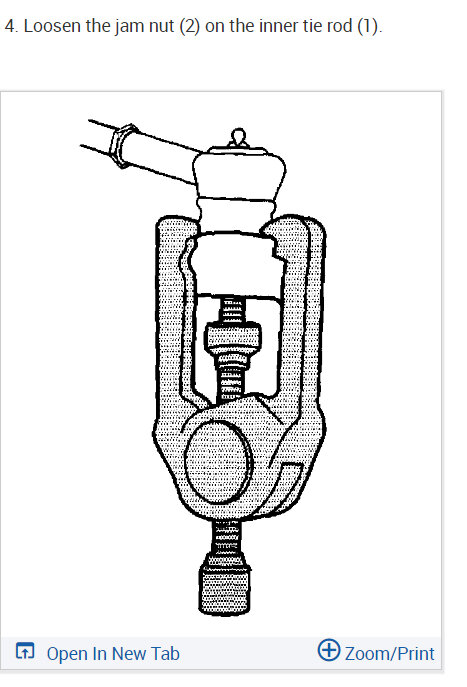

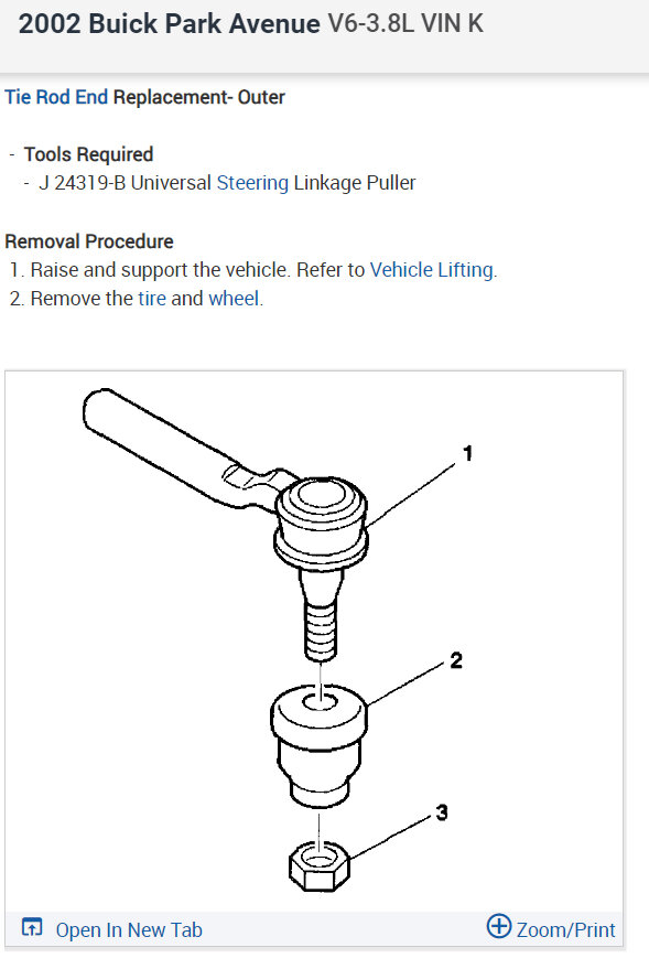

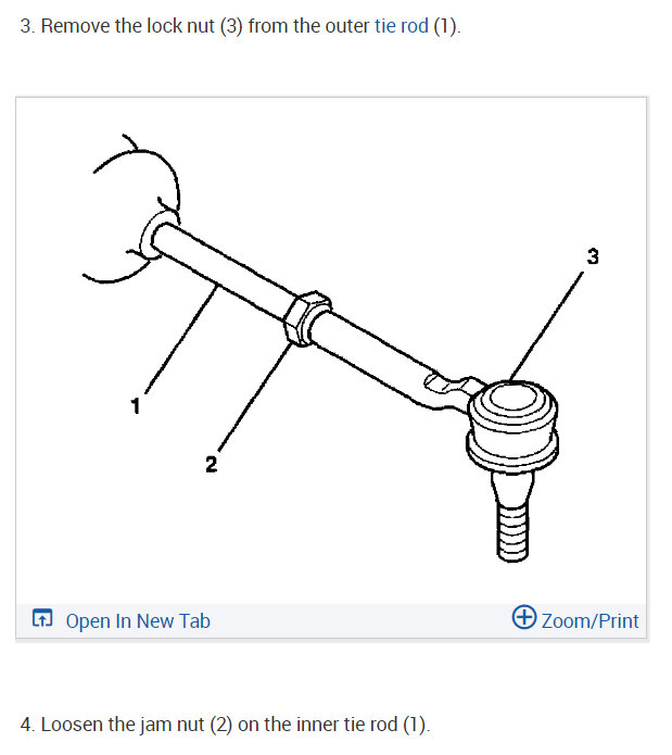

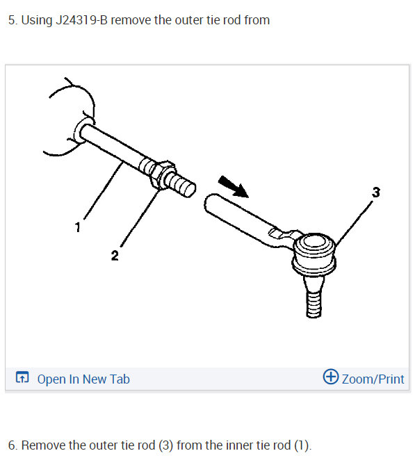

Can you upload an image of what the problem is? Tie rods usually do not go out that fast. Does it have a Zirk fitting? Here is how the outer tie rod end is replaced correctly. Check out the images (below). Please let us know what happens.
Sep 1, 2024 at 12:16 PM

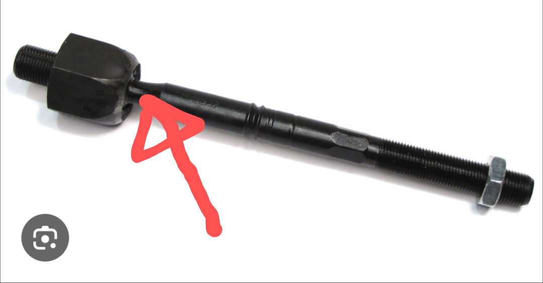

It is the inner tie rod that keeps giving out. This is the part that keeps giving out. It has in and out play. At first i thought it was just the part but i have tried 3 different ones and they all get that play in there which gives the tire the wobble.
Sep 1, 2024 at 12:36 PM
