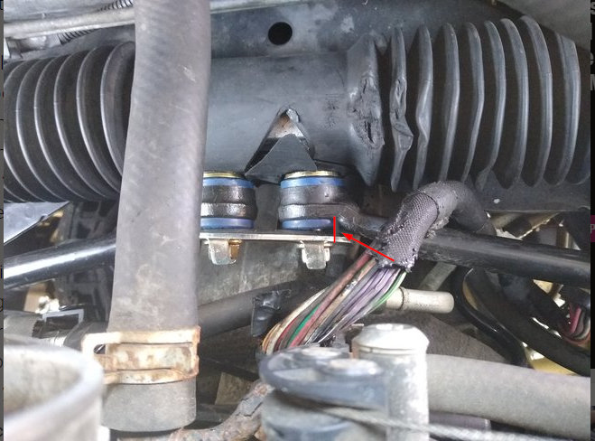

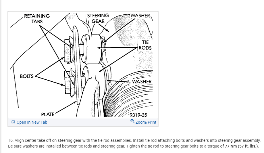

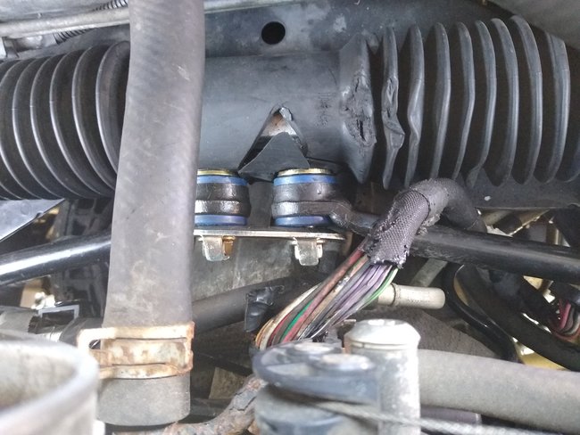

Hi Experts,
I just replaced Inner tie rod gaskets at the steering gear.
Used Moog kit # K7408.
I made the mistake of not doing 1 bolt at a time.
When I threaded in left - driver's side bolt I may have cross threaded?
Since the bolt does not go in all the way.
I backed it out and tried again. Underside of bolt still does not seat against plate.
See images.
I tried torquing to 60 ft pounds but my wrench never clicked. It may be bad.
What do you think?
