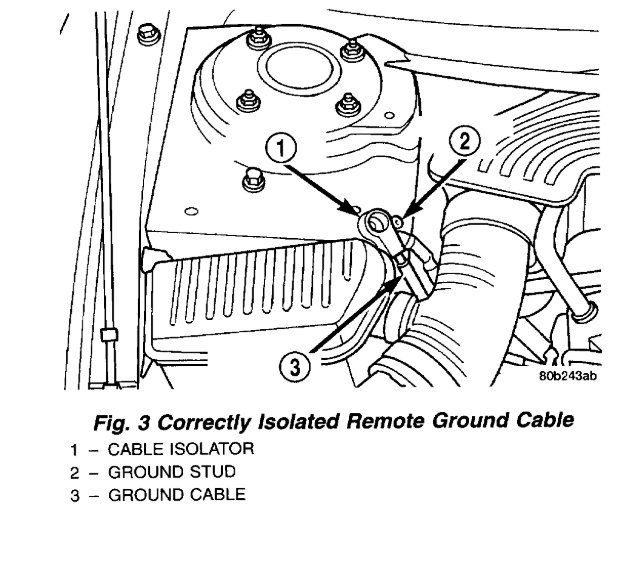

1. Remove the battery ground cable from the ground stud on the shock tower and isolate the ground cable by installing the cable isolator on the ground stud.

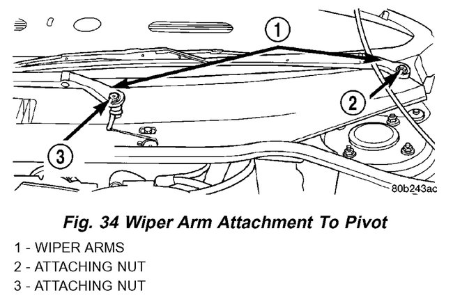

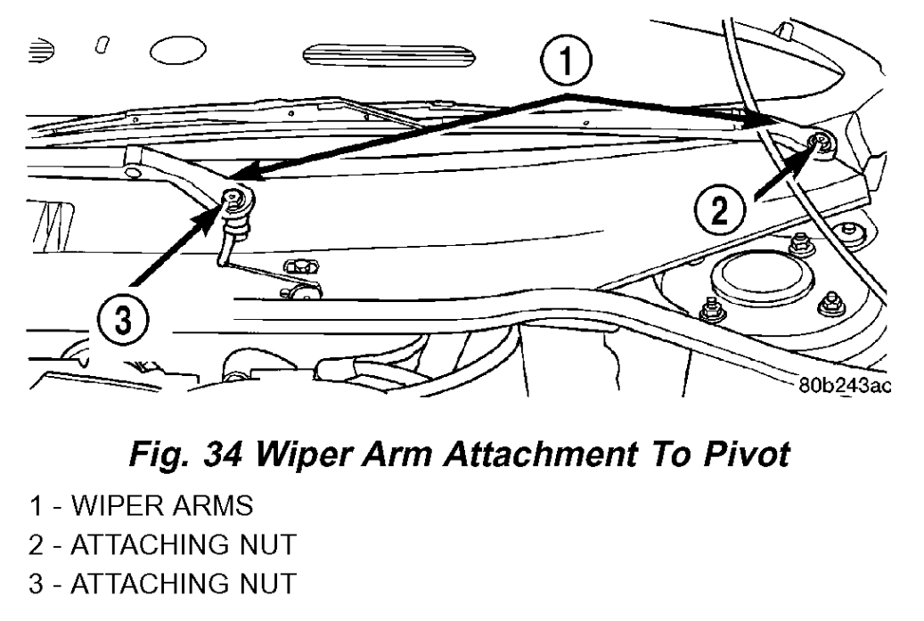

2. Remove caps from both wiper arms at the attachment to the pivots to expose the wiper arm attaching nut. Remove the nut attaching each wiper arm to its pivot.
3. Remove the wiper arms from the pivots. Wiper arms are removed from the pivots by rocking them back and force on the pivots until they can be pulled off the pivots.

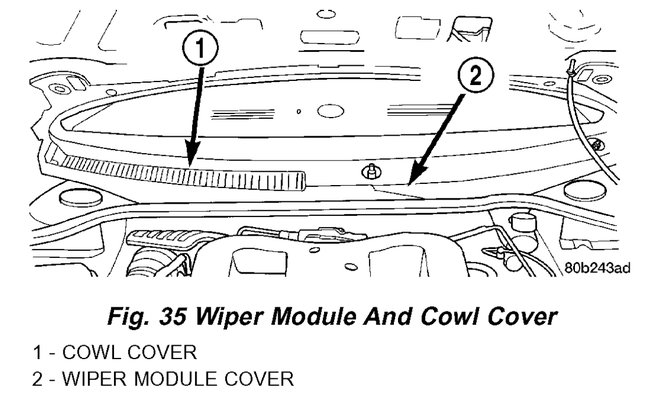

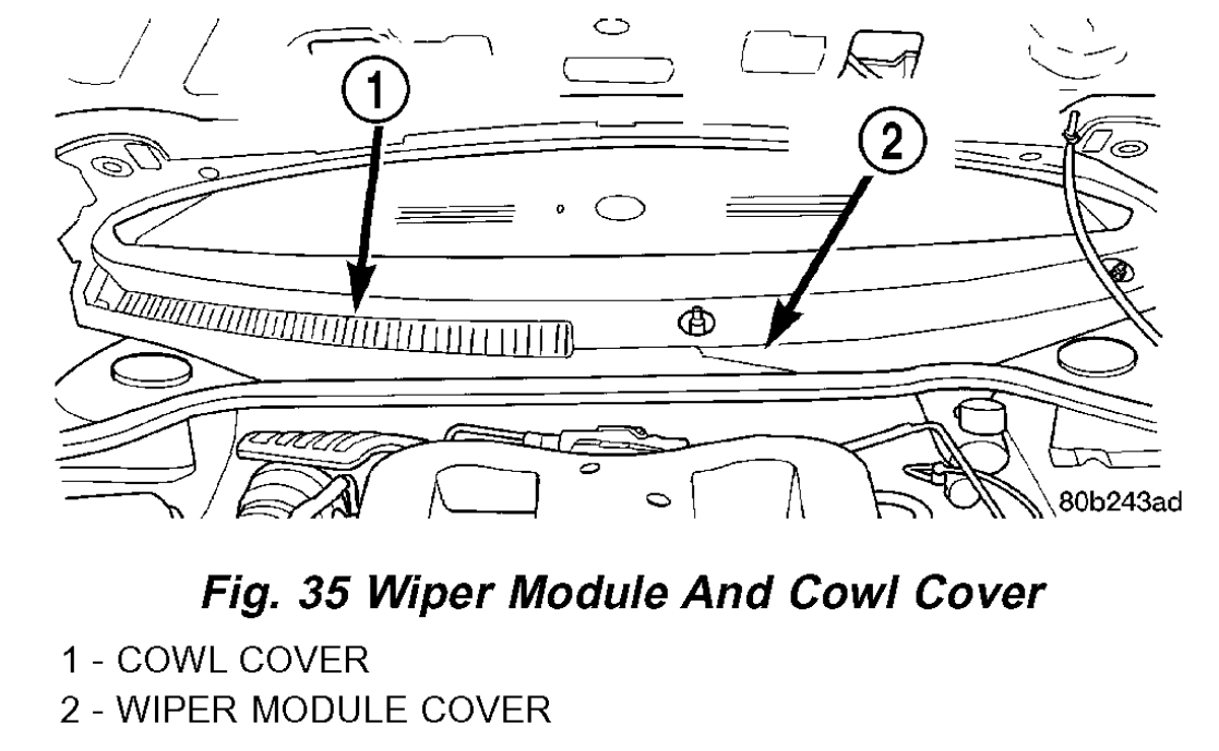

4. Remove the wiper module cover and cowl cover from the vehicle.

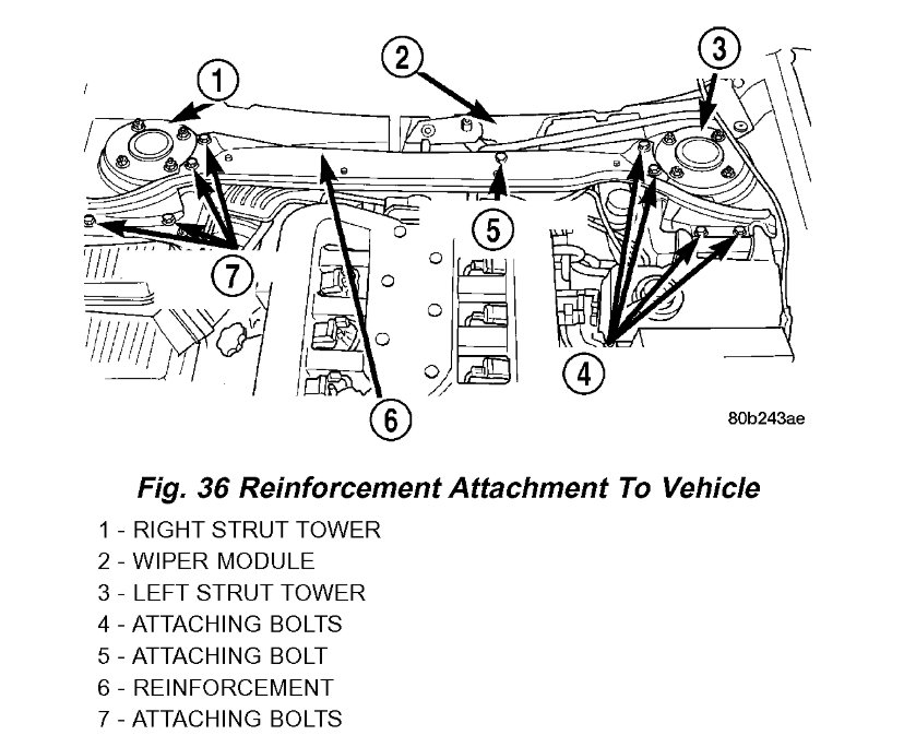

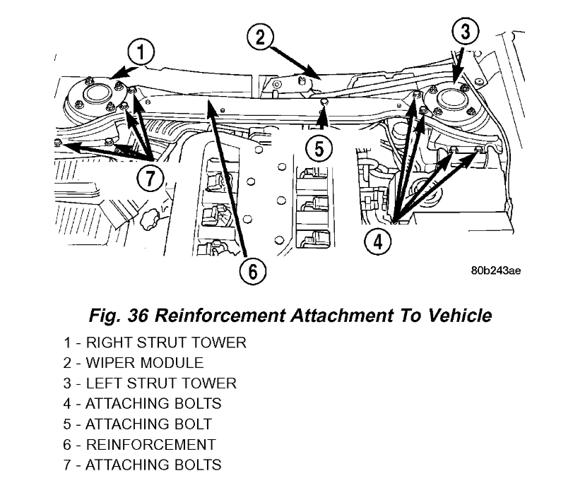

5. Remove the 8 bolts attaching the reinforcement to the strut towers and the 1 bolt attaching the wiper module to the reinforcement. Remove the reinforcement from the vehicle.

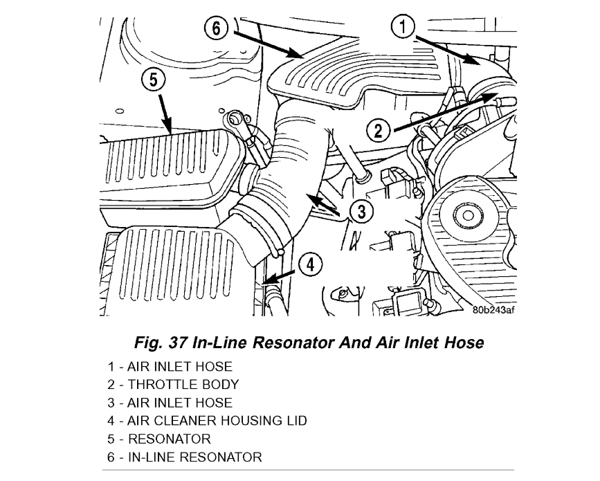

6. Remove the in-line resonator and inlet hose from the throttle body and air let hose coming from the lid of the air cleaner housing.

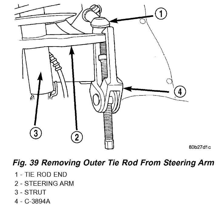

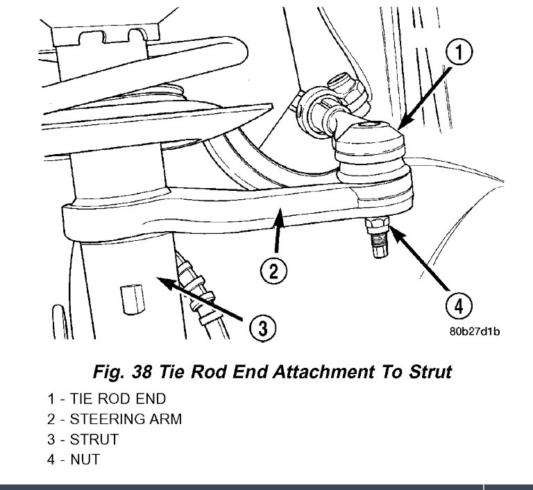

9. Remove the nut attaching the outer tie rod end to the steering arm on the strut.
10. Remove the tie rod end from the steering arm of the strut using Puller, Special Tool C-3894-A.

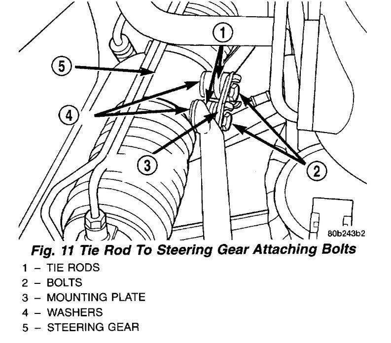

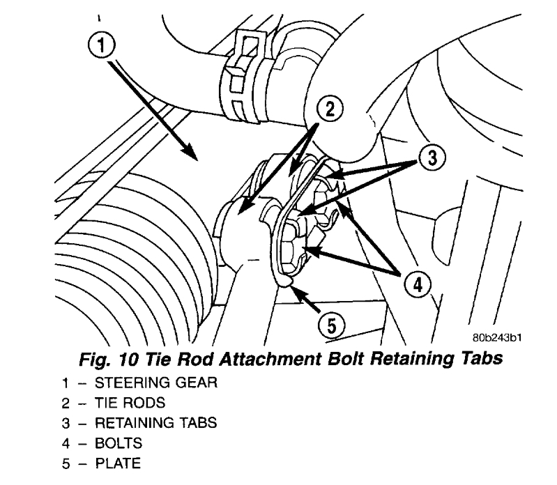

12. Bend back the retaining tabs on the mounting plate for the tie rod to steering gear mounting bolts.
13. Remove the bolt fastening the inner tie rod requiring service to the steering gear. Be careful not to loose the washer behind the tie rod.
14. Loosen the bolt fastening the opposite inner tie rod to the gear, but do not fully remove it.
15. Rotate the loose end of the mounting plate out of the way.

3. Install the outer tie rod on the steering arm of the strut. Install the tie rod steering arm nut. Do not tighten the nut at at this time.
CAUTION: Before installing tie rod on steering gear be sure the tie rod spacer block inside the steering gear bellows (boot) is correctly aligned with the bolt holes in the rack of the steering gear and the steering gear bellows.
4. Align the inner tie rod with the mounting hole in the center take off on steering gear. Rotate the mounting plate into position over the tie rod. Install tie rod attaching bolt through tie rod and washer into steering gear. Be sure washer is installed between tie rod and steering gear as shown. Tighten both tie rod to steering gear bolts to a torque of 100 Nm (74 ft. lbs.)
5. Bend retaining tabs against heads of tie rod attaching bolts.

7. Tighten the outer tie rod steering arm nut to a torque of 37 Nm (27 ft. lbs.).

10. Install the in-line resonator and inlet hose on the throttle body and air inlet hose coming from the lid of the air cleaner housing.
11. Install the reinforcement on the vehicle. Install the 8 bolts attaching the reinforcement to the strut towers. Install the bolt attaching the wiper module to the reinforcement
12. Install the covers over the wiper module and the cowl. Install and securely tighten the attaching screws.
13. Install the wiper arms on the pivots. Install and securely tighten the wiper arm to pivot attaching nuts. Install the caps on the wiper arms covering the pivot nuts.
14. Install the battery ground cable onto the ground stud on the shock tower and install nut.
