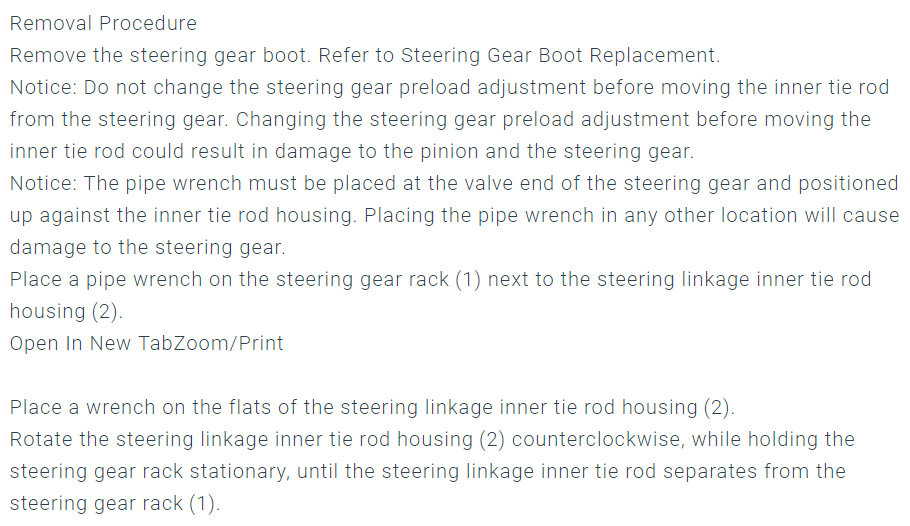

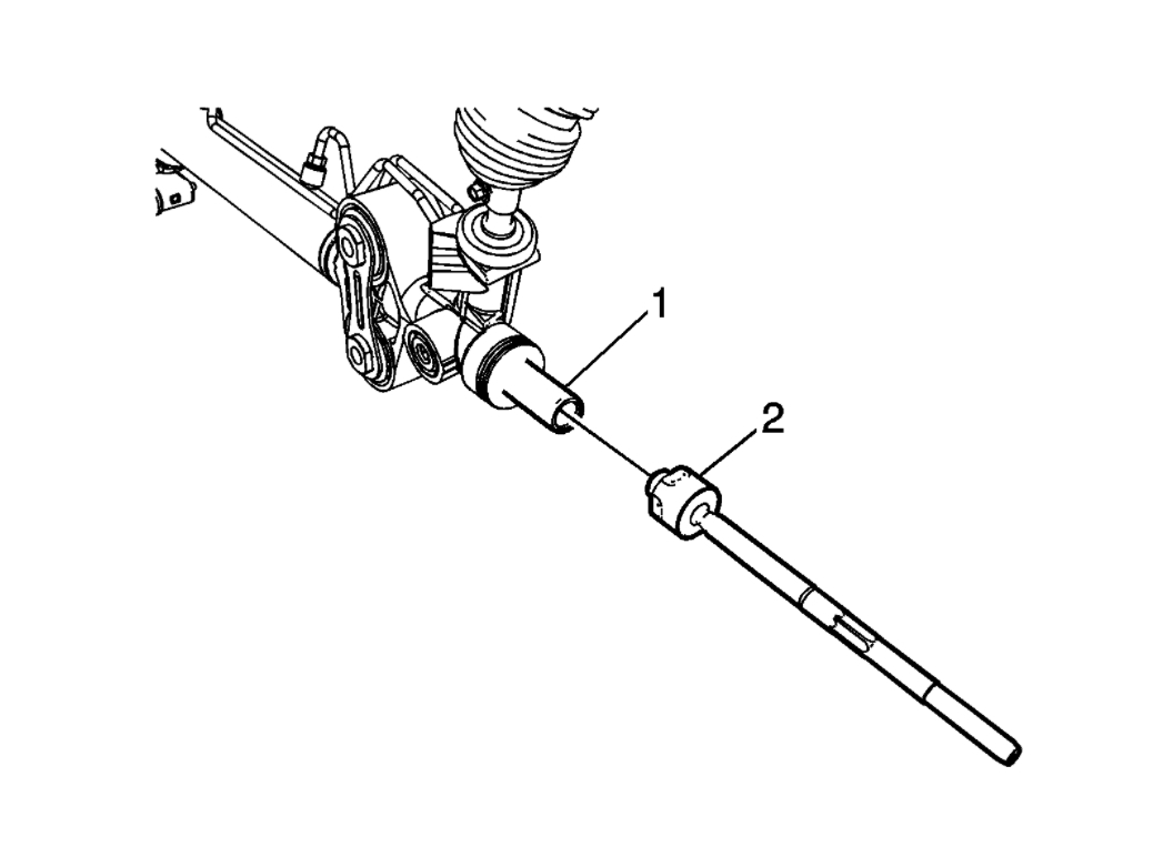

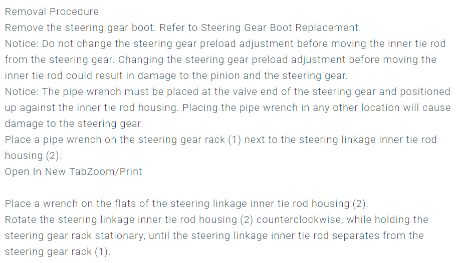

Yes, it does. I attached a picture and the procedure for you of the repair.
https://www.2carpros.com/articles/tie-rod-end-replacement
It is the same for both sides.
