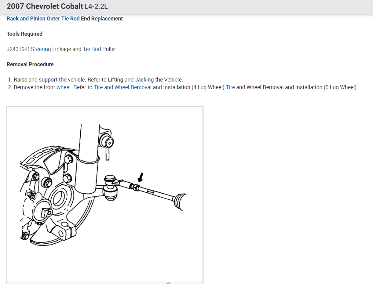

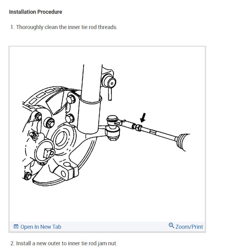

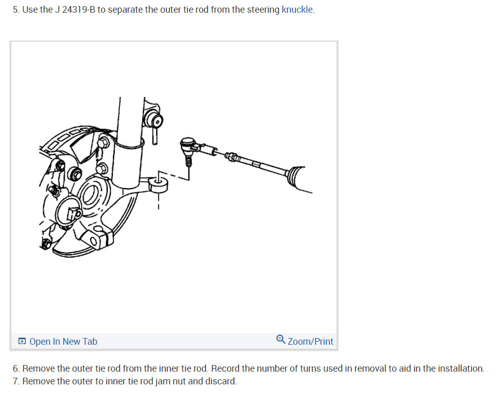

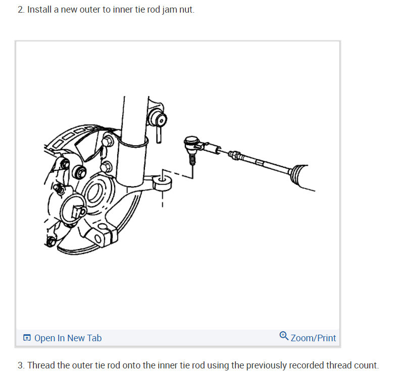

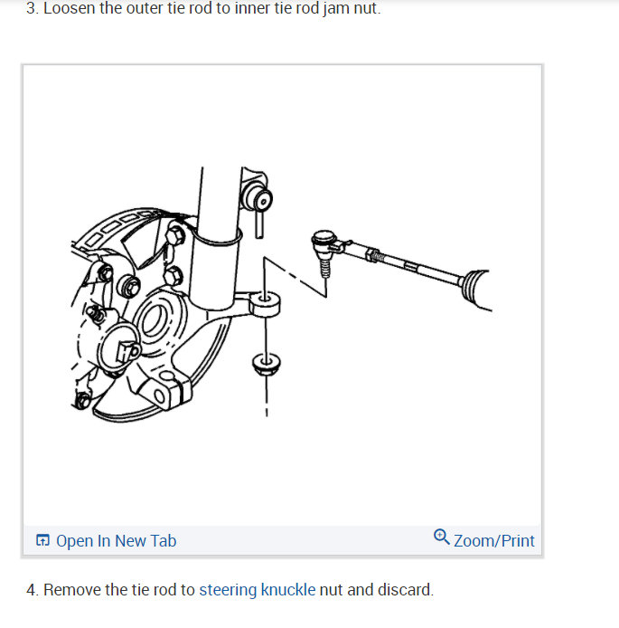

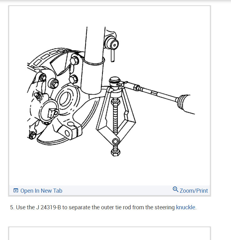

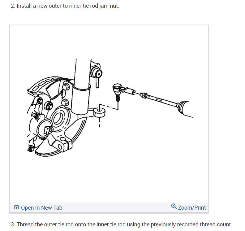

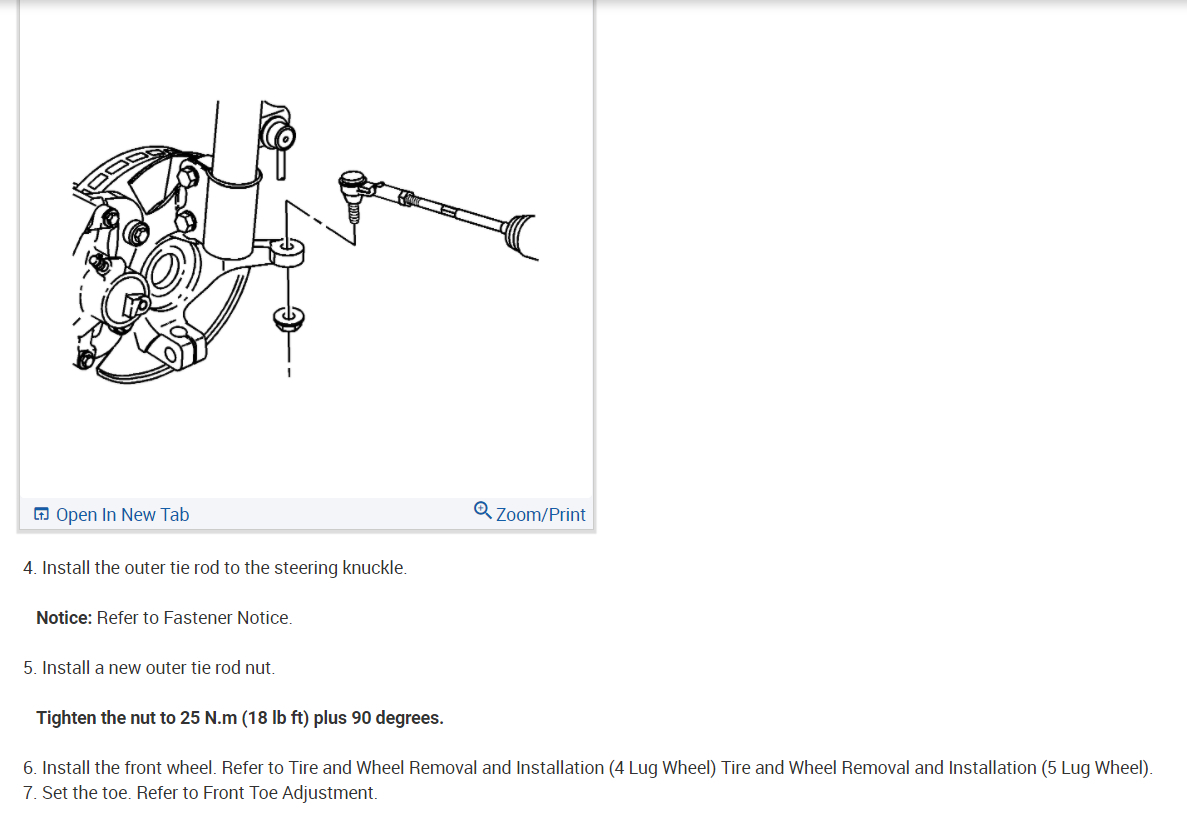

Here is the tie rod end torque secs plus a guide to help walk you through the job with instruction in the diagrams below to show you how on your car.
Install a new outer tie rod nut.
Tighten the nut to 25 N.m (18 lb ft) plus 90 degrees.
https://www.2carpros.com/articles/tie-rod-end-replacement
