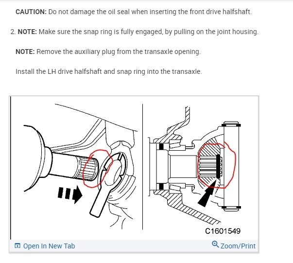

There is a snap ring on the end of the axle that keeps the axle from popping out.
https://www.2carpros.com/articles/replace-cv-axle
If it is missing or too compressed, it will not lock into the transaxle to prevent the axle from falling out.

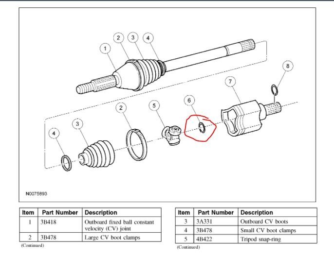

The inner part of the joint.
I attached a picture and circled the ring for you.
Oct 26, 2021 at 4:10 AM

that is attached .
Oct 26, 2021 at 5:06 AM
BMOKHOSI
  • 10 POSTS
from the image the whole thing pops out but 7 stay attached to the gearbox 6 stay attached to the shaft only break tripod rings (5).
Oct 26, 2021 at 5:10 AM
Then there is too much movement.
Is this a replacement axle shaft of the original shaft?
Oct 26, 2021 at 5:43 AM
