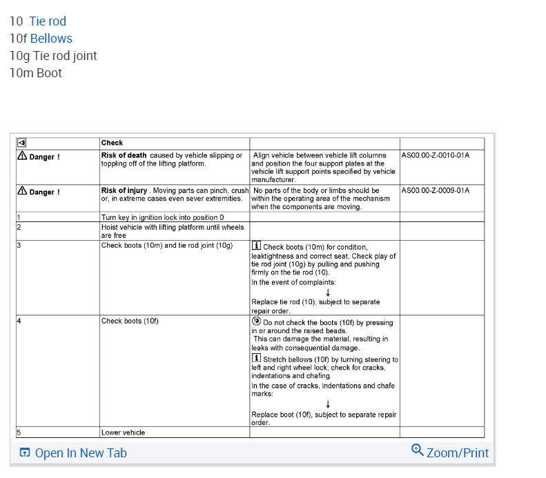

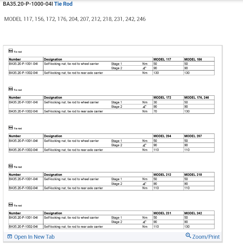

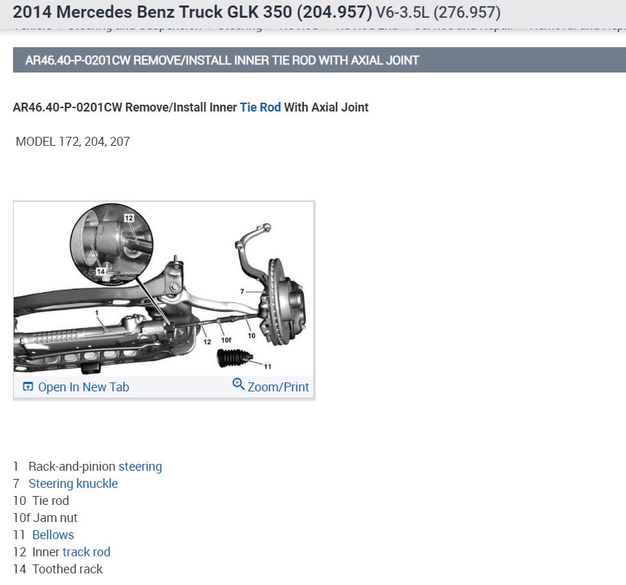

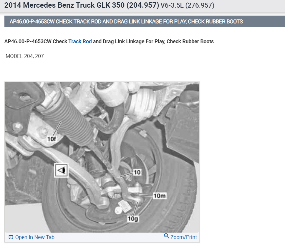

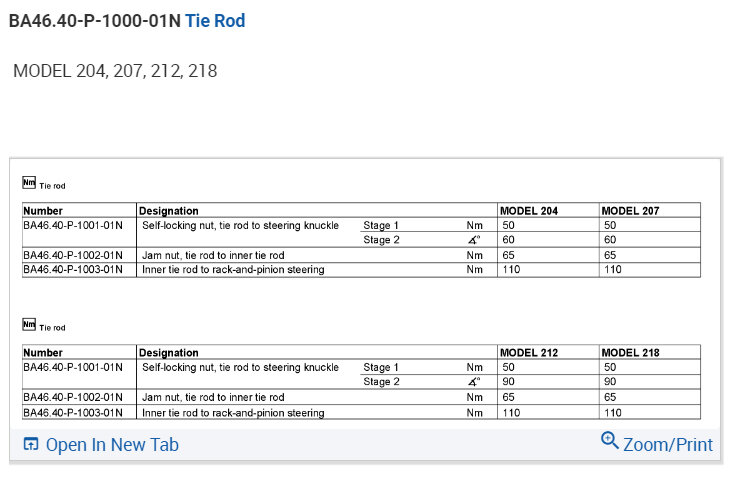

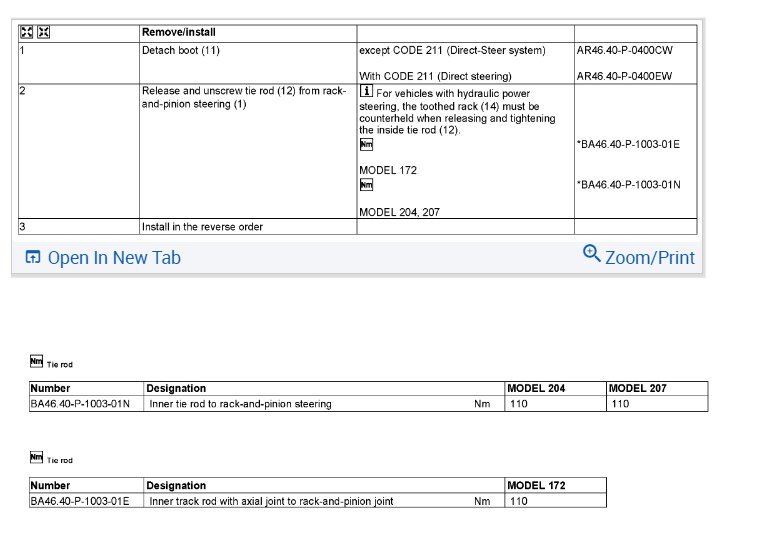

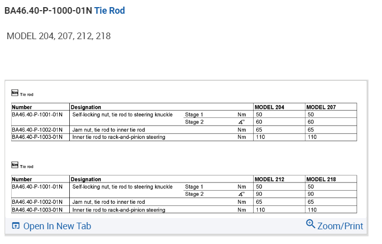

Not necessarily a problem. Just seeing if you guys could provide torque for the procedure. Specifically, inner to steering rack, inner to outer nut, and outer to wheel nut. Thanks a lot!
