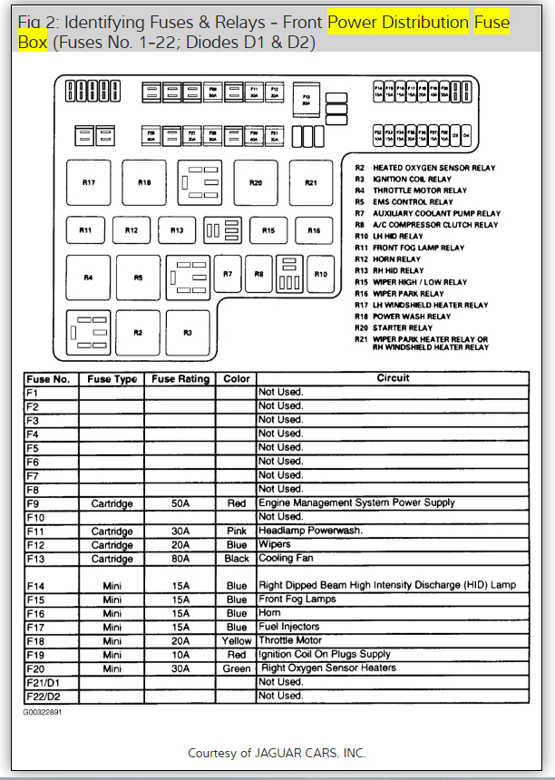

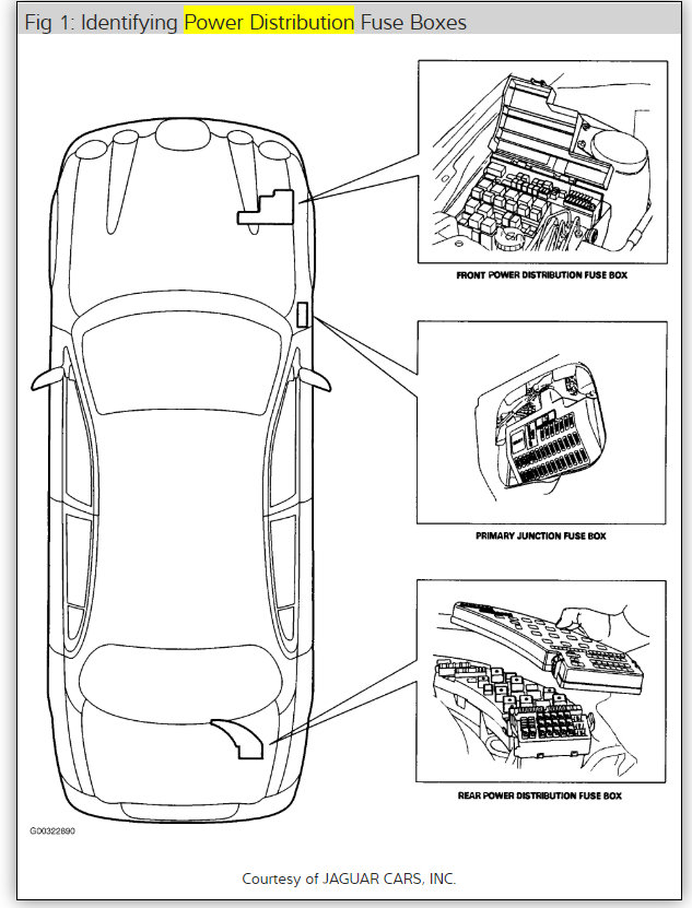

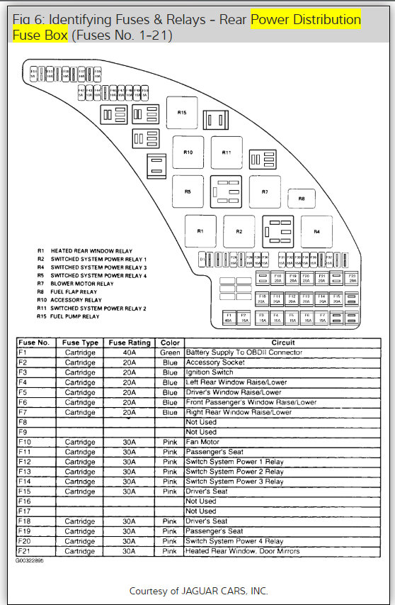

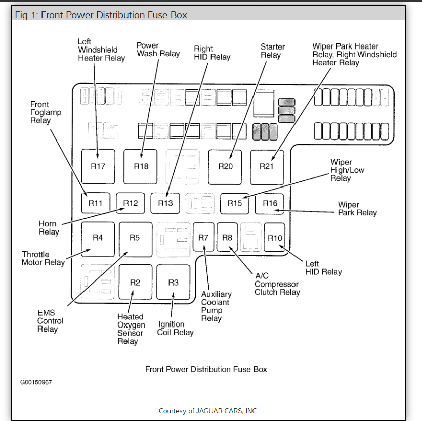

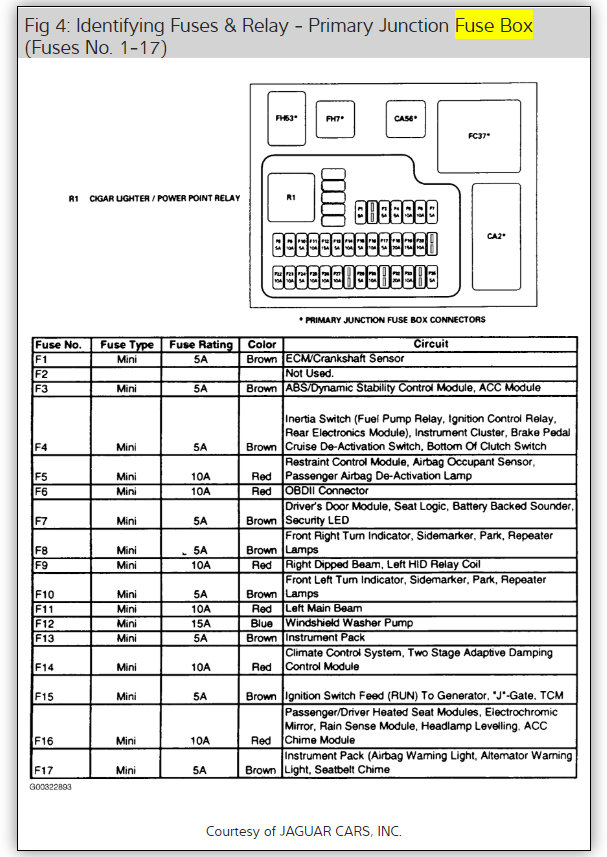

There is no way to bypass the security in the car. can I ask if the security light is flashing? You could have had a voltage surge when the battery was replaced so we need to check the fuses. here is a guide and the fuse locations in the diagrams below:
This guide can help as well:
