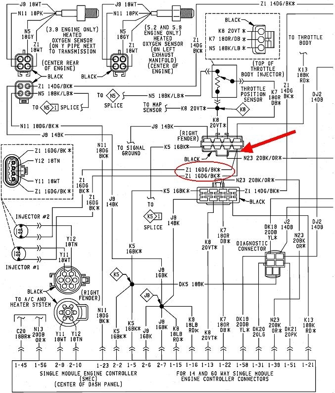

So, to say your TPS won't cause your crank / no-start isn't exactly true, but it is very unlikely. When you look at it on a scanner, this type of sensor is fed with 5.0 volts and there's 0.2 volts on its ground wire. There's mechanical stops inside the sensor that limits its range of signal voltage from 0.5 volts at idle to 4.5 volts at wide-open-throttle. Those numbers are for training purposes. In actual practice you're going to find typical values of perhaps 0.62 volts at idle to 4.2 volts at wide-open-throttle. The exact numbers are irrelevant and will vary between sensors. The point of value here is the only way the signal voltage can go to 0.0 volts is if there's a break in the 5.0-volt feed wire or terminal inside the sensor, and the only way it can ever reach 5.0 volts is if there's a similar break in the ground wire or inside the sensor. Those are two of the conditions the computer can detect, and it's by those readings outside the 0.5 to 4.5 volt range that set diagnostic fault codes.
The TPS on my van never went outside the acceptable range, so it never set a fault code. To add to the misery, I can't get the sensor to stick with it off the engine.
For the benefit of anyone researching this topic, there is a third condition that can be detected and set a fault code. That is a break in the signal wire or that terminal inside the sensor. Due to the interconnected circuitry inside the computer, that circuit can now "float" to some random value, and as long as it stays within the 0.5 to 4.5-volt range, it won't set a fault code, and the computer will try to run on that reading. To prevent that, all computers use either a "pull-up" resistor or a "pull-down" resistor connected to the signal wire. Chrysler uses mostly pull-up resistors. Those have one end tied to the 5.0-volt internal supply, and the other end tied to the signal terminal. When everything is working normally, that resistor is of such a high value, it has no affect on anything. It's when the signal wire is broken that the resistor puts 5.0 volts onto the signal terminal to force a defective condition that will get detected. In this case, you'll see 5.0 volts on the scanner, but if you measure at the sensor with a voltmeter, you'll find the correct voltage of around 0.5 volts at idle.
Some manufacturers use "pull-down resistors for the same purpose. Those are tied to ground instead of the 5.0-volt supply, so you'll see 0.0 volts on the scanner, which is also a defective condition.
If you want to check your TPS, the readings are only valid when it is plugged in, so you have to back-probe through the rubber seal around the signal wire. That's the wire in the middle of the three. If you find around 0.5 to even as high as 0.7 volts, the circuitry is good. Next, when you open the throttle slowly by hand, that voltage should increase smoothly without popping up intermittently.
