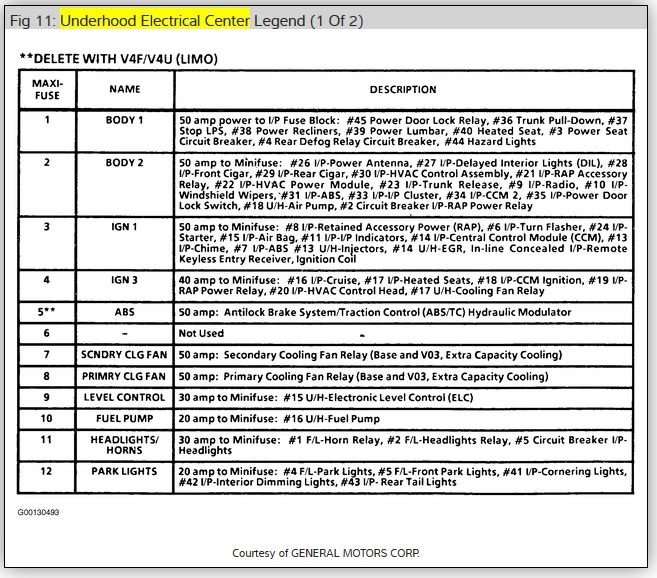

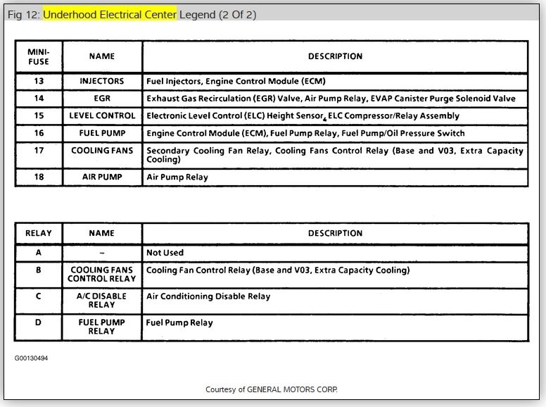

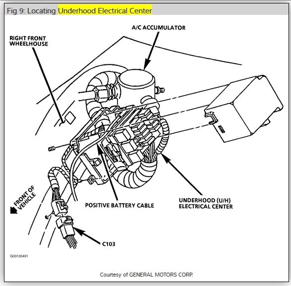

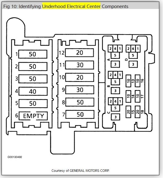

not delivering fuel and pump is good.

In the under hood fuse block there is a fuse for the fuel injectors and ECM. I would check it. I am including pictures to help you find the fuse block and the particular fuse (number thirteen if my memory is right). Take a look at that and let us know.
