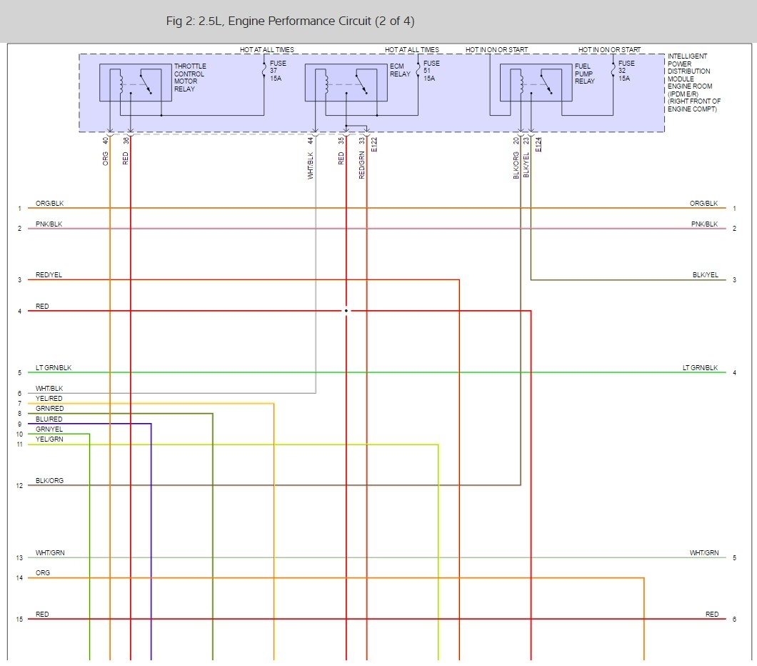

It sounds like you have a ECM relay that has gone bad, here is a wiring diagram that tells you where it is and I will include a guide that will help you test the relay.
Please run some tests and get back to us so we can continue helping you.
Best, Ken
