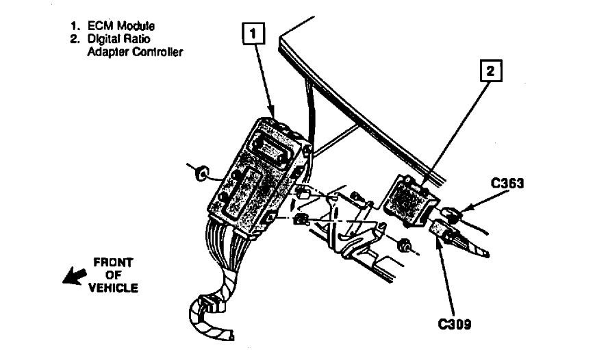

Well I tested the injector when I got to the truck and sure enough it's not getting a ground signal when trying to crank or while the truck is running, so I guess it's on to the ecm, where is it located and how can I test it to make sure before I go get one .
Dec 23, 2019 at 5:50 PM

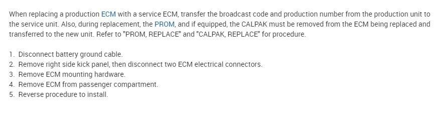

Okay, It is under the right side of the dash. I attached procedure and pictures for you to view.
You cannot test it. It takes special equipment to actually test the internals.

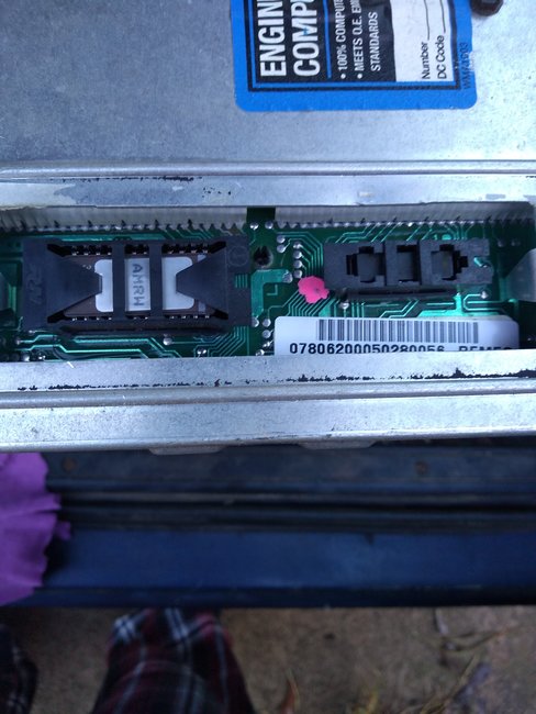

I pulled the ECM out this morning and under the cover I have to different do I need to reuse both or just one?
Dec 24, 2019 at 6:06 AM
Okay, the other is a cal pack. Yes, change that over as well.
