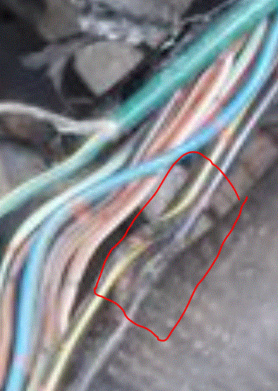

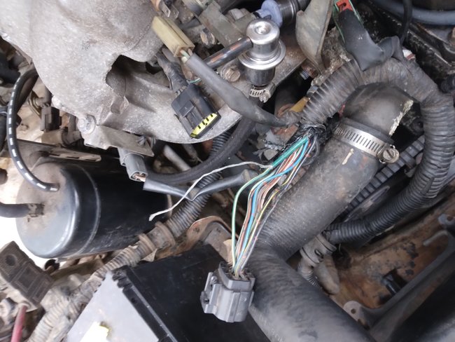

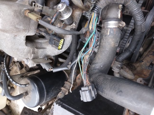

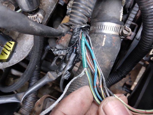

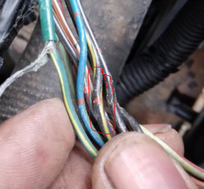

Pictures below show what I found after stripping the injector harness connector wiring, a few of the wires in the harness are 12v hot while switched in the on position, none are hot when switched off. Should this wire be uninsulated and loose in the harness as it is, or should it be connected to something, or ground or left as it is?

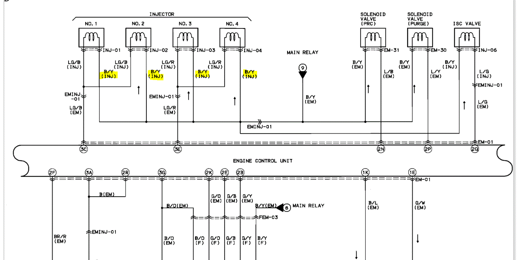

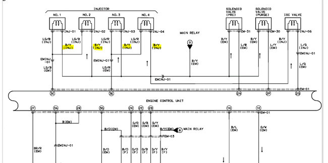

As far as the injectors are concerned, they should receive power once the key is on, and I believe you mentioned that is the case. Once you crank the engine, the ECM should provide a ground path to each injector based on need. If I'm reading the schematic correctly, power is supplied via the black wire with a yellow tracer. I attached a copy of your pic below. Is this where you have the power supply to all injectors?
If you do, the issue is either the ECM isn't providing a ground path. If you have a Noid light, test the light green wire with a black tracer on injectors 1 and 2 to see if power is continued to the ECM's ground. Do this cranking the engine. Also, injectors 3 and 4 should receive a ground path via a light green wire with a red tracer. Check them all.
If you want, you could check for continuity to ground with a multimeter as well when cranking the engine.
I attached your pic below along with a schematic of the injectors for your reference. Also, if you haven't already, I recommend testing for diagnostic trouble codes. The vehicle has an OBD1 system and all you need to retrieve codes is a short jumper wire or even a paper clip. Here is a link that shows how to do it.

Let me know what you find or if I can help. Also, inspect some of the wires you indicated in pic 1 you sent. Some look like they could have internal damage (under the insulator). Also, which wire are you referring to in your pics as loose or disconnected?
Pic 3 shows the wires I noticed appeared damaged. Inspect them closely.

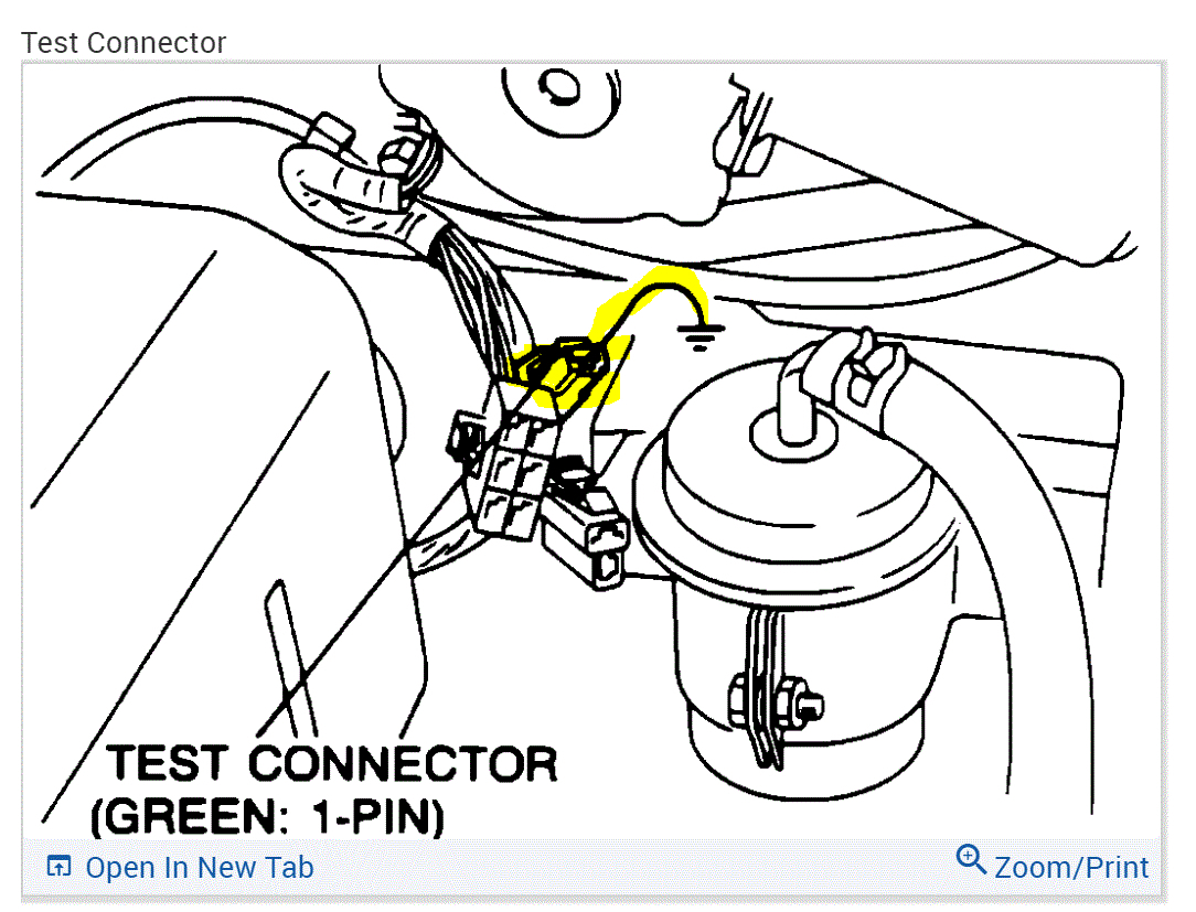

No, the diagram of the OBD1 connector you sent is different from the one I found on my truck. My truck has a 4 or 6 pin green diagnostic connector on the passenger side under the hood, with a yellow 2 pin diagnostic connector along with it. Could you send me the diagram if you have it to check codes on this one, I described if you have it. My truck is a 4x4 manual transmission, 2.6 liter, 1989 B2600i. The 4x4 might be the difference I'm guessing. Thanks.

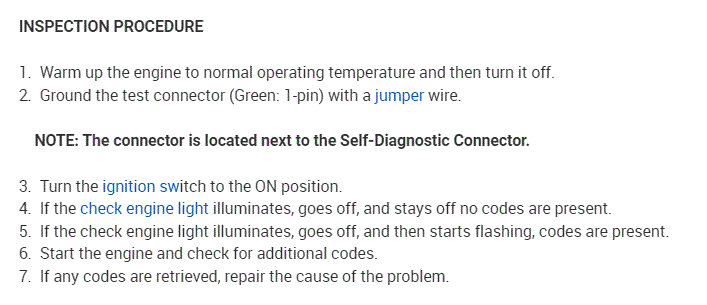

By chance, is there a single-pin green connector located there? If there is, you will ground that connector using a jumper cable.
See pic 1 below. It shows what I believe you have. Pic 2 is the directions from the manual for testing.
Let me know what you find.
