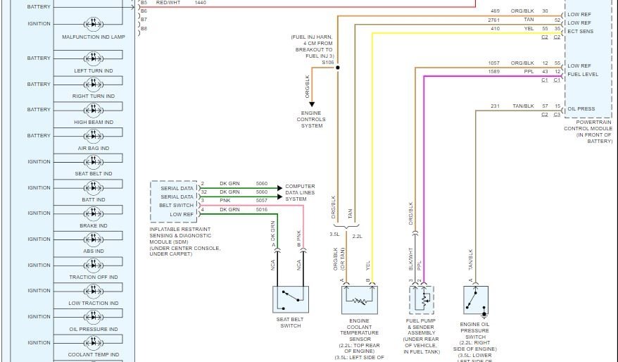

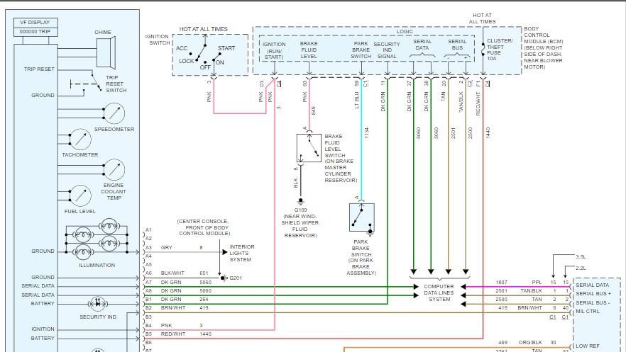

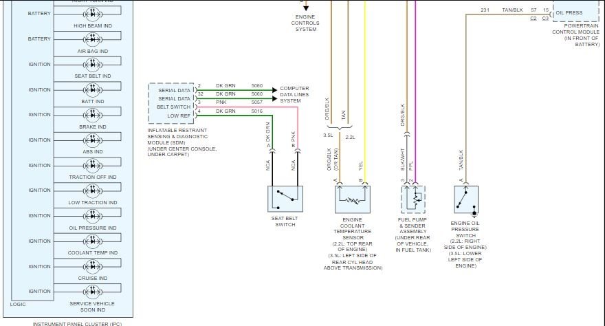

I have attached the entire wiring schematic for the instrument cluster. I had to break it into three parts because of its size. However, I overlapped each picture so you can follow it.
Let me know if this is what you needed or have other questions.
