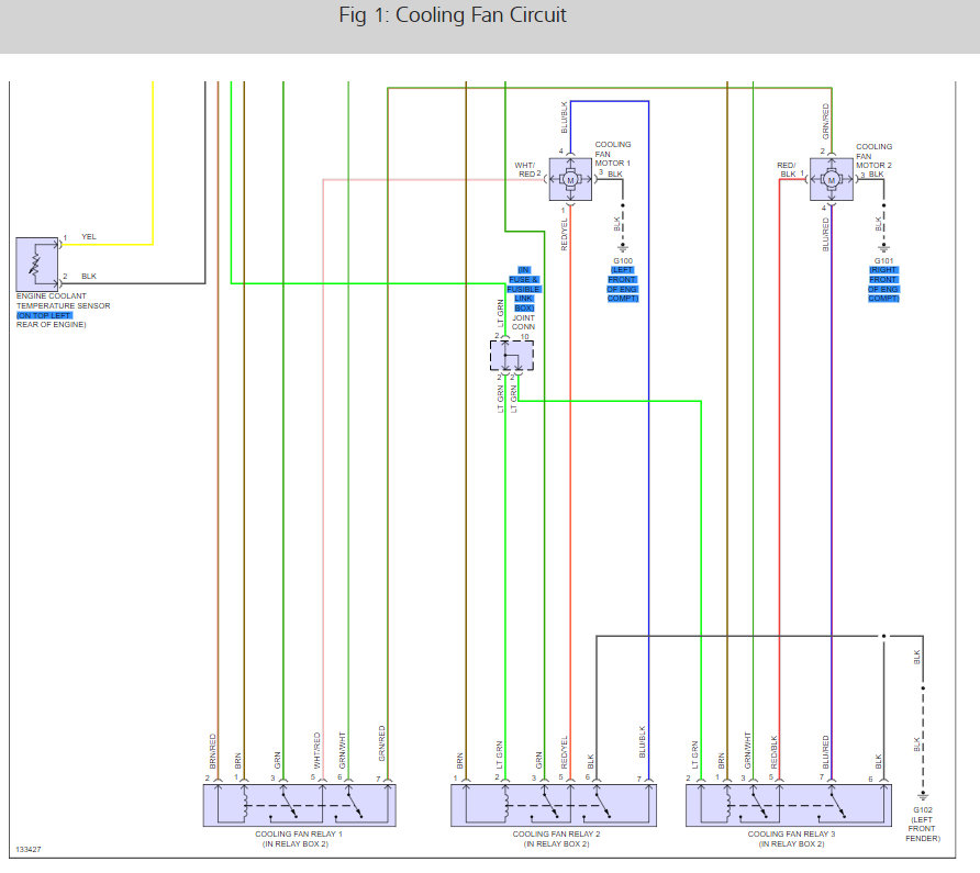

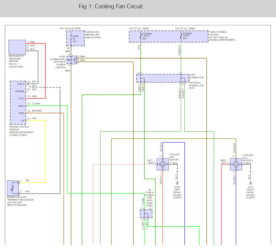

when i turn the ac on the fan does not turn on at any point and if sitting in traffic car begins to run hot. the main fan does run as its supposed to. can it be the fan relay under the hood? there are three of them labeled fan relay 1, 2 and 3. thanks
