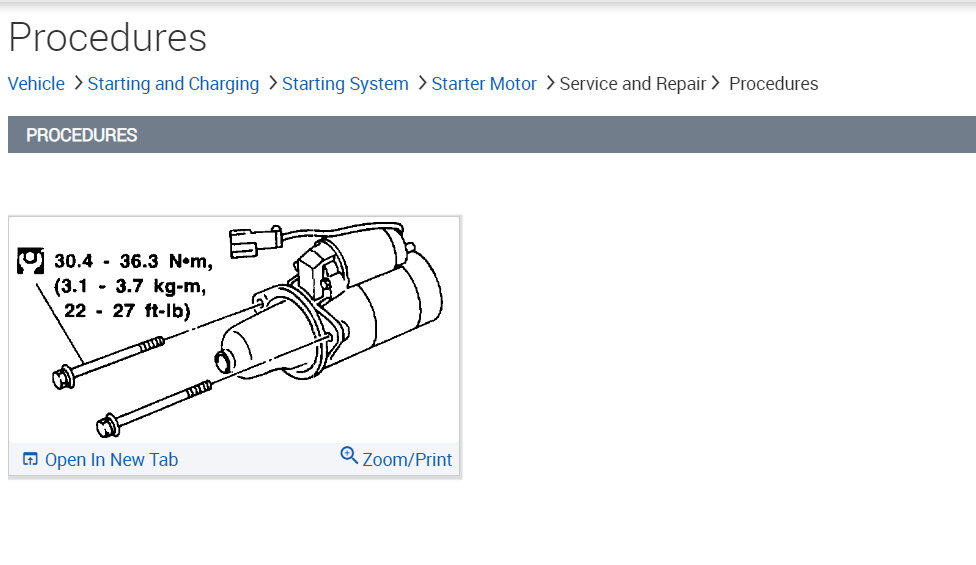

remove air cleaner, locate starter bolts from the topside, raise up vehicle, remove wires, remove. Here is a generic guide that will help you walk through the repair with instruction below to help you with your car.
Check out the images (Below). Please let us know if you need anything else to get the problem fixed.
Mar 5, 2010 at 2:04 AM
Start by disconnecting the battery and raising the car up safely. Here are three guides that will help you get the job done by seeing what you are in for when fixing your car.
and
and
Remove or disconnect the following:
Negative battery cable
Starter insulator
Starter harness connector and cable
Starter mounting bolt and nut
Starter
To install
Install or connect the following:
Starter. Torque the bolts to 27 ft. lbs. (36 Nm). Starter harness connector and cable
Starter insulator
