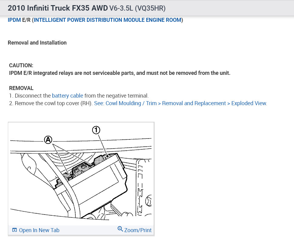

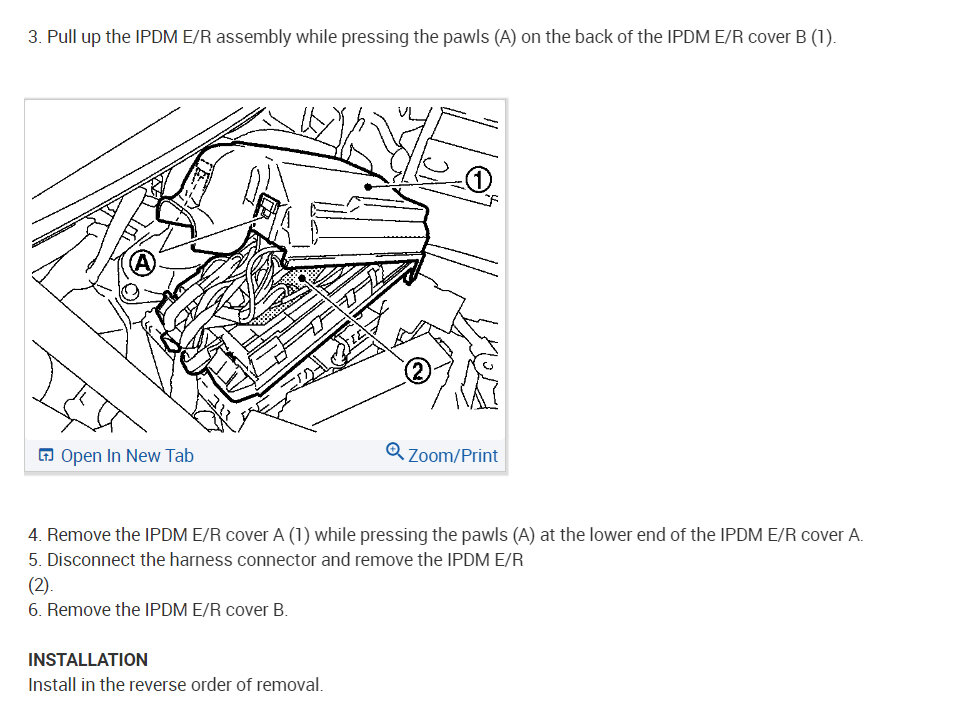

Yep, this happens when the IPDM goes out which is common when electrical surge issues occur. To confirm the issue, we should do a CAN scan which is easy. You can get a CAN scanner (Controller Area Network) from Amazon from about $32.00.
Here is a video to show you how:
https://youtu.be/u-4syLc-ifQ
and
https://www.2carpros.com/articles/can-scan-controller-area-network-easy
Amazon CAN scanner Link.
https://amzn.to/3G7mpFP

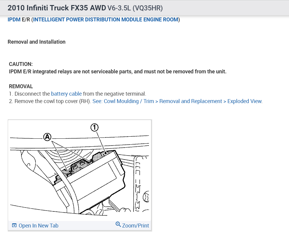

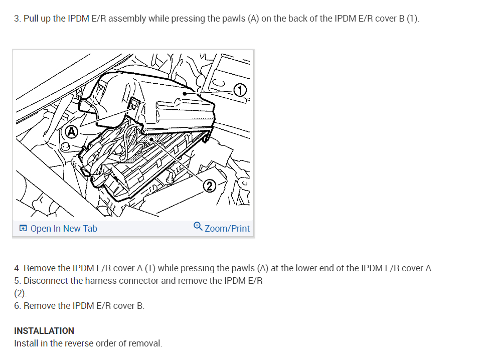

To replace the IPDM is easy as well because it-self learns. I have included the location and instructions on how to do the repair in the images below. Check out the images (below). Please let us know what happens.
