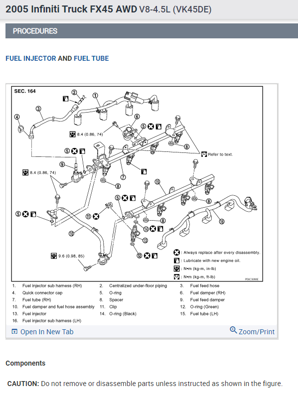

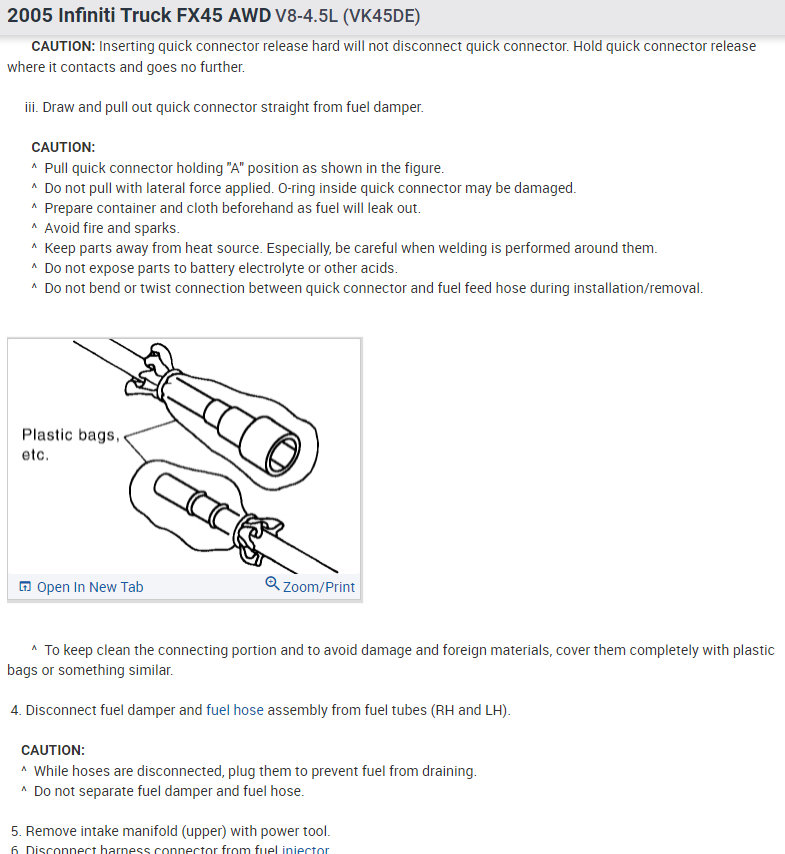

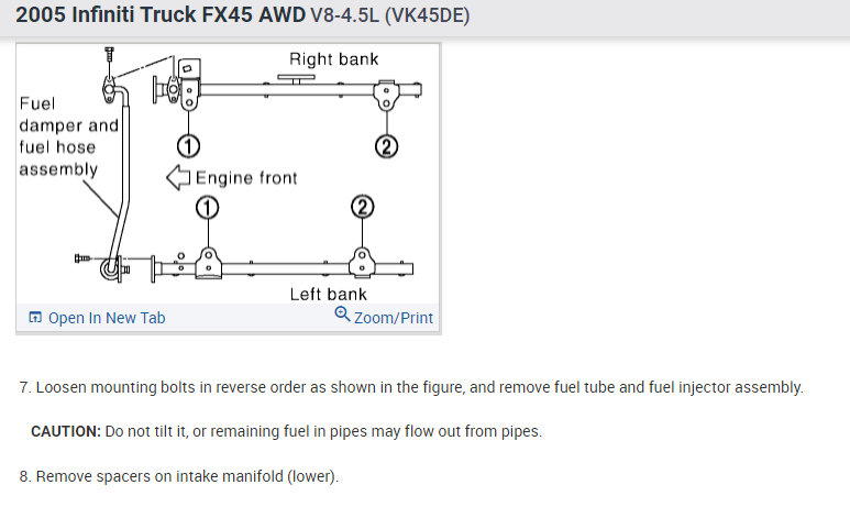

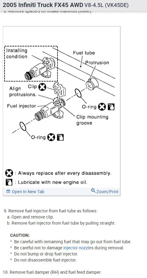

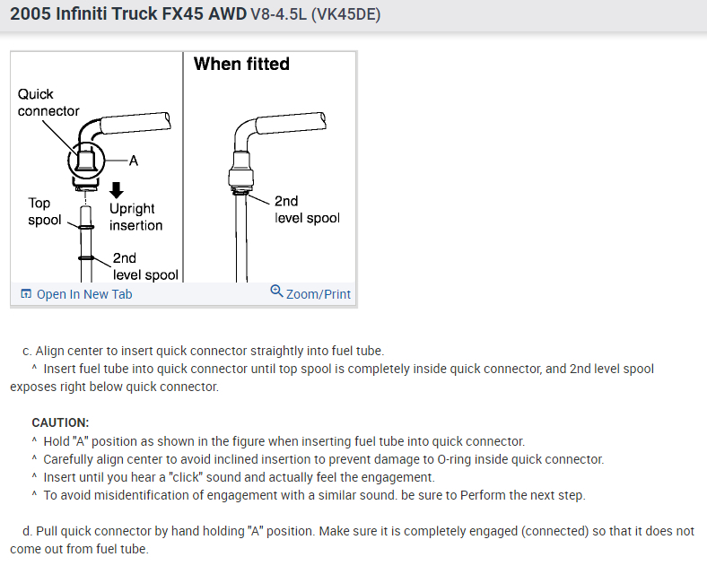

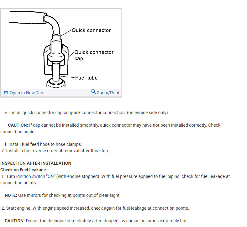

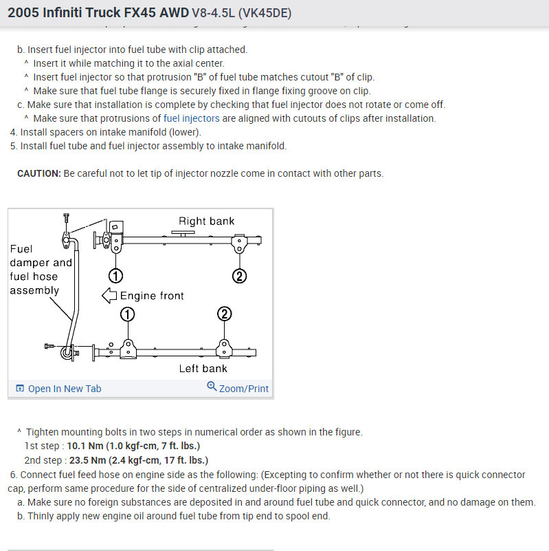

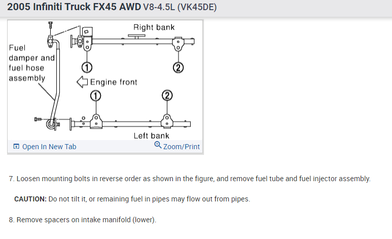

First do an inspection of under hood fuel components. Check the fuel rails and the fuel regulator. Look for any leak or damage to the components.
Also it will be a good idea to scan the vehicle for any trouble codes. Typically with a bad catalytic converter the check engine light will be illuminated.

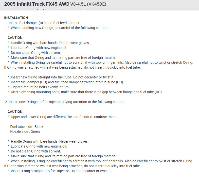

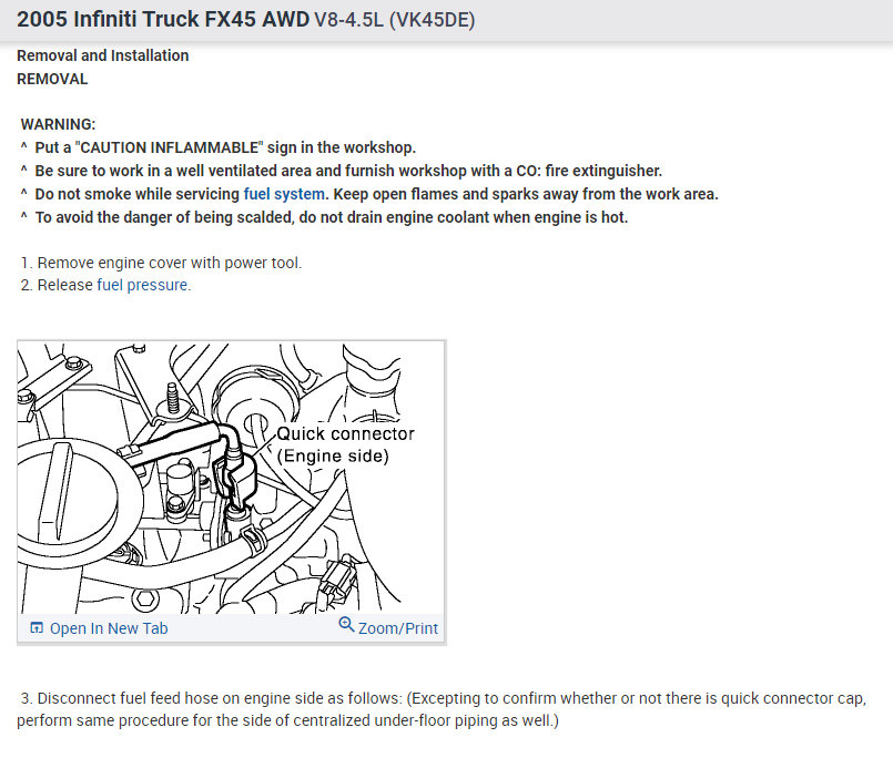

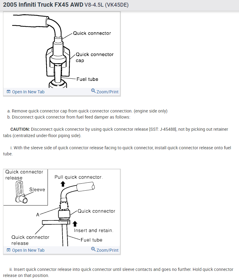

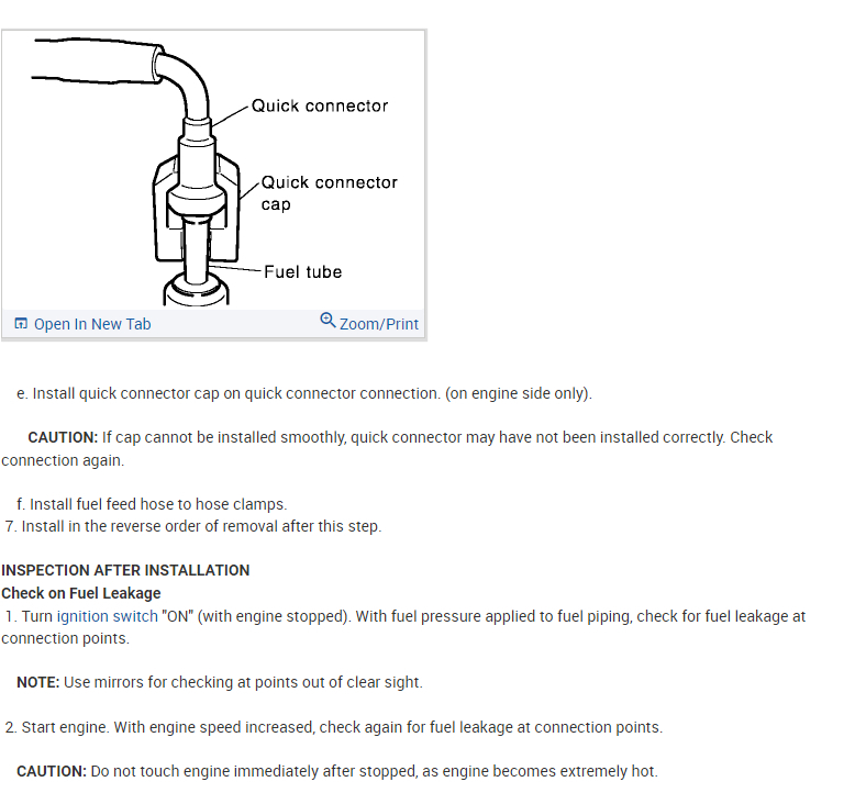

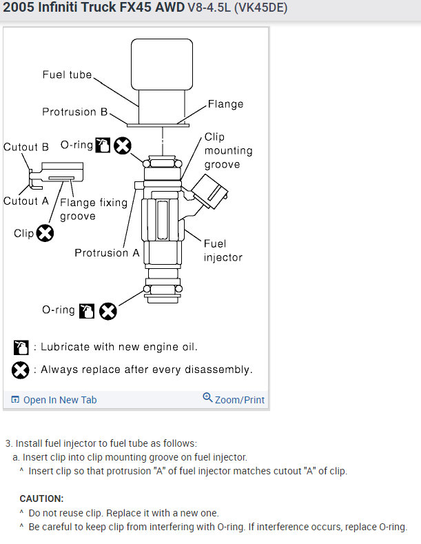

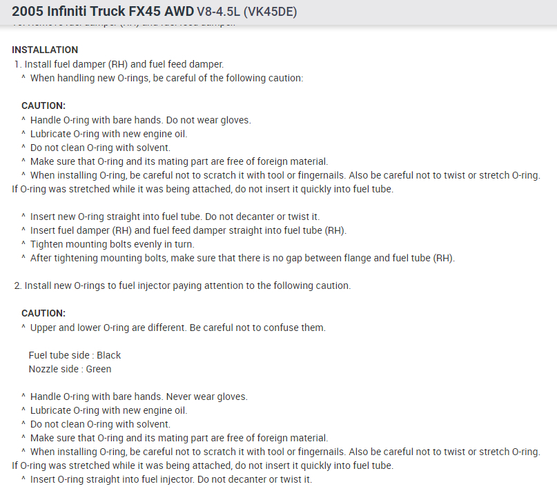

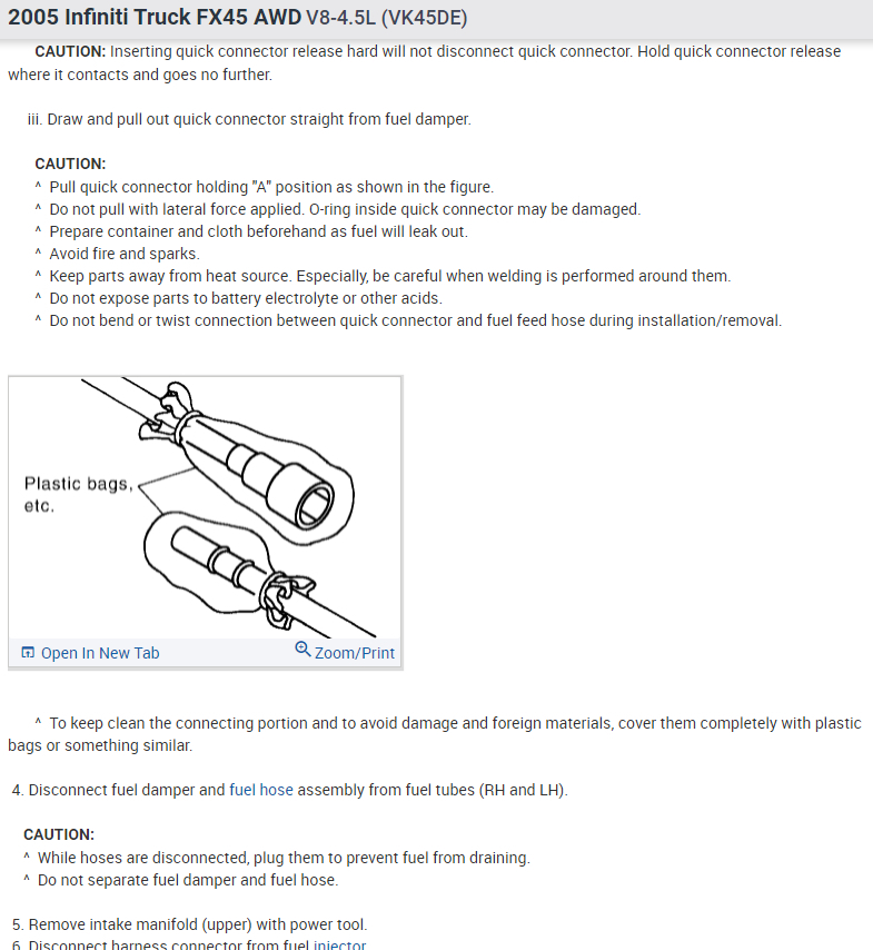

I have attached the fuel system diagrams under hood.
