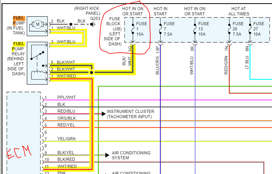

What is happening? Is there anything I can do to help? If it is a fuel-related issue, I attached a portion of the wiring schematic so that you have a reference. Poser from fuse 1 in the fuse box (left side of the dash) provides power to both the primary and secondary sides of the fuel pump relay. The ECM provides a ground path completing the circuit and power then travels to the pump.
See pic below.
