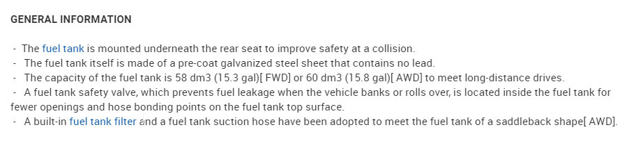

It appears your vehicle is equipped with a rollover valve and not an inertia switch.
