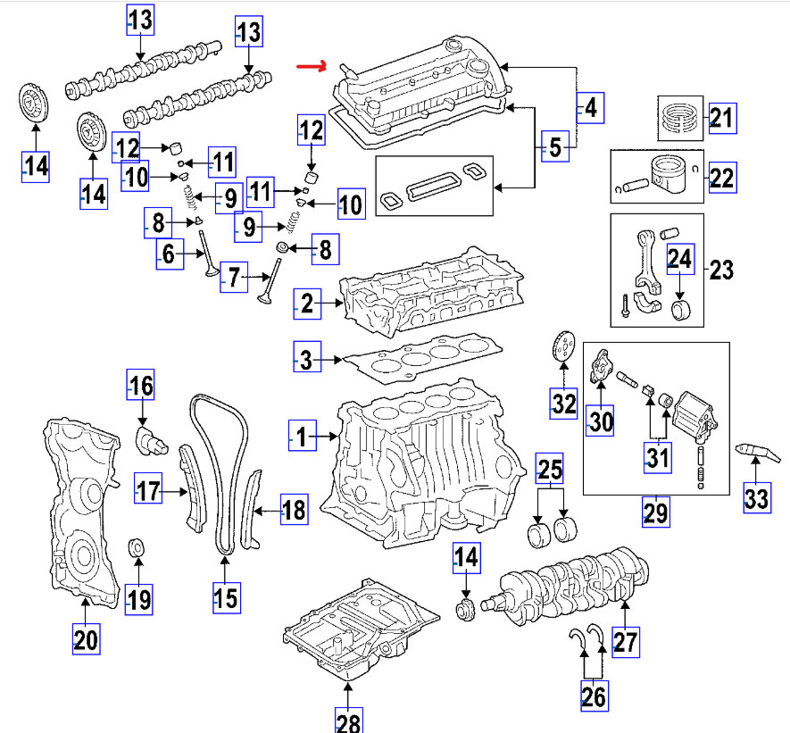

It sounds like you have piston ring issues, you might want to check the PCV valve to see if the spring is broken.
Here is a guide I found that can help as well:
https://www.2carpros.com/articles/blue-smoke-from-engines-exhaust
I would remove the spark plugs to look for one wet with oil to help confirm the issue. Here is the location of the PCV valve so you can check it out. Check out the images (below). Let us know how it goes.
