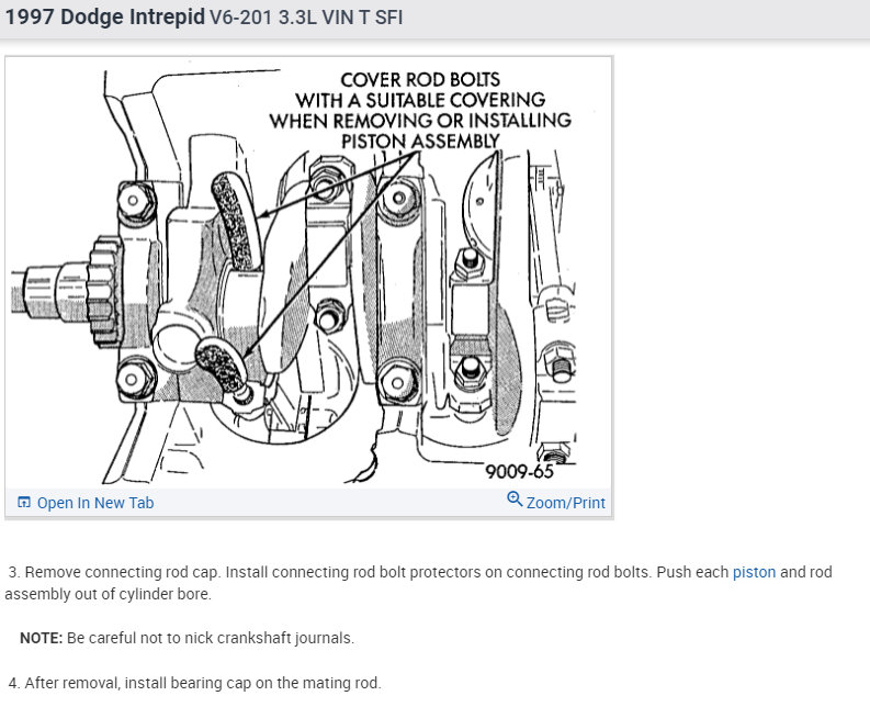

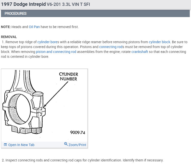

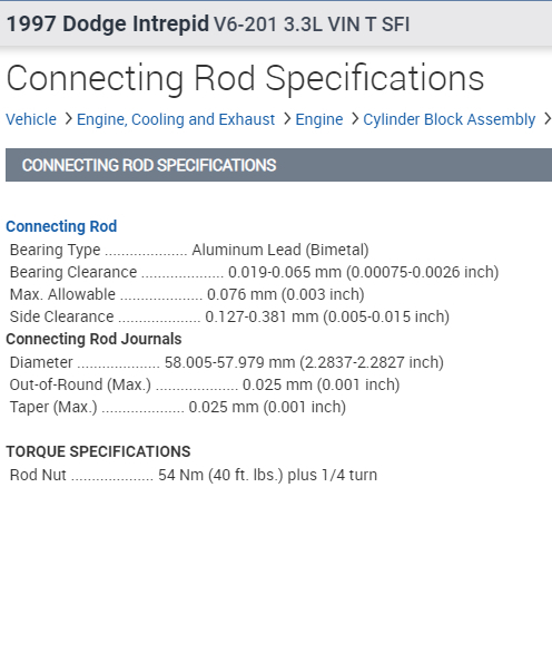

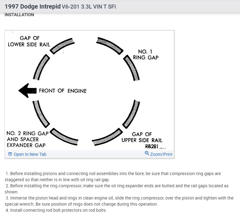

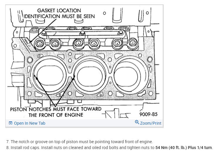

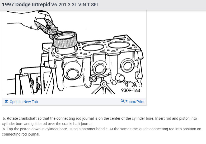

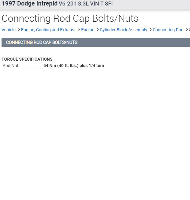

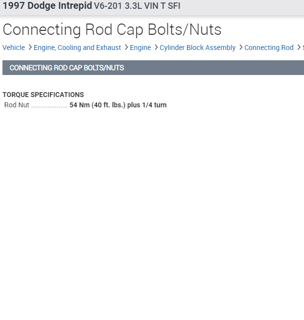

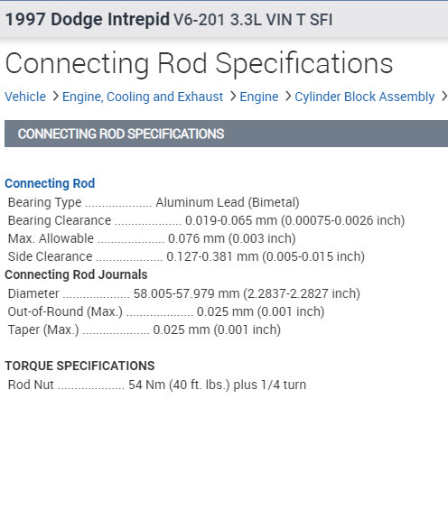

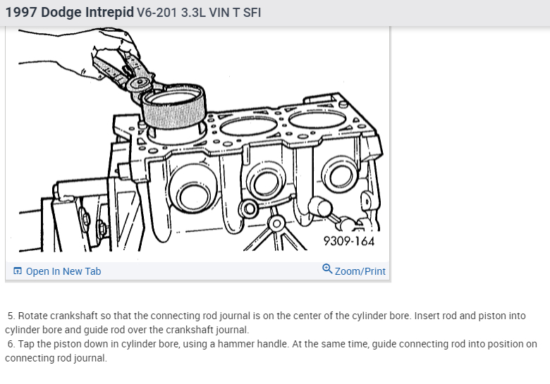

The torque specifications for the rod nut is 54 Nm (40 ft. lbs.) plus 1/4 turn.
