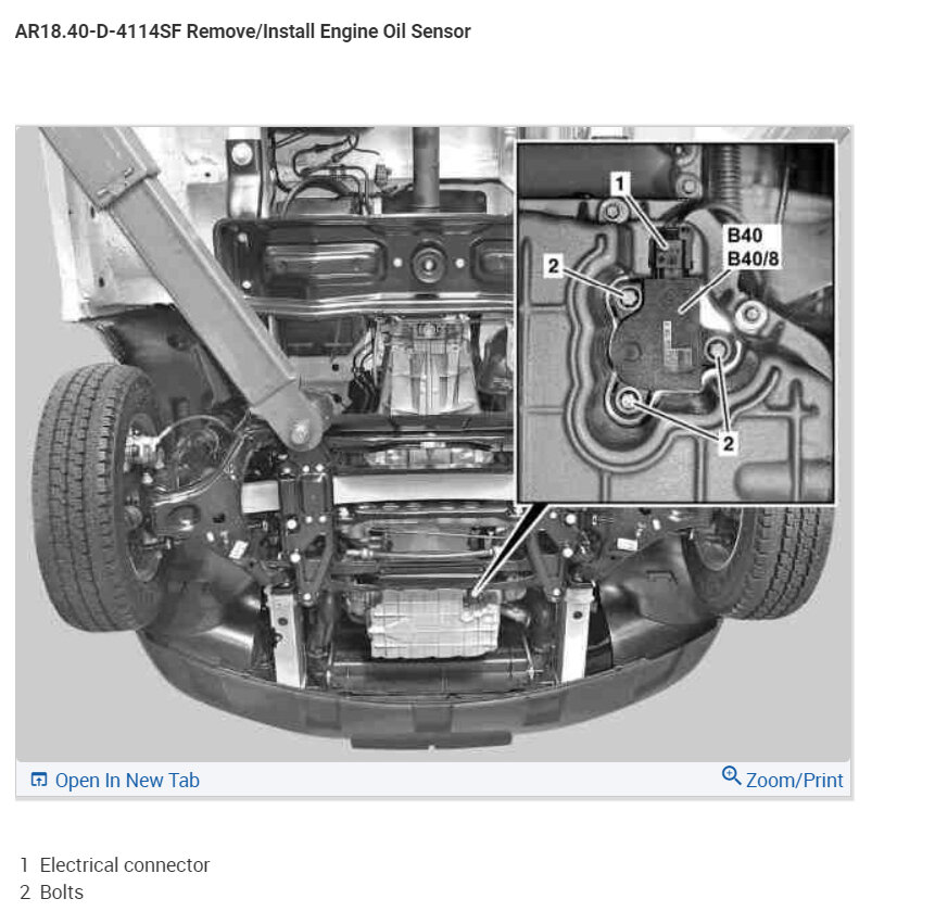

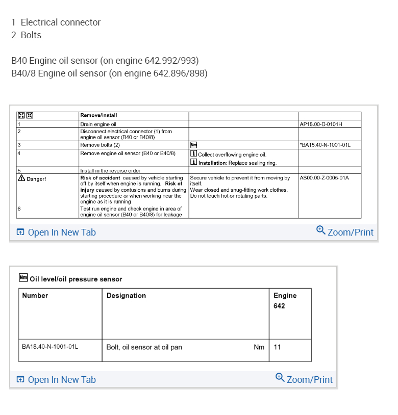

Yep, you are correct, the oil level sensor is faulty I would remove it and get a new unit and install it, that should fix the problem. Please check the images below to see the location and how to change it out.
