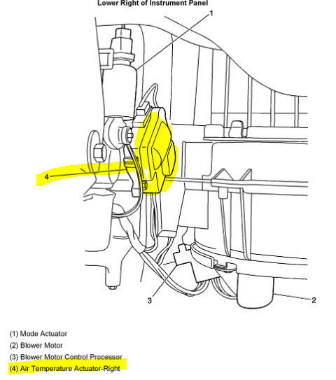

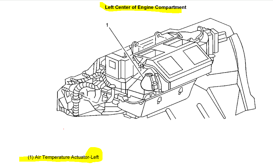

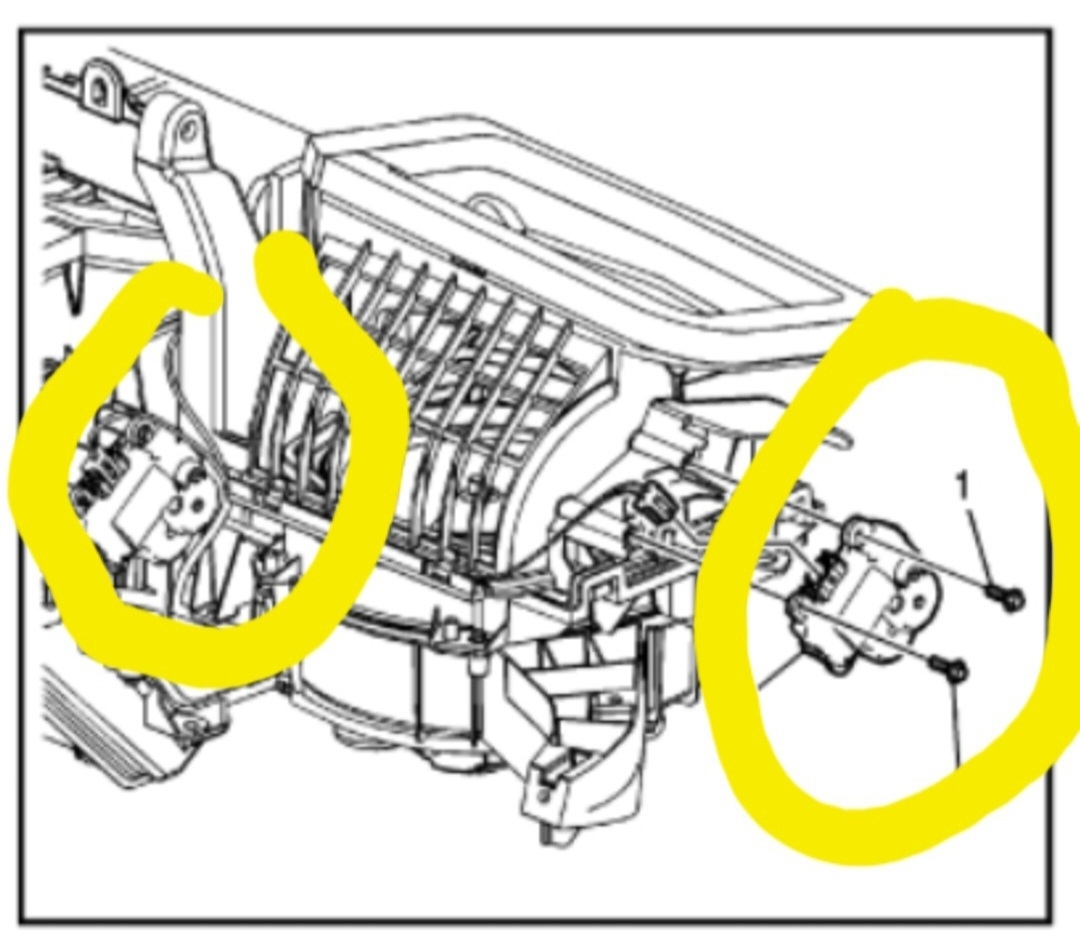

I bought 2 new door blend actuators for my car listed above.
AutoZone store indicated to me that this car has 2 door blend actuators in the parts page (2 per car). The actuators are the same AC Delco 15-74122.
My question, are the 2 actuators in my car located under the glove box?
