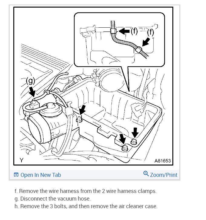

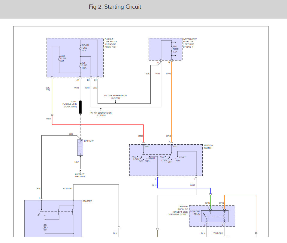

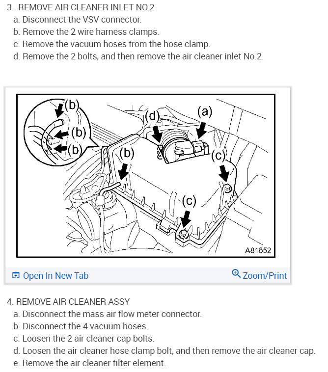

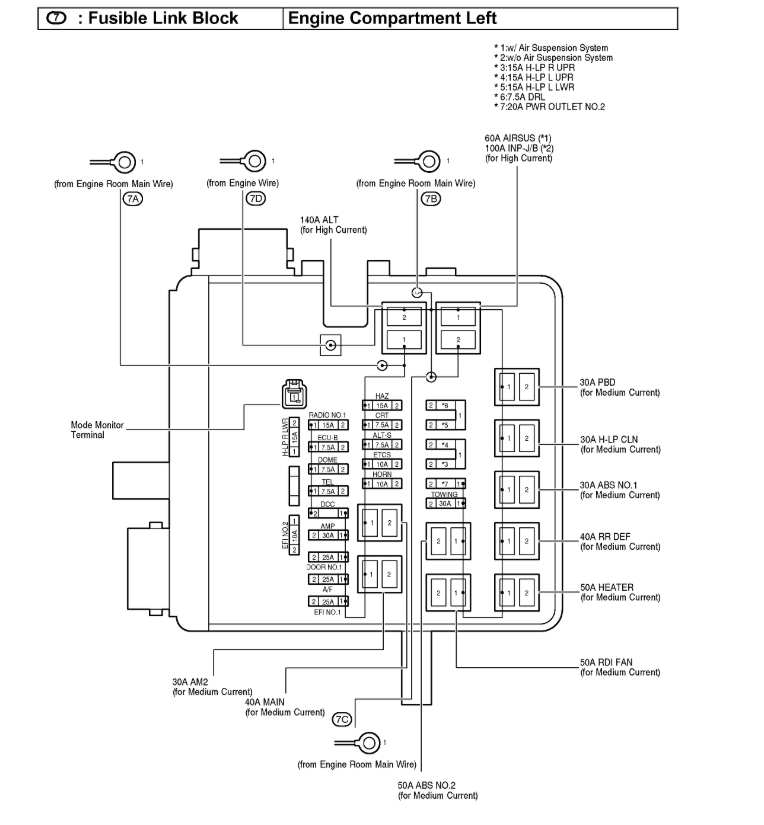

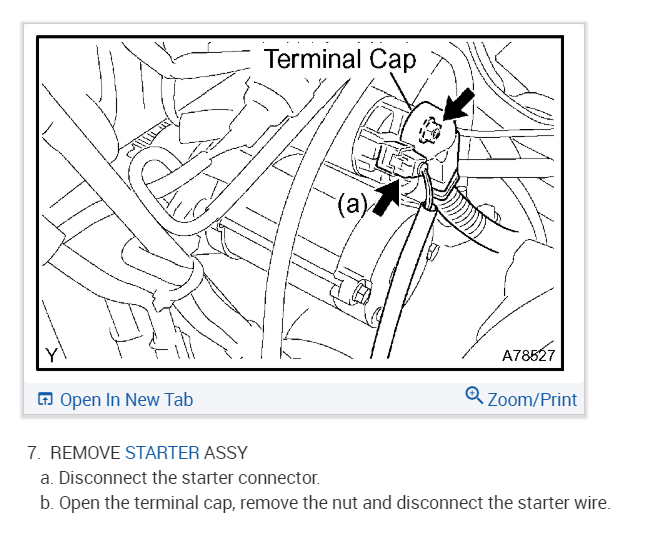

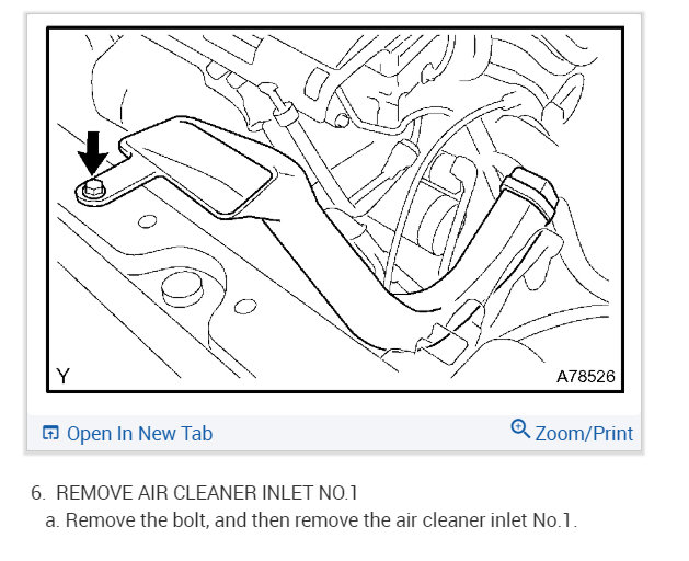

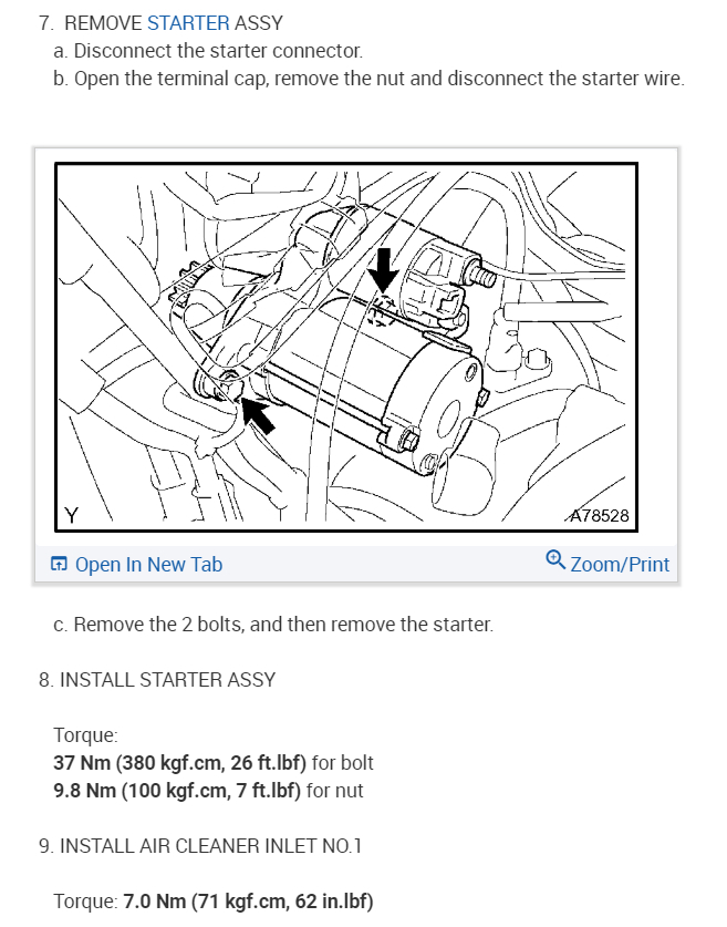

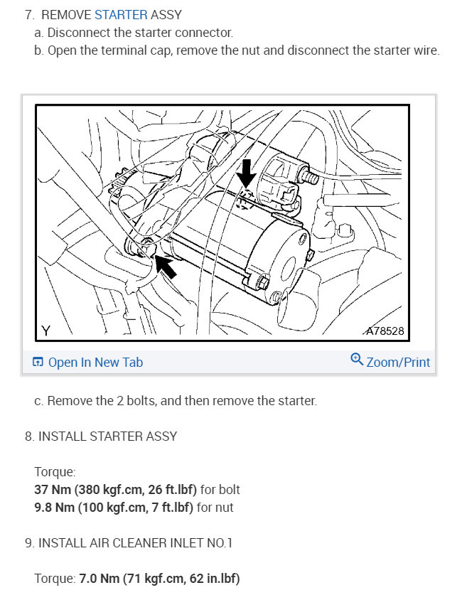

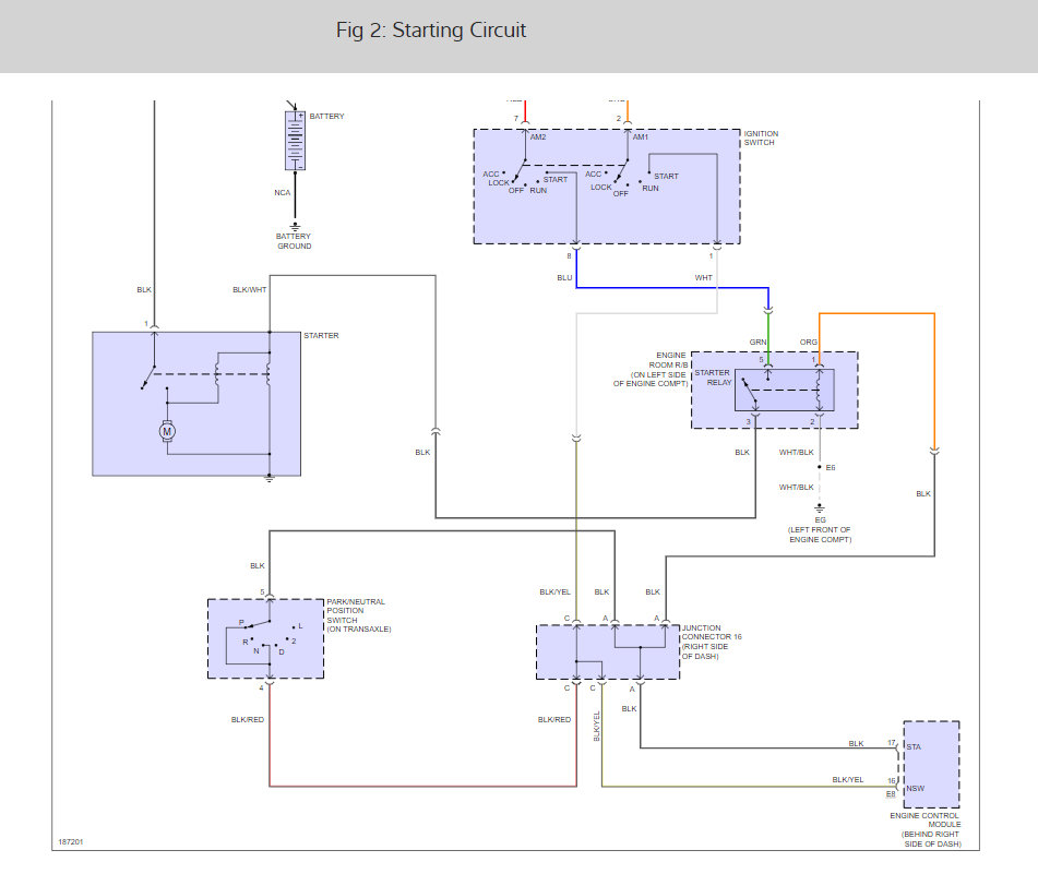

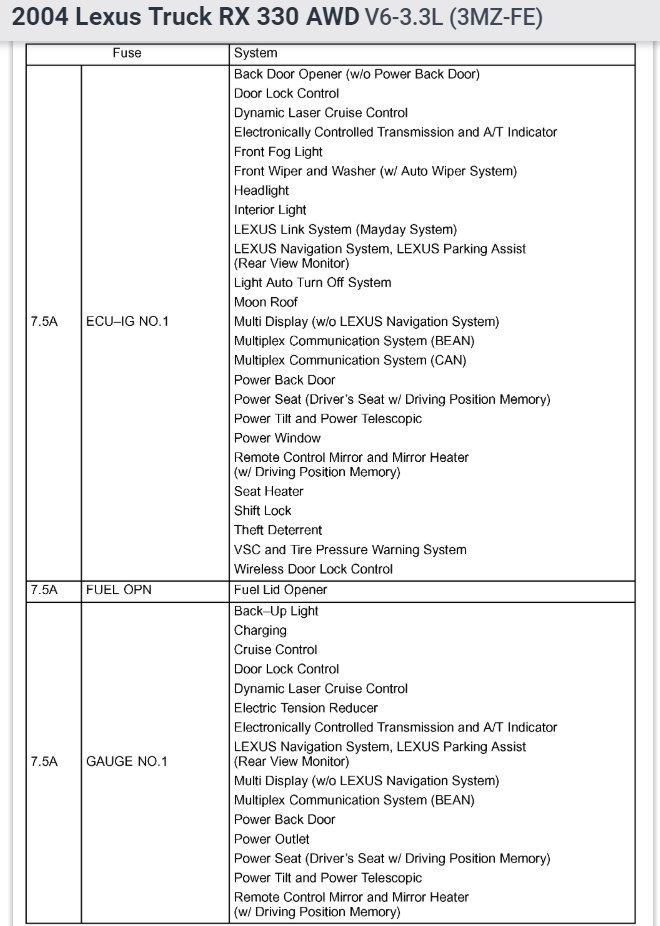

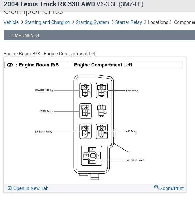

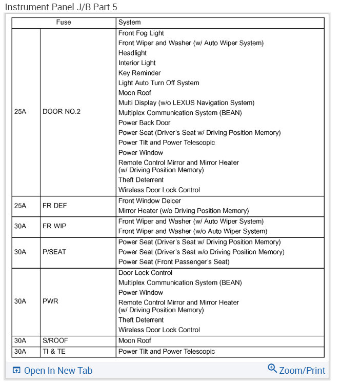

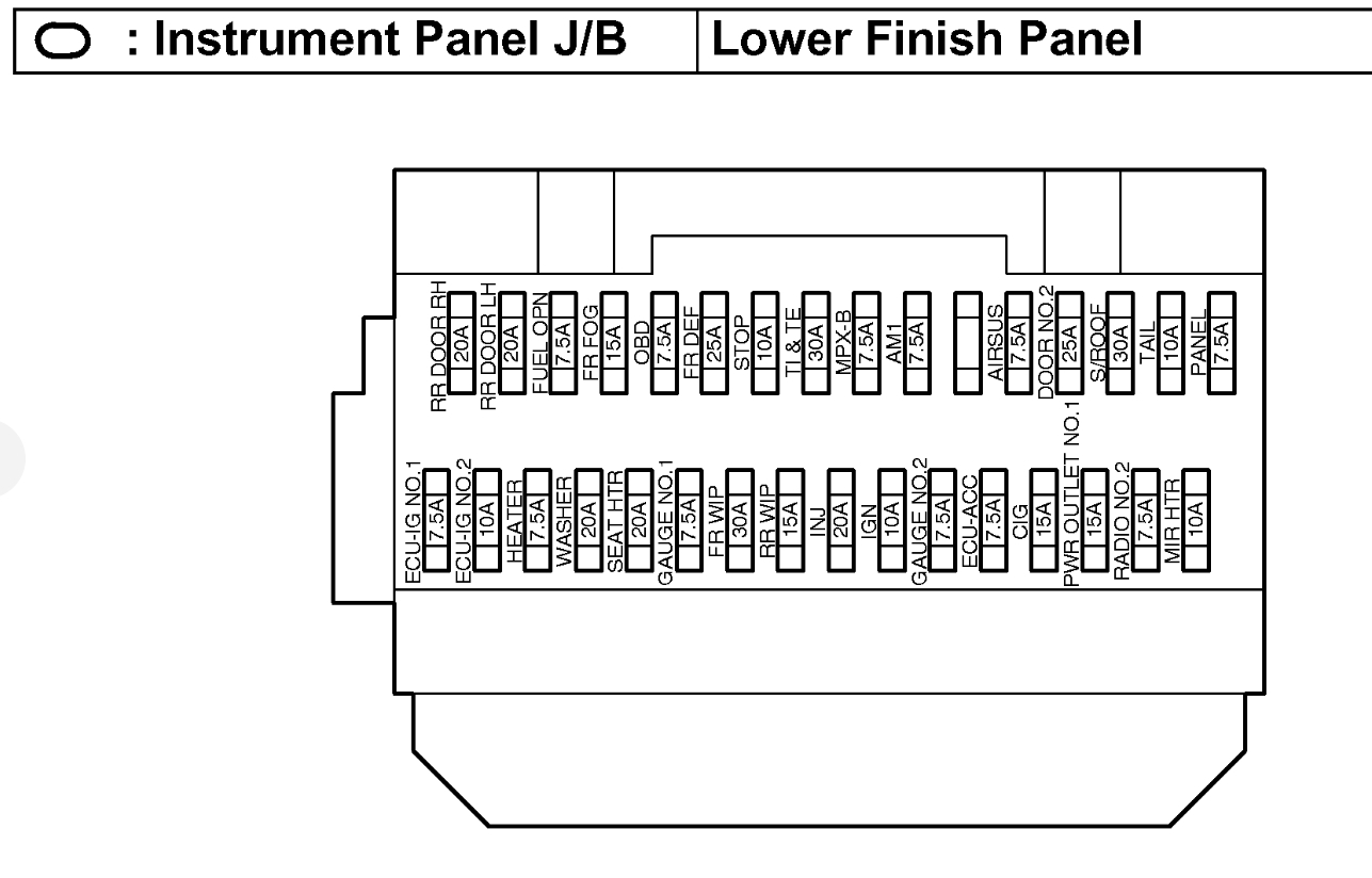

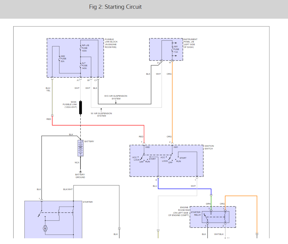

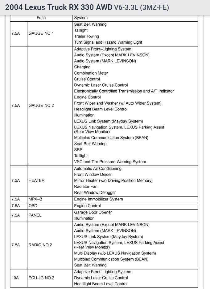

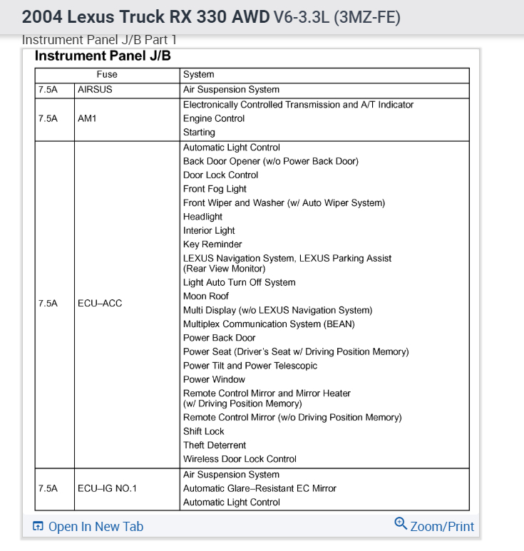

If the security light is not flashing the system is disabled and we have another issue like the starter or starter relay went out. but to be sure lets run down this guide. I have included the starter wiring diagrams and fuse and relay location so we can get it fixed. Lets check the fuses as well, # AM1 fuse in the fuse panel.
https://www.2carpros.com/articles/starter-not-working-repair
