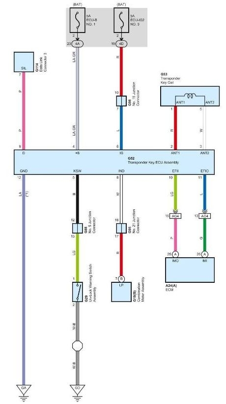

Hi, my problem is that i have no wiring diagrams for this vehicle and i want to find the Immobilizer location because my security signal is illuminated.
can someone help for wiring diagrams?
thanks
Dec 10, 2019 at 4:56 AM
STEVE W.
  • 15,113 POSTS
Being it is a 2019 and under warranty I would let the dealer deal with it as there are no parts available outside a dealership at this time. That said there is no separate immobilizer module in that vehicle, it is integrated into the transponder ECU as part of the transponder key system. The add-on pieces for it would be if it has the key-less entry and start or the contents alarm. I attached what little they show for the system but it is only the transponder assembly as the immobilizer gets the signal through it. If the light is on all the time and not flashing it is a fault in the system and not key related.

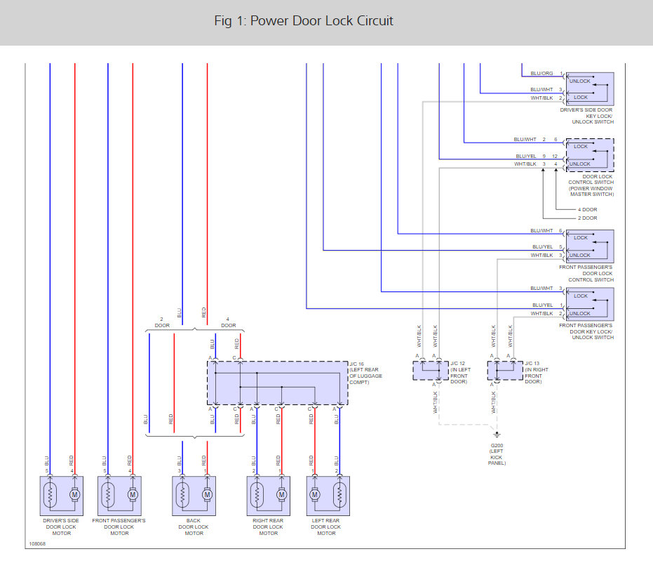

DEATHTARD
My alarm keeps going off. I have to tighten the positive battery terminal but when I do the alarm goes off so I have to get in the car push the valet switch. When it is off then push when I have the key turned now the valet switch broke from pushing it so much. How can I just disable my alarm?
Jul 30, 2020 at 1:55 PM (Merged)
PENGUIN88
It sounds like you have a micro switch in the drivers door lock that has gone bad, because that is what happened to my car. I got a new latch and installed it the problem went away. Cost me $67.00 for the part. FYI
Here are wiring diagrams so you can see how the system works. (Below)
