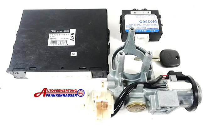

Hi, i have a friend,she broke down on a parking outside a market. her ignition would not turn. so she knew an electrician and call him over. unfortunately the electrician i know him and he has no knowledge in Immobilizer system.so he broke the electric motor thinking that ignition will turn and car will start. No luck ignition turns, no starting.so now electrician guy advises the lady to contact someone whose into car electronics and Immobilizer. guy comes read dump from ECU, read dump from Immobilizer box (93c56 ECU. 93lc66 Immobilizer box),well key was good ,he made another one ,but car will not start,guys leave ECU dump with ffff for both boxes.now she contacts me, she forgot i was in car electronics (shes old). Manage to get back 2 dumps from forum with 4c new code,write it down with zedfull.,still no start. scan the car P1601,was there when she broke down.i Can comm with ecu ,live data working, but no communication with Immobilizer box. i can get second Immobilizer box, and make new key. ignition lock not avail , will car start even the lock hasn't got the motor. does it work like merc with hashes,i doubt so is 4c tp.w/o motor will car start -2nd Immobilizer box,new key, new dump ECU. Your advice much appreciated, as she is old and lonely i need to help her. please need advice.Thanks
