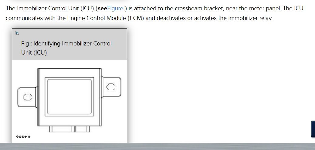

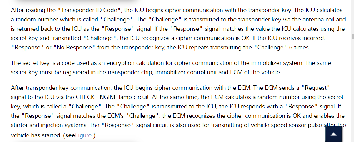

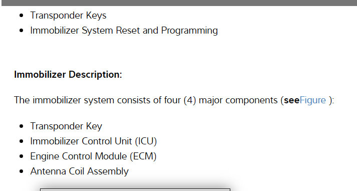

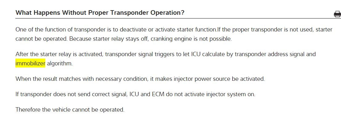

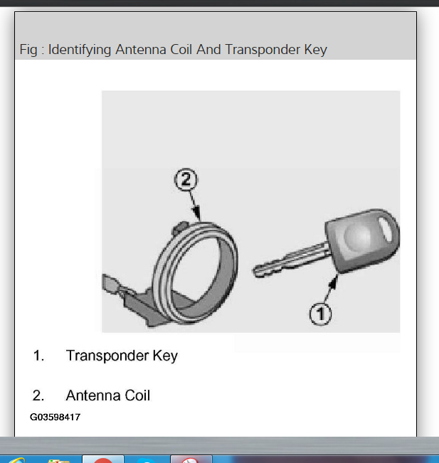

Hi Gloria,

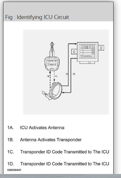

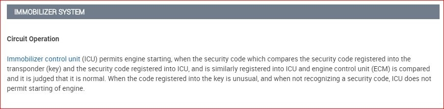

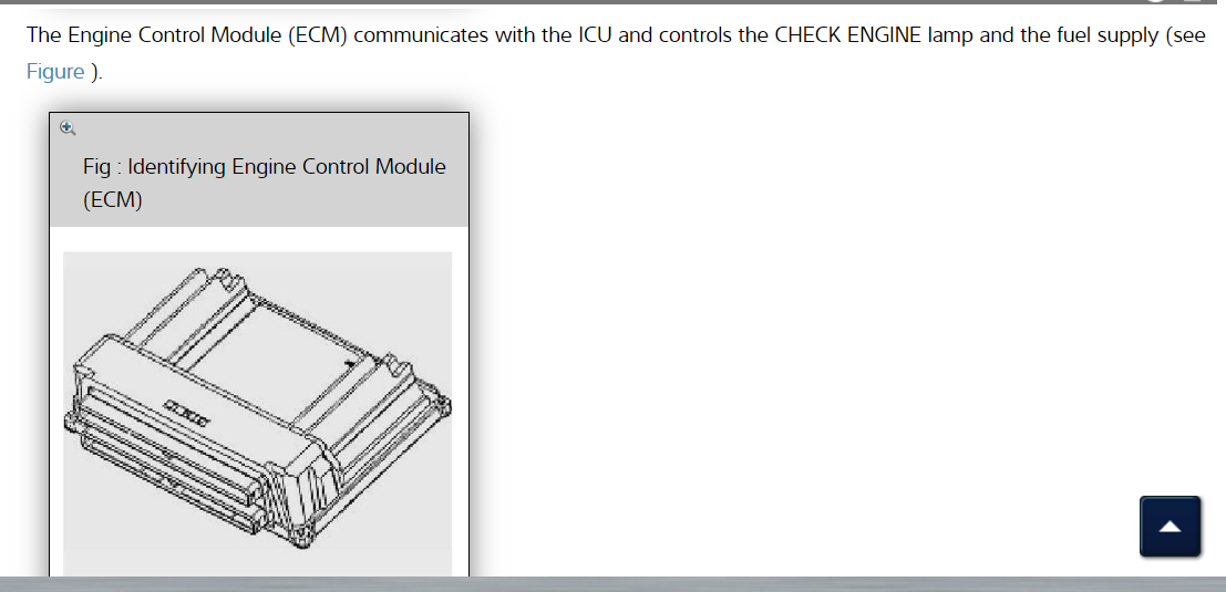

Unfortunately, these systems are designed purposefully to avoid being bypassed so that the car cannot be stolen.

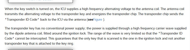

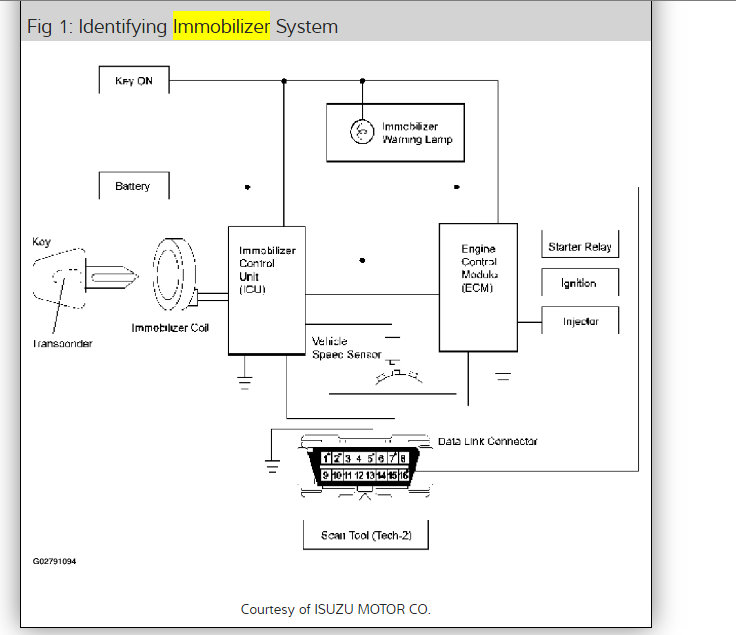

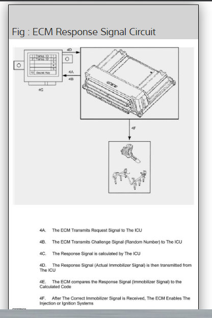

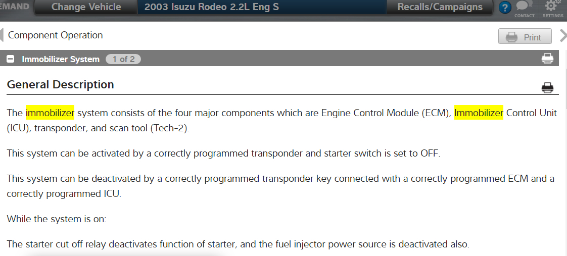

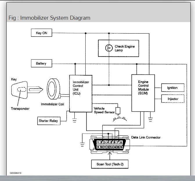

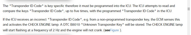

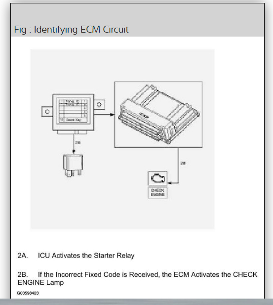

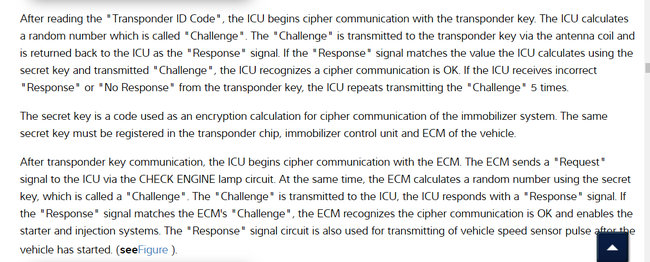

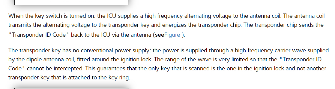

I attached a copy of how it works and as you can see, your key needs to send a coded message to the ICU which sends it to the ECM and they all agree that the key is a good key. Once this happens, the ECM sends all the needed messages to start the vehicle. Without this coded message, there is not way to bypass it.
Sorry. Let me know if you have further questions or if I can help figure out what the issue is. If you want me to, then we need to retrieve the codes in the system. That will tell us if there is an issue with the key or one of the modules.

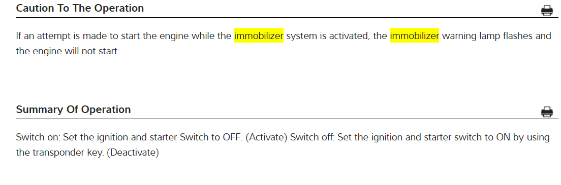

Need to bypass immobilizer? Light flashes.

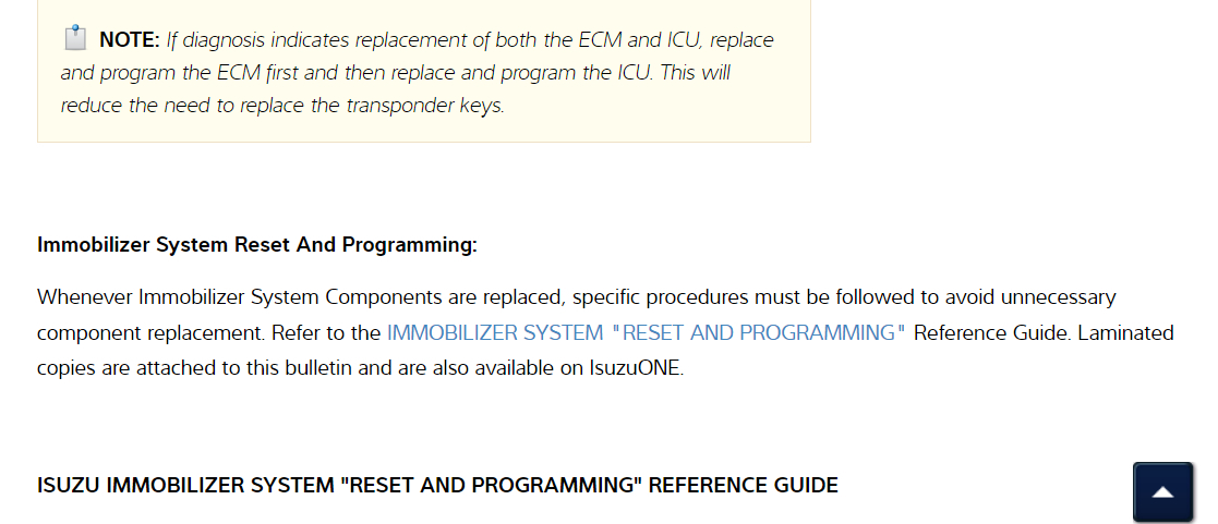

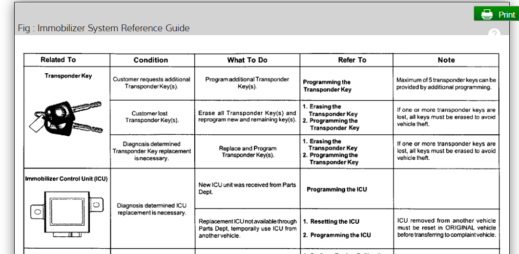

SCGRANTURISMO
  • 4,897 POSTS

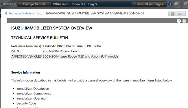

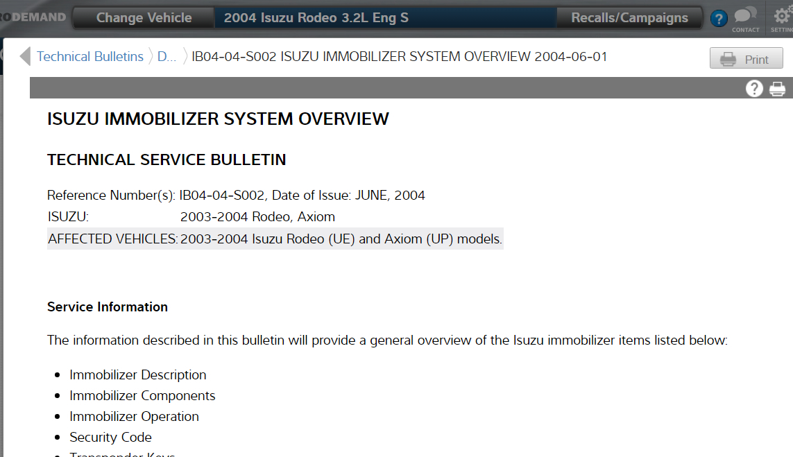

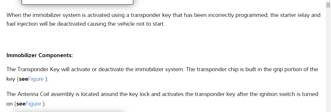

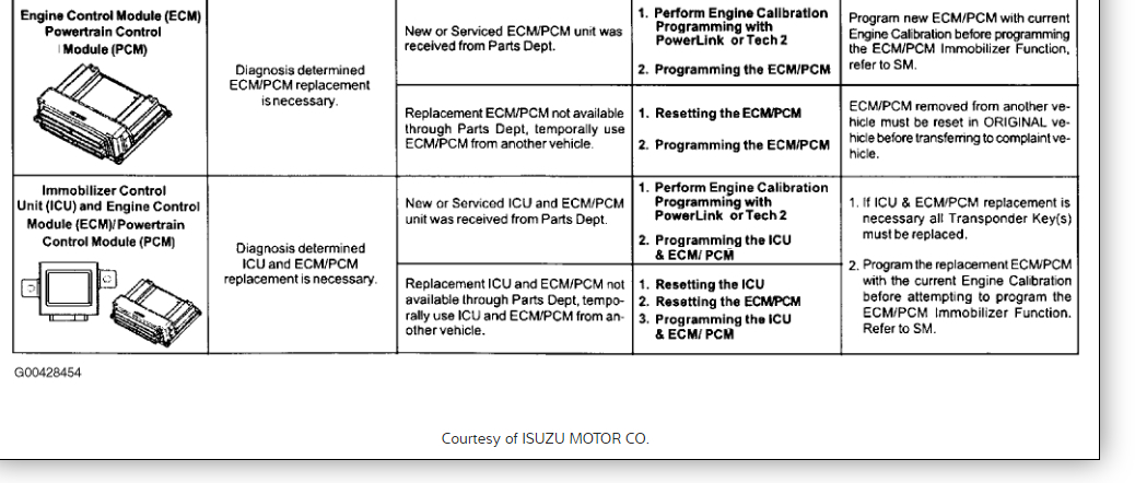

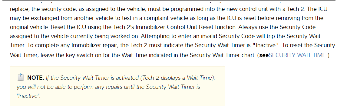

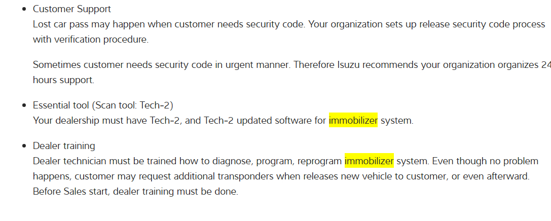

I have included for you in the diagrams below the Isuzu Factory Technical Service Bulletin (TSB) for resetting the Immobilizer System. Please go through it and get back to us with what you decide to do.
Thanks,
Alex

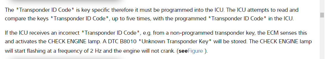

When I turn my key the engine sounds as if it is going to start and then it turns off and the immobilizer light begins to blink. I took out the battery thinking that it was low, but it is not. I had to get a key made through the dealer, but the alarm switch did not come with it. They told me I would be able to use this key until the alarm came. They also told me that this 2004 rodeo does not have a chip in the key, so I should not have any problems with copies. How can I start my engine and turn off my immobilizer light?

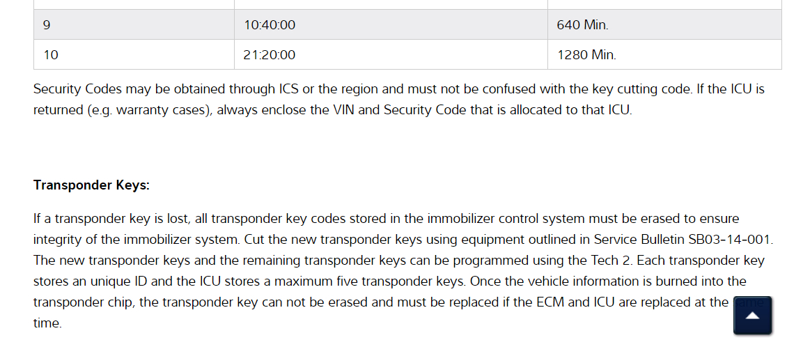

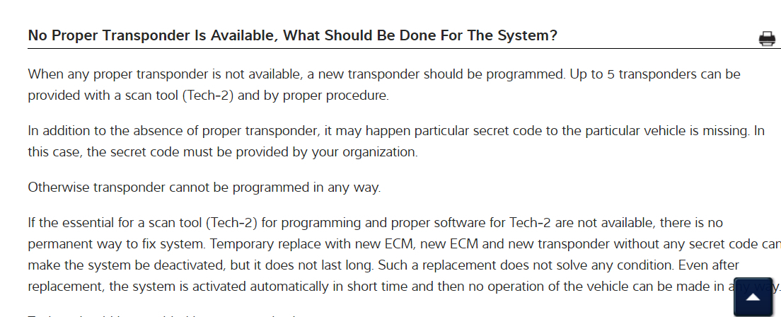

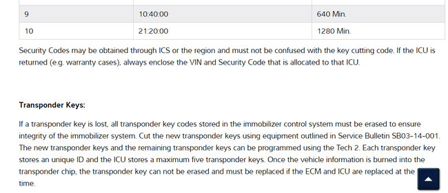

Key is lost as is key fob. ignition is unlocked, switch is accessible. Can I bypass immobilizer as vehicle has to be driven to workshop?
Apr 13, 2021 at 10:44 AM (Merged)
SCGRANTURISMO
  • 4,897 POSTS

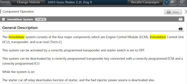

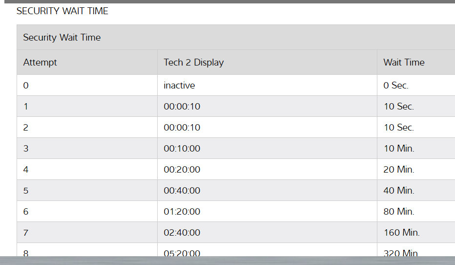

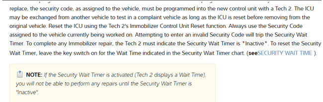

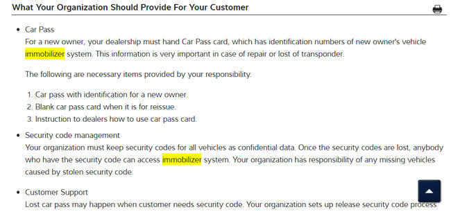

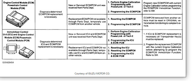

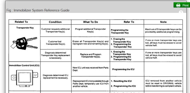

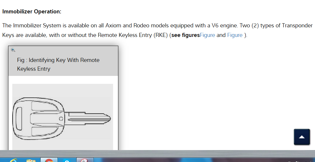

In the diagrams down below I have included all the information for your vehicle about the immobilizer system. If you have lost your immobilizer transponder ignition key, you should contact your local dealership for support. Please go through this guide and get back to us with what you are able to find out.
Thanks,
Alex

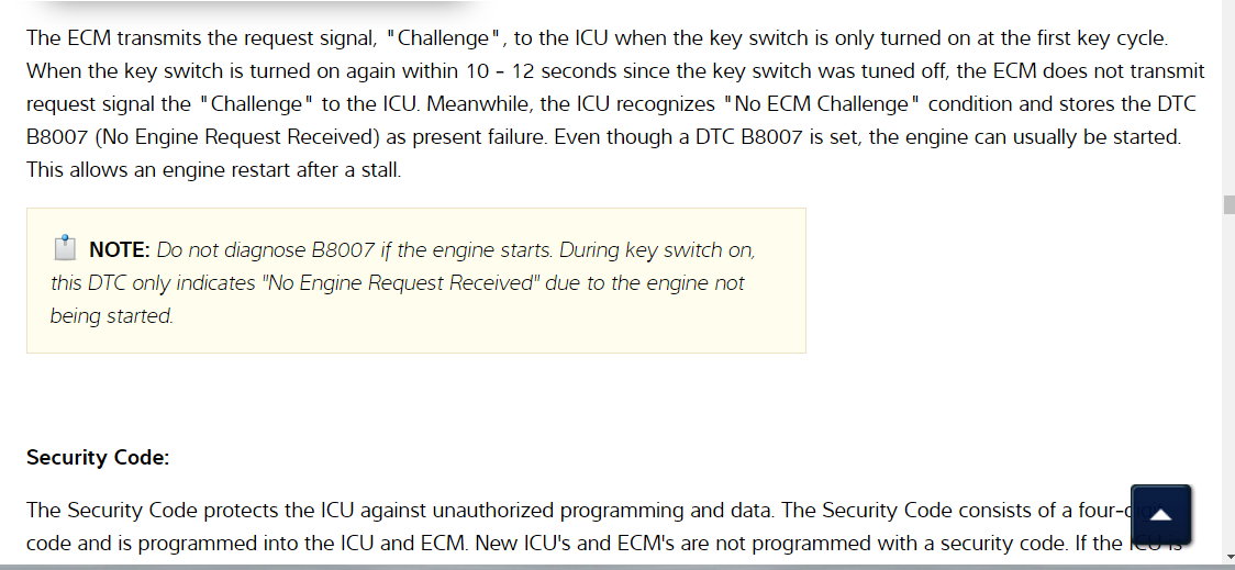

try a security system reset see pic and link one should get it going if not that then scan for codes . if battery was dirty/replaced sets the security off.
https://www.2carpros.com/articles/how-to-reset-a-security-system
Check out the diagrams (Below). Please let us know what you find.
