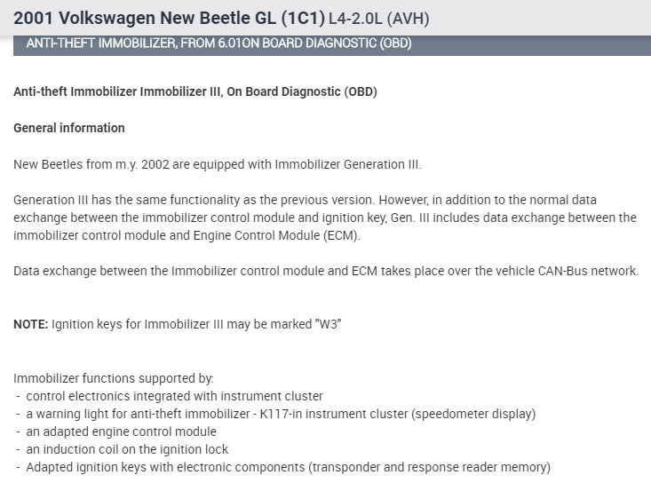

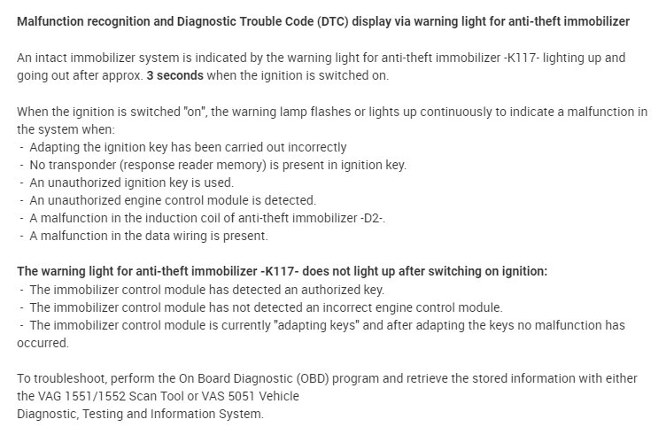

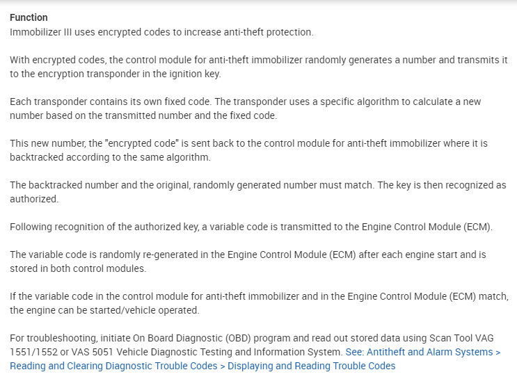

It will have to be programmed using the Volkswagen VAG tool. I've attached a few pictures below showing its description.Hope this helps and thanks for using 2CarPros.
